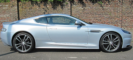

Don't need another blue ute on the road. Common as
Ammo said no green or shade of green.
Maybe this colour
Maybe this colour
