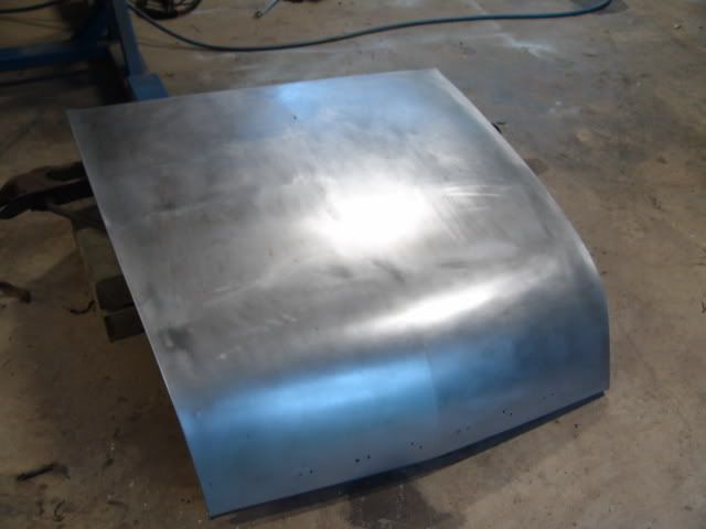

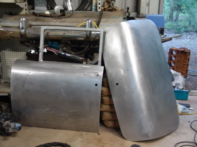

Bare metal respray ...... thats a good idea :roll: :lol: Get the guards etc done over the weekend and then primed and preped for the colour. Have some work to finish on the shell, should be right for paint in 2 weeks. Hopefully have the car all painted in 4 - 6 weeks and then start the real fun bit of putting it all back together again and see what evolves.
V8EK4us
Posts: 1541
Location: Mildura - Vic
Post by V8EK4us »
Update ....... no pics :oops:

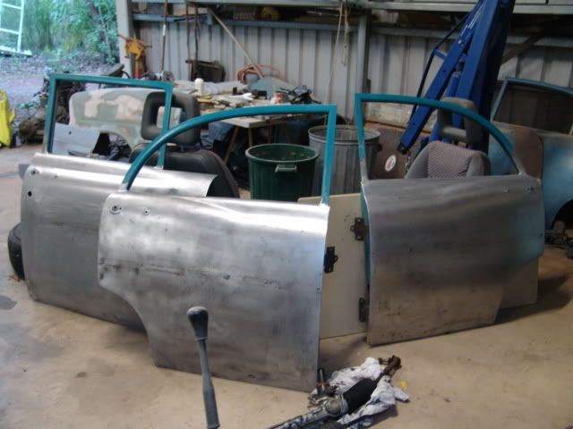

Bolt on panels are sand blastered (window frames and internals only to avoid distortion of the main skins which were done by hand) and primed. Car is back on its side getting the finishing touches underneath before it's appointment with the spray booth. I have fitted an LX Torana frontend :shock: :shock: (yep, I changed my mind...again :roll: ), had brakes made to reduce track by 32mm (Hopper Stoppers) and ordered the motor (at last!). Motor setup has changed since original plan and will be all under the bonnet ("semi" sleeper!).

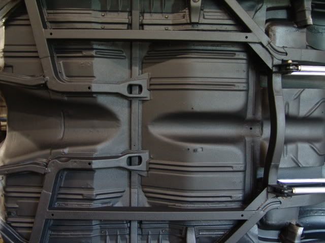

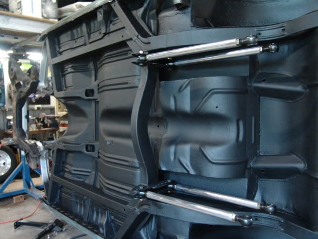

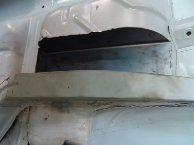

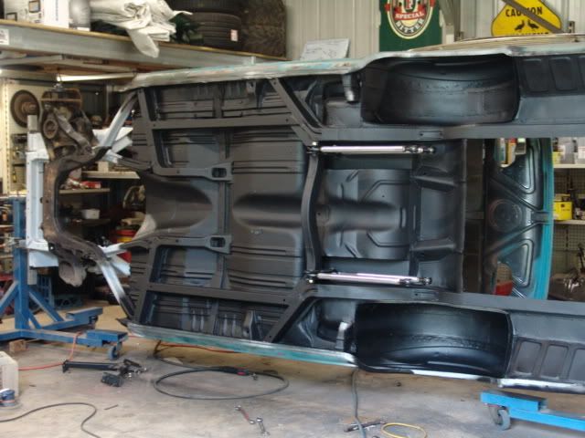

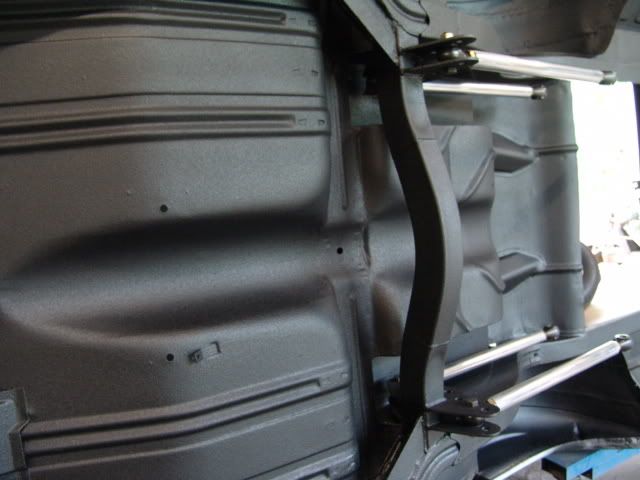

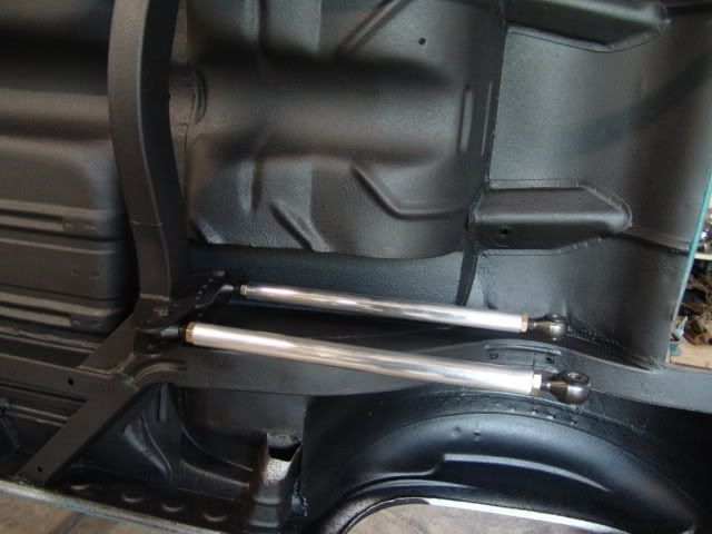

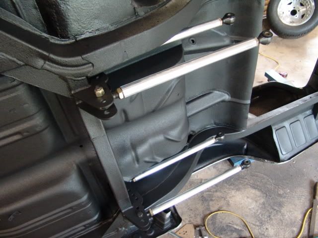

Finally got the 4 link recesses made and fitted, ended up making the recesses wider so I can adjust the "all important" top-front rod end position for street or strip without having to remove the back seat and and inspection cover (previous idea - quickly trashed!). Also cut some 32mm ally tube, polished it and slid it over the chrome moly 4 link tubes.....gives it a better look I think :wink: .
Applied some deadner to the under body (I still have some things to do but it is very humid at the mo' and I wanted to protect the work I have done so far), now I can stand back with a Jack's & coke and see that I have got somewhere :lol: :lol: .

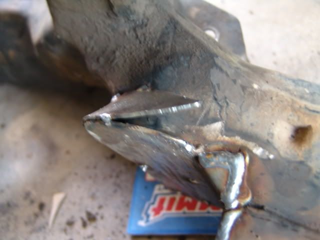

Torana frontend is in, still have to make the additional subframe chassis section that will now incorporate the mounting points for the rear of the torana "K" frame. The 350 can now sit very low in the engine bay which is a bonus for what I have planned :wink: .
A pick of the torana K frame (stock):
Notched and plated for EK mounts and plates tacked on:
The EK mounts are tacked on .... NOTE: the forward part of the EK mount still requires a brace (as per it's fitment on the EK), I will post a pick of this brace later:

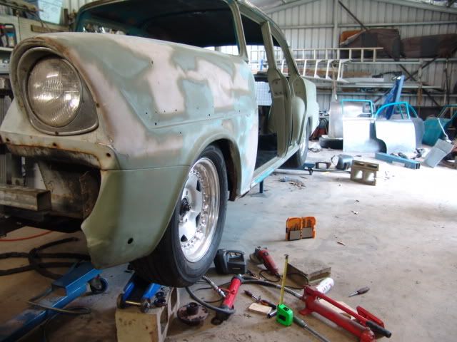

Torana frontend in place (Pre-fit), this is not the guard going on the car :oops: : It is of the "flash kit" donor car. As can be seen by the "porta power" on the floor I pumped the guard about 10mm (the reason for using the "old guard") which has given amble clearance even at the low ride height. I do however have another trick up my sleeve that will make it even better :wink:
4 Link recesses that I made up out of 1.6mm black steel sheet:
4 Link recesses in place for test fit prior to welding:
Bit of deadner splashed around and polished (not finish polished) ally tubes over 4 link bars:

Post by mrs ratbox »
hate to pik yor brains, but in the pick with the wheel on where do you have the suspension set on the bump stops or down so it would have travel and what stub axle and disc rotor is on it
so pissed too already have one front and could have bought another in bits on the weekend cheap and didn't really think about it till i left the swap

ratbox wrote:hate to pik yor brains, but in the pick with the wheel on where do you have the suspension set on the bump stops or down so it would have travel and what stub axle and disc rotor is on it
Mick, as per height in pic there is 45mm left until the bump stop will contact. Stub - LX torrie, Disc - P76 supplied and modified by Hopper Stoppers with HQ caliper and adapter.
