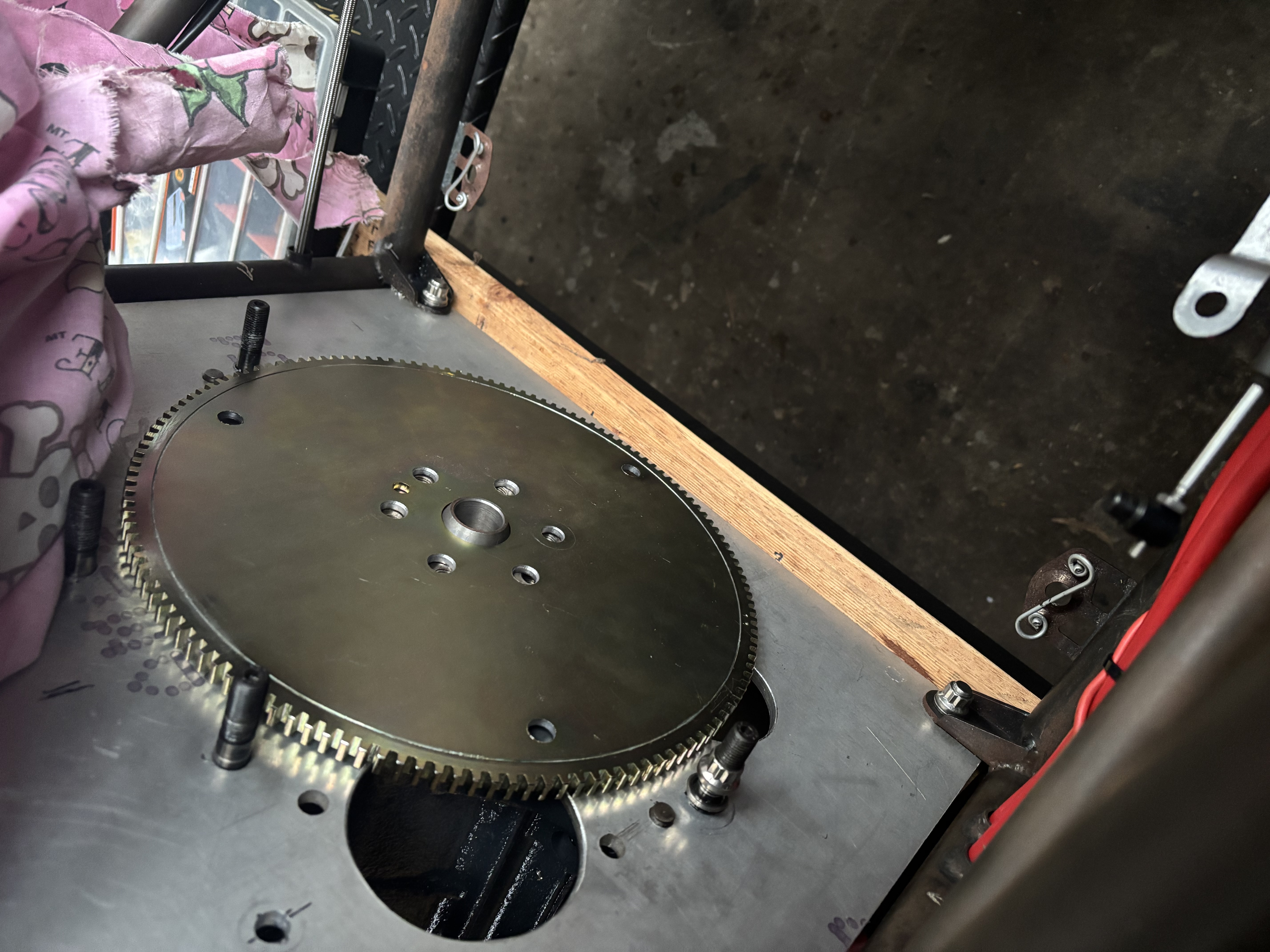

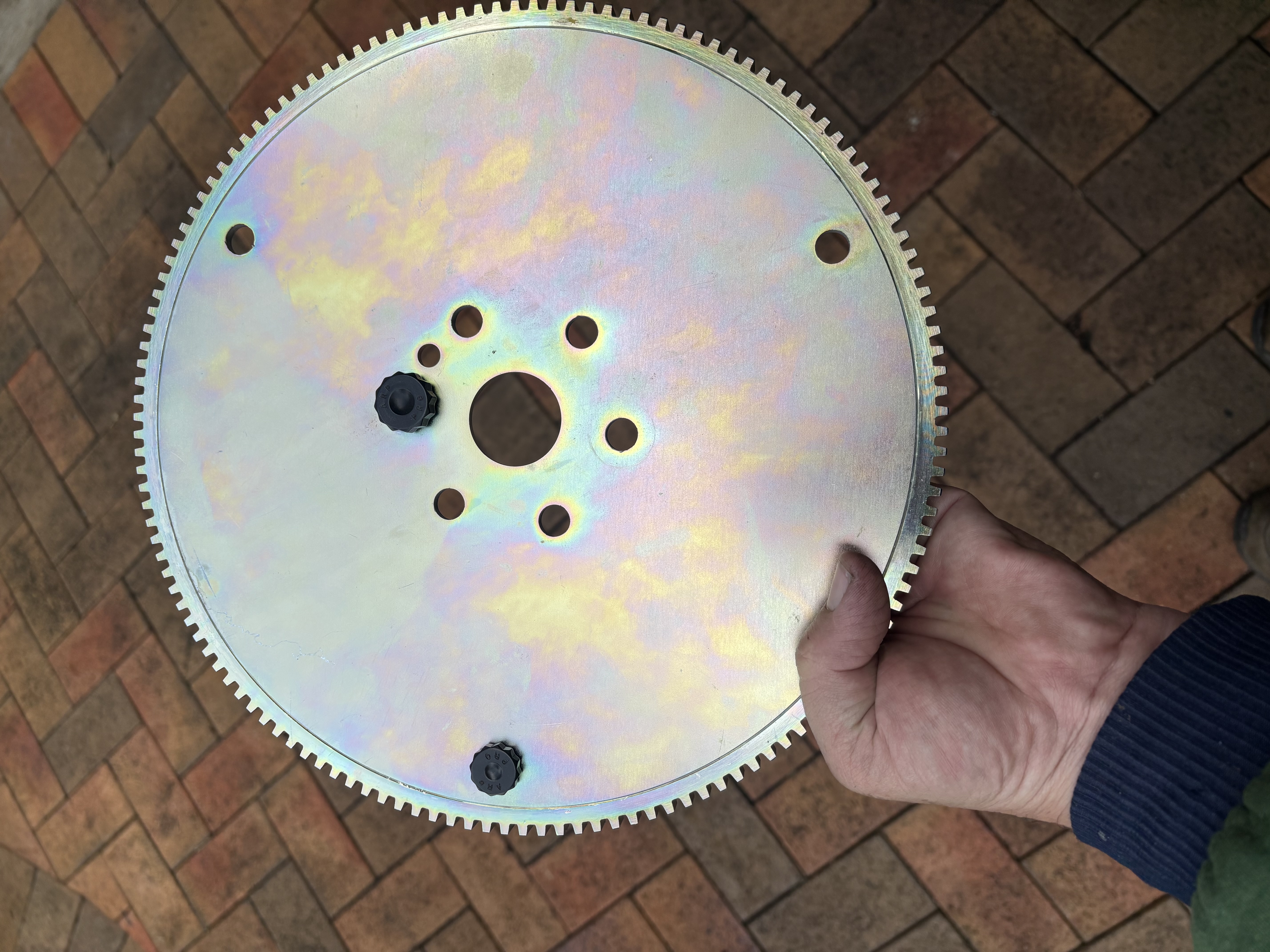

Spigot bush showed up, so got ready to put flexplate on. Bolts are ARP 200-2902,7/16 UNF with a fancy big head on them. Checked the instructions, and they get red loctite, a smear of lubricant under the head and leaned on to 85ftlb. The instructions also have a warning to make sure the flexplate holes are chamfered as the bolt head has a radius. Checked, and they are right. Time to bevel the holes, bevan.
Interesting that their torque converter bolts (shown in the wrong side of the flexplate below) are the same thread but smaller head and not chamfered.

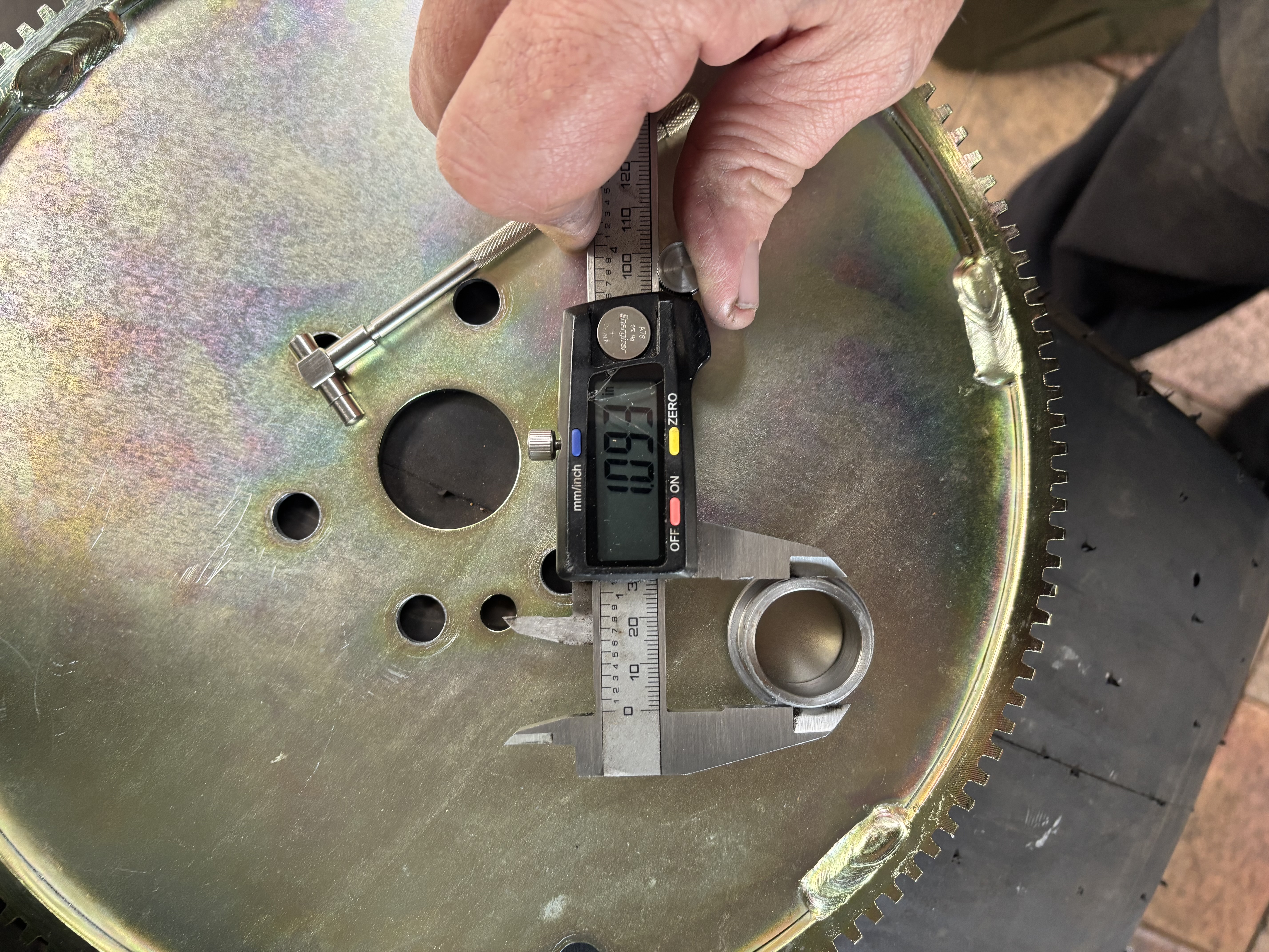

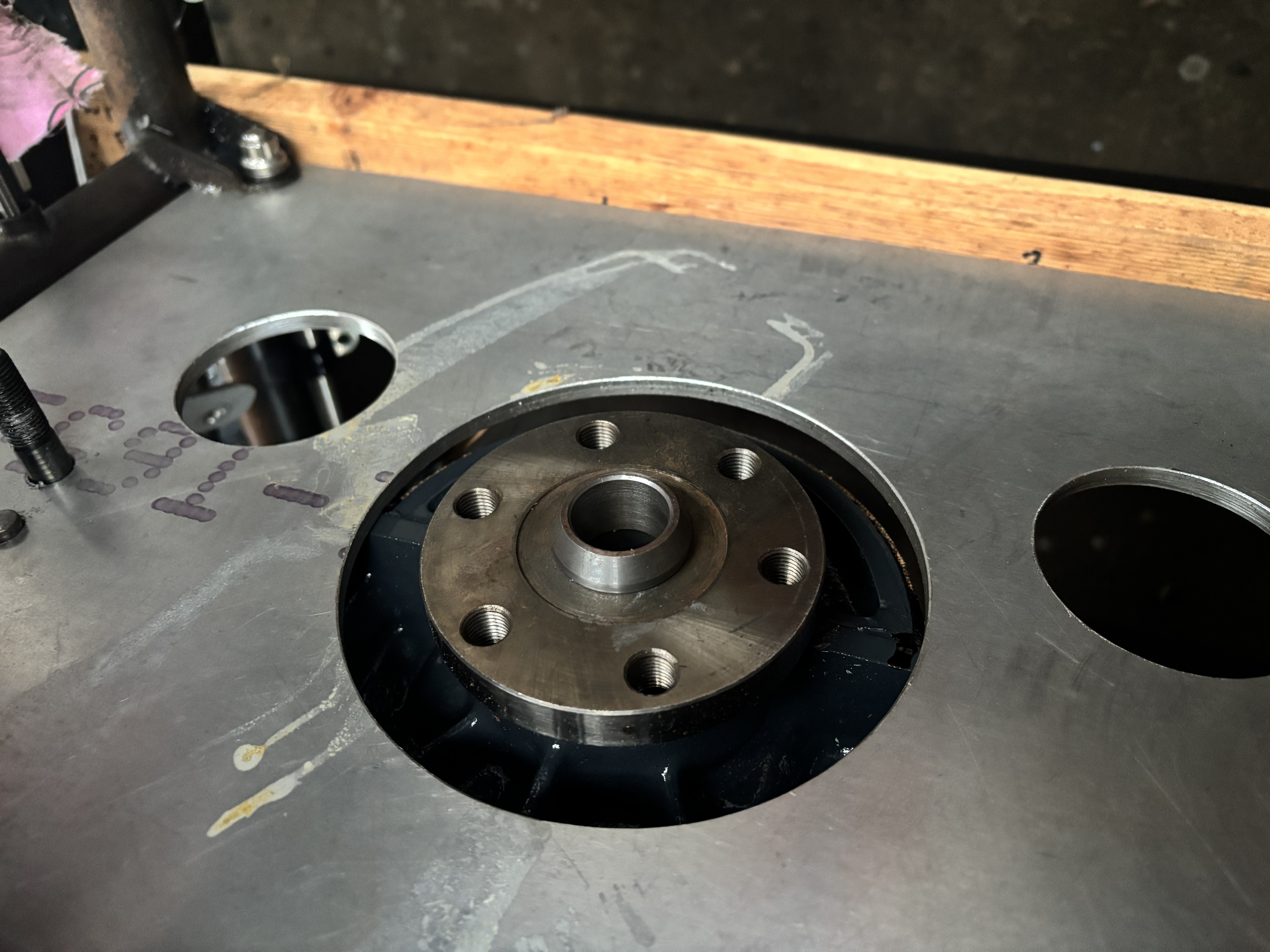

Checked the spigot bush on the flexplate, all good. Greased the spigot and went to fit into the crank, and no joy. Murphy struck again. Spigot is 1.093” according to my well-abused verniers. Crank bore is somewhere between 1.077” and 1.084”.
I don’t trust my bore gauge, as it lost its little spring years ago. Will need to buy another one to measure the crank, then get the spigot machined to suit. Anyone interested in a small lathe job please?

Wondered if I got a dodgy spigot bush, or if the crank is not right (hoping the bush is crook so I can get another off the shelf). Red motor crank bore is not an easy number to find, but Dellow reckon that their bushes are 27.8mm OD:
https://dellowconversions.com.au/produc ... ot-bush-2/
That converts to 1.094" in old money... my AussieSpeed spigot bush is 1.093". Looks like the crank is the issue. Not keen on removing the crank, so skimming down the bush is the way to go.

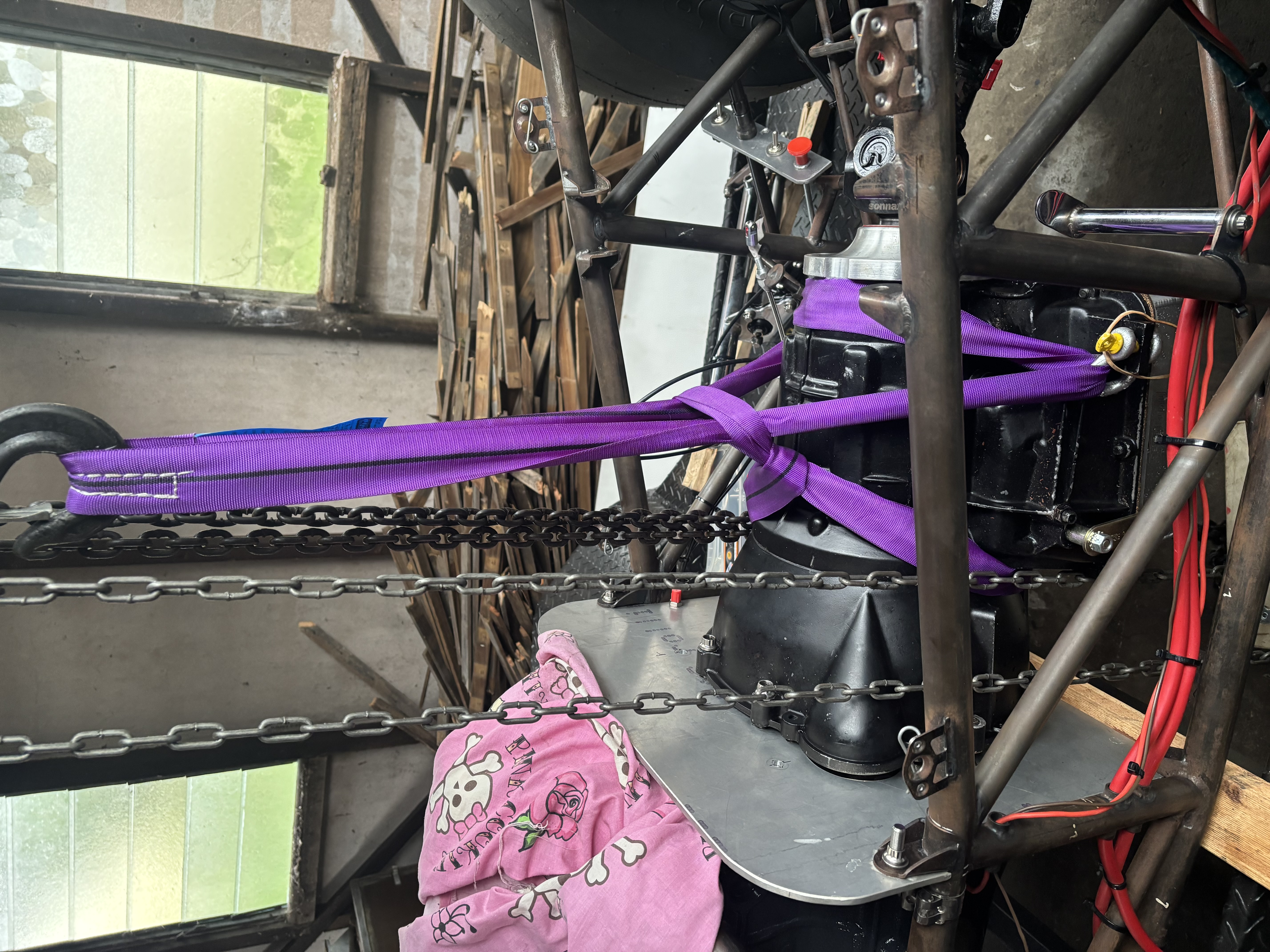

… and this boys and girls is why Bongo is not allowed to do rigging in public places 🤪

With the shed stuff out, there is room to work on a car. The sides and inside of my house look like a hoarders though until the new shed is built. Timber is 30 year old lattice that was supporting a bougainvillea. It was nice and kept the carport feeling “green” but climbing on the carport roof to trim it once a fortnight is getting riskier the older I get.
Torque converter on, then spun and “clunked” back to engage the pump. Box on and wiggled onto the studs. No excess force, bellhousing bolts finger tight… but now converter does not want to spin. Hard to see what’s going on as the engine plate blocks almost all the view into the bellhousing. Mindful that flexplate, engine plate, converter and box are all bespoke. They were designed for each other (e.g Dominator milled the converter pads to allow for engine plate) but wary that it might not come together as planned.
Wiggle box back a bit on longer studs, and I can feel the gap between the converter pads and the flexplate with a feeler gauge. Confirm that gap with Number One son’s fancy bore scope. Had thought the converter had not clunked back far enough and was hitting the flexplate but not so given the pad gap.
The only thing touching can be the converter pilot inside the spigot bush. Had checked that on the floor, and the two parts mate OK. Get Number One Son to lift the back of the box, and the converter comes free. Methinks that with no rear mount the box droops until the bellhousing bolts are hard home. Drooping box puts the converter pilot on an angle, and it binds in the spigot.
Today, box back out, recheck pilot, look for signs of destruction and try again.
