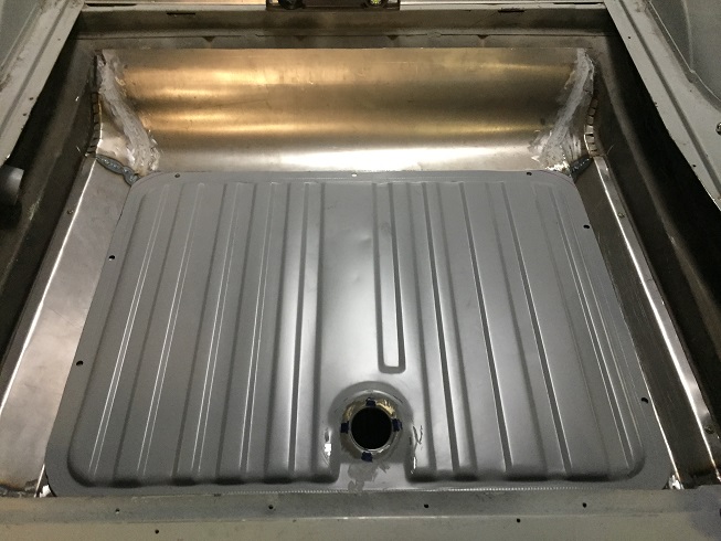

I have the new 16 gallon, 64 - 68 Mustang tank now for Custom Mustang in Melbourne.
Including the pickup and mounting screw $384 delivered to Adelaide.

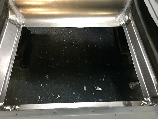

I needed to fill the big hole I cut from the XB tank so I built a frame.
A bit of cutting, a little rolling and folding followed but a bit of welding.
Then a heap of grinding.
With no shrinker / stretcher I had to do the old pie cuts on the front edges.
The rear corners were a bugger but happy with the results.

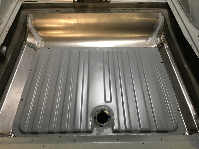

I did a slight trim on the corners of the tank to get it to sit down.
The next one I do will be for Retro Richard but so much easier now I have had a practice.
mustang tank in.JPG (111.48 KiB) Viewed 3029 times
Cut the inlet off and will patch then add a new one to match the in tub setup I have.

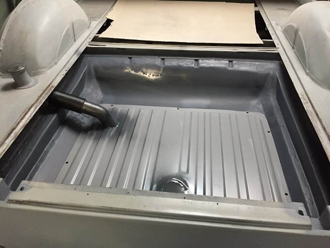

Happy to say I have finished the fuel tank.
Relocated the inlet to the side.

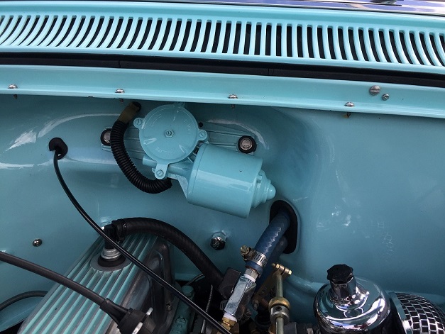

Started playing with 2 speed wiper motors from early Corolla's after seeing Phil Grima's setup at the Nationals.
Phil Grima.JPG (119.71 KiB) Viewed 2947 times
Not sure where this will end or if I need wipers at all. Just keep the ute in the shed when it rains :lol: :lol:

Subtle mod on the wheel tub Roger, deleting the filler recess.
Reckon that is Phil’s car blacky.
