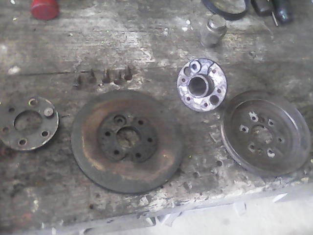

Re: Seagull Grey EK 2106
Posted: Wed Aug 23, 2017 6:16 pm
by Craig Allardyce

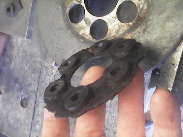

Stripped down a balancer and compared weights of the outer ring. The grey is 400grams heavier than the new type! How the can say this new type is a direct replacement is beyond me. It's almost liable misrepresentation.
Managed to pry out one rubber complete for some measurements.
