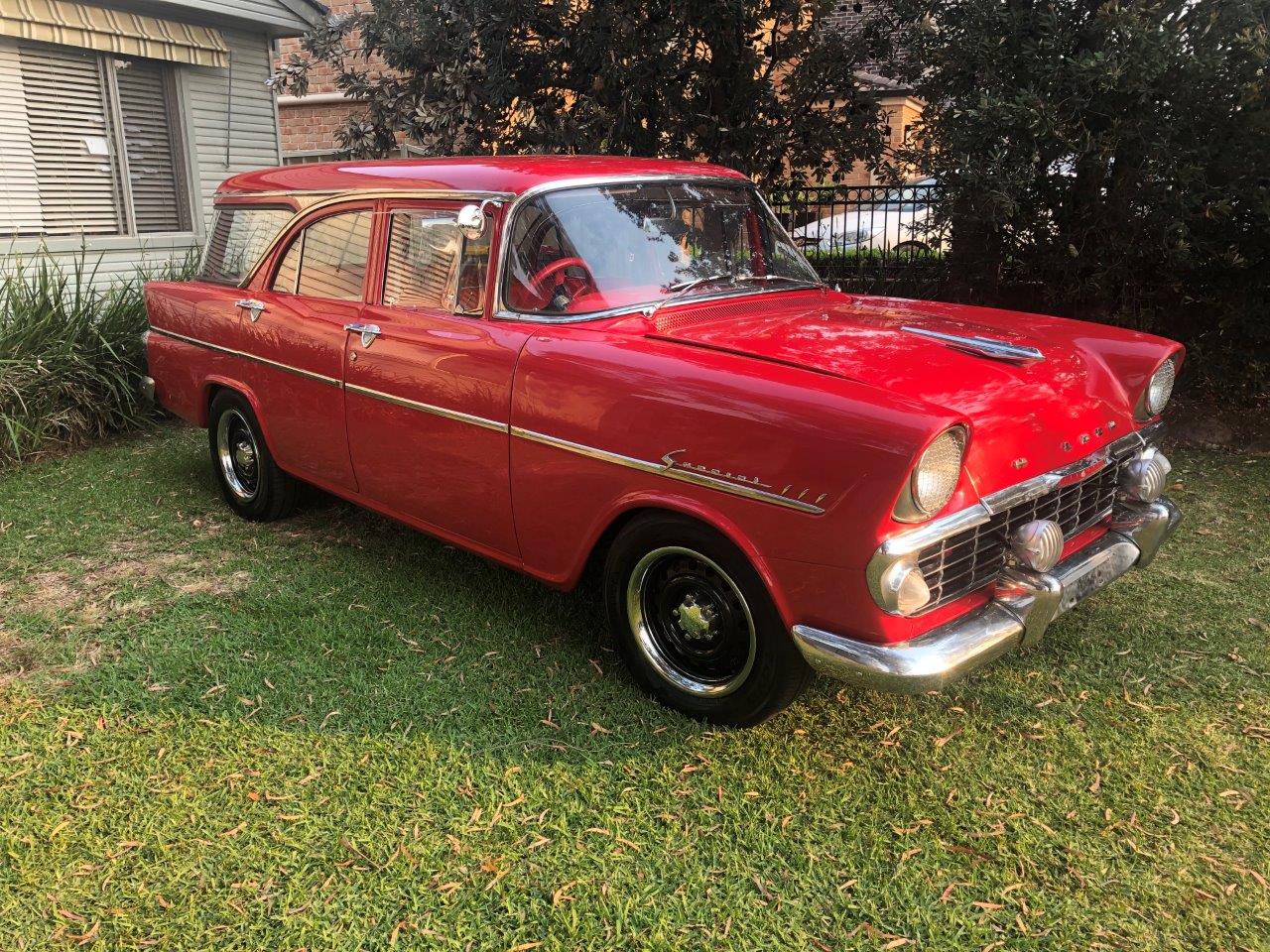

Quick photo of how the old girl looks. The Apache Red was a good choice. The "O" managed to fall off the bonnet... maybe it is a sign that I need to change the lettering to HOONEN. The bonnet allignment is abysmal, but the hinges have no more adjustment. Need to remove the bonnet and hinges to elongate the holes. The red leatherette steering wheel isn't that flash (too modern), but is better than the wood-rimmed one that I had (once your hands got sweaty, the wood rim was very slippery). Lots of touch-up work to do.

The paint says it already. I love it.

About the bonnet Harv. Did you change subframe, guards, doors?
Posts: 5741
Re: harvs ek 327 wagon
Errol62 wrote: Sun Nov 24, 2019 3:12 pmDid you change subframe, guards, doors?
Yes, yes and yes. The poor thing had more panel colours than a crocheted blanket. To quote Adam Sandler's song:
