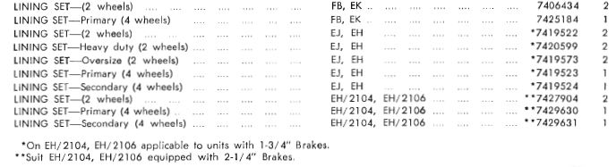

This might also help. Note EJ/EH commercials had a wider shoe.
ardiesse
Posts: 1204
Re: New Brake Drums ?
Post by ardiesse »
Clay,
(photo of rear axle a few posts back) The rear axle you're extracting from your stash of parts is from an HD or HR. Position of brake hose and style of handbrake cable attachment to underbody suggest it. And they definitely look like HD/HR rear drums.
Craig,
Some EH commercials had 1-3/4" brakes, and some had 2-1/4" brakes, by the master parts catalogue. I reckon that those with 2-1/4" brakes were post-March-1965 EH commercials, made while HD sedans and wagons were in production (much like FJ commercials were made up until May 1957, way after FE release). They would have been fitted with HD wheels (and alternators, but that's off-topic). 7429xxx part numbers are normally HD/HR.
