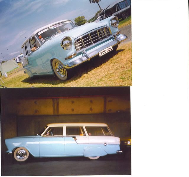

a few painters have told me the same, but, you can get a deeper gloss with clear.Devilrod wrote:Yep as Rosco stated and as told to me by a spray painter. Solid colours do not need clear. It will only complicate things and cause problems.
The biggest being if you rub through the clear or buff thourgh you will get a line that no amount of polishing will remove and a patch of paint a slightly different shade.
Also as Rosco said, spray all the edges and tops of curves a few times before doing the whole panel as you have less chance of rubbing through.
the day before my first son was born my old boss smashed his volvo into my car, i told him it had to be repaired imediately, he sent it to a panel shop. i insisted on the shop using the same method and products i used, he told me clear was a waste of time on solid colours, i still insisted on the clear but the bastard ignored me and repaired it with a different paint system and no clear.
the car had a glassy finish wich looked different to most light coloured solid colours bur were he did the repair it was less glassy, it looked like your average solid colour.
with that job i added clear to the last bit of blue left in the pot, probably about 200ml, then as i refilled the pot i just added straight clear till i had 5 coats on. in the last 2 pots i used 2k retarded thinner wich lets the final paint flow out flatter on the last coat saving some cutting.
I am a detailer so the car was buffed frequently, it was a family car and work car as well as my cruiser, i never had any buff throughs, i used cheap wattyl acrylic paint, the car was in the sun everyday for years with no signs of yellowing or paint cracking, it was always polished with cheap but professional polishes, no fancy wax.
in these pics the car isnt even clean, you can still tell the finish looks different to solid with no clear, usually these light colours dont reflect a very high gloss.
Hi FC Cool - looks clean to me - yes, I agree - lighter colours don't reflect with the same depth that mids or darks do - however, in low light - to me, they seem to come into their own.
I also believe what you have stated supports my feelings on clear with solids - they can be an absolute pain to spot match - I have played with clears both mixed in at 10% and also over-coated - I must admit, with my colour and paint (Standox acrylic) - it is almost impossible for me to pick any advantage.
I do, however, block down with 1200 before cutting - if the surface is older (and hard) I will even use 1500 (can gouge, if the paint is still soft) - from there, I find the finish to be comparable to anything clear coated/mixed without the hassle of having to match small spot repairs......
Your wagon looks very neat - if that isn't clean - please post some when it is.....
