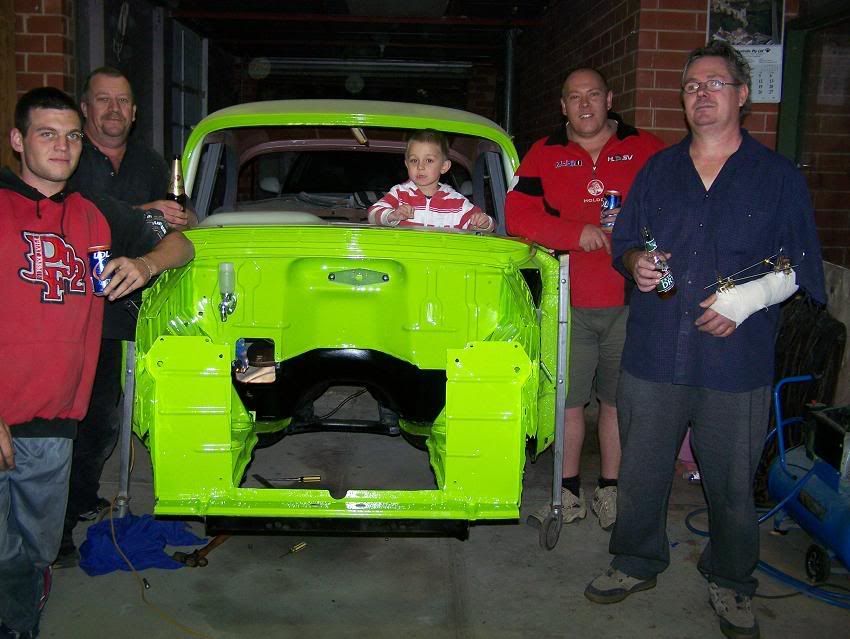

originaly i painted my orange car with a custom tint basecoat,added a fair bit of gold pearl to that base.then added pearl to the first coat of clear for a gold pearl overlay.however when i got the tubs put in they cut through my rear quarter panel with the grinder and the fibreglass front fenders and bonnet started to take a battering from the amount the car shook so i decided to paint the car again.Still used the same basecoat but no pearl overlay.just plain 2 pak clear.the green car (basicgreen)is a topcoat protec 606.turnpike green.no clear.less work for me.its nice to work with,little or no buffing required.amen to that.I have not heard of hok lime green,is it a new colour?

here goes nothing. thank you for all your HELP painting and rebiulding our car and the work putting the pictures on for me as it would take me days on my computer thanks CAPTAIN BILL. thanks for all your good comments boys basic.greenjavascript:emoticon(':D')
