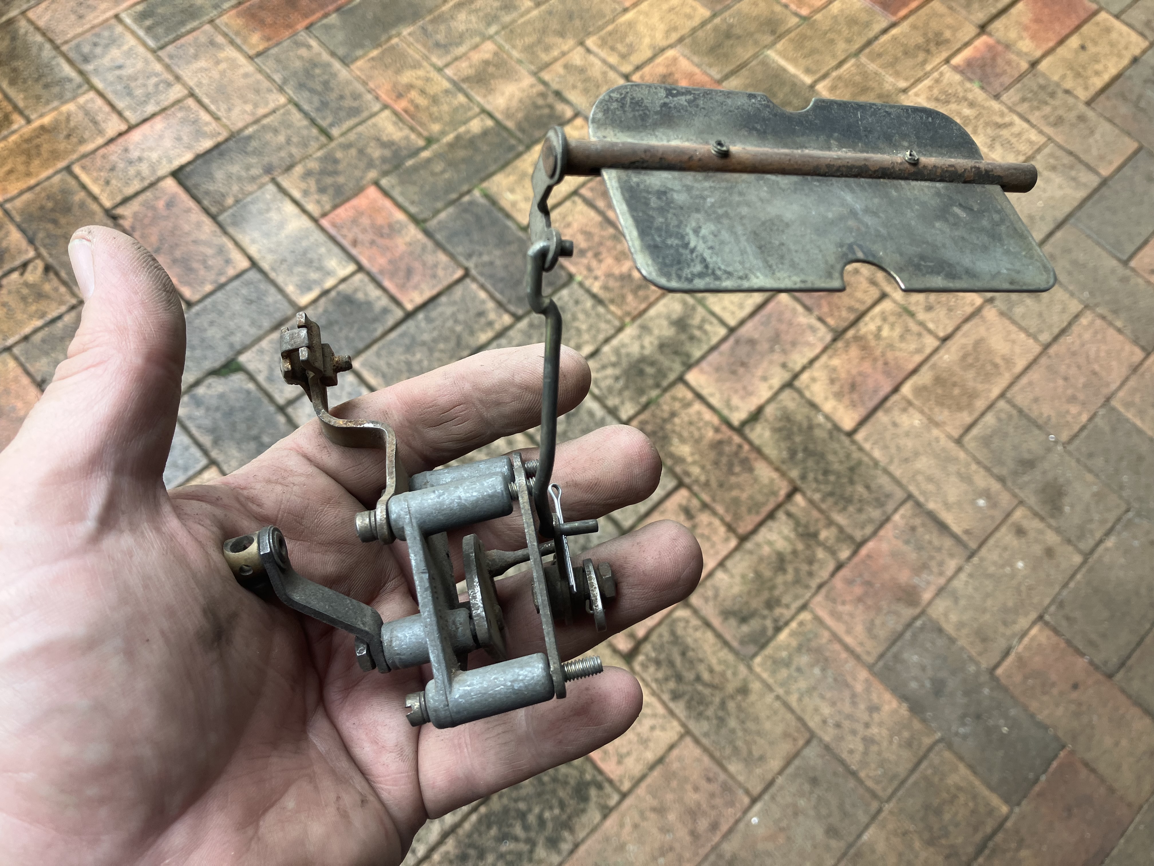

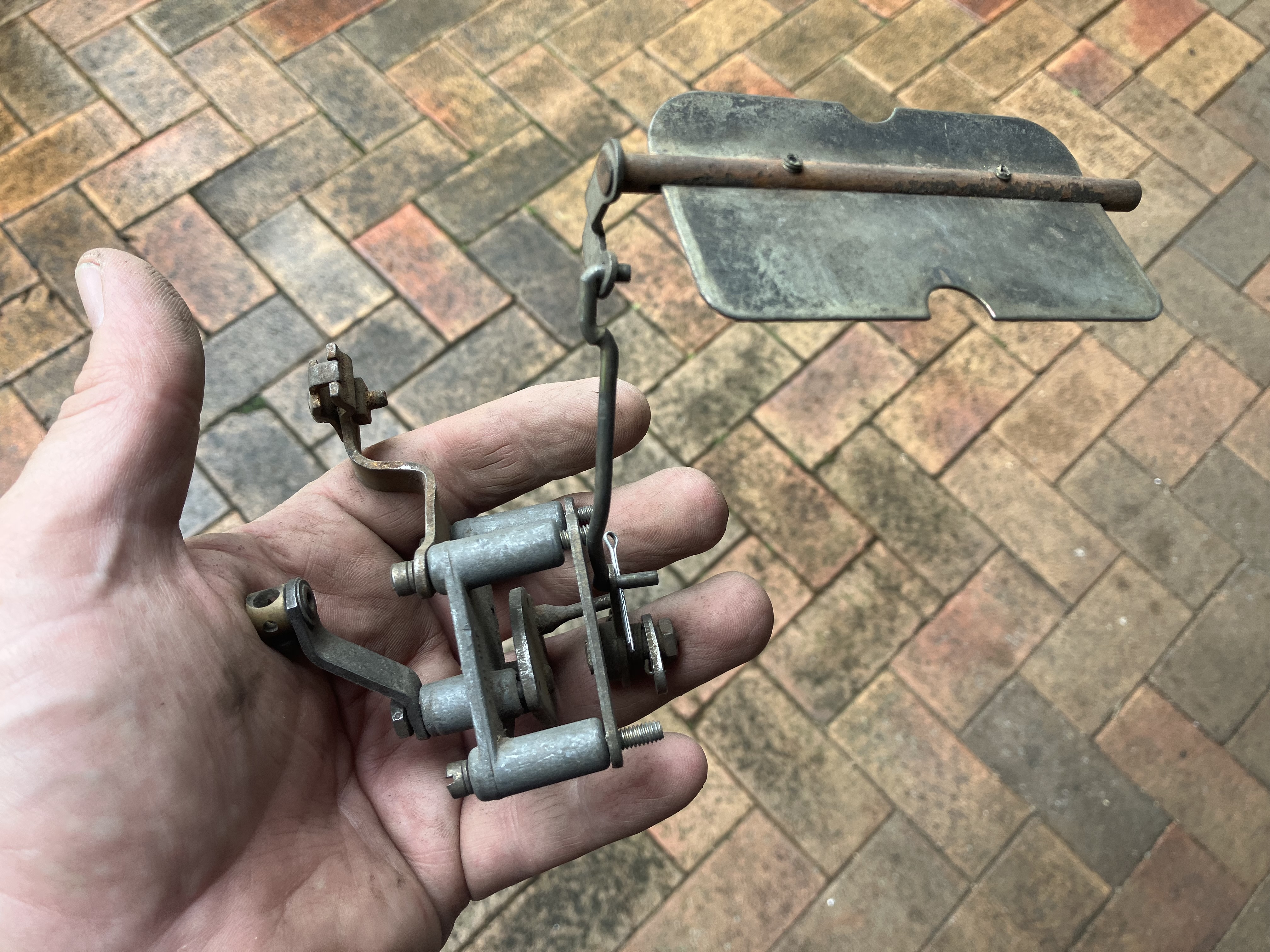

Lemme check. When I was faffing around with the 350's, I deleted the choke off one, and added epoxy to smooth the inlet flow. I may still have the bits in the spare parts department.
Re: Elle’s 1960 FB 225 mild custom
Posted: Sat Nov 30, 2024 12:24 pm
Found it. If this suits what you are after, PM me the name and address and I’ll send it to you. There are a couple of thermostatic chokes there too, but assume you want a Manuel one.

Thank you very much fellers. I need to buy you both a drink. PM sent Harv.
