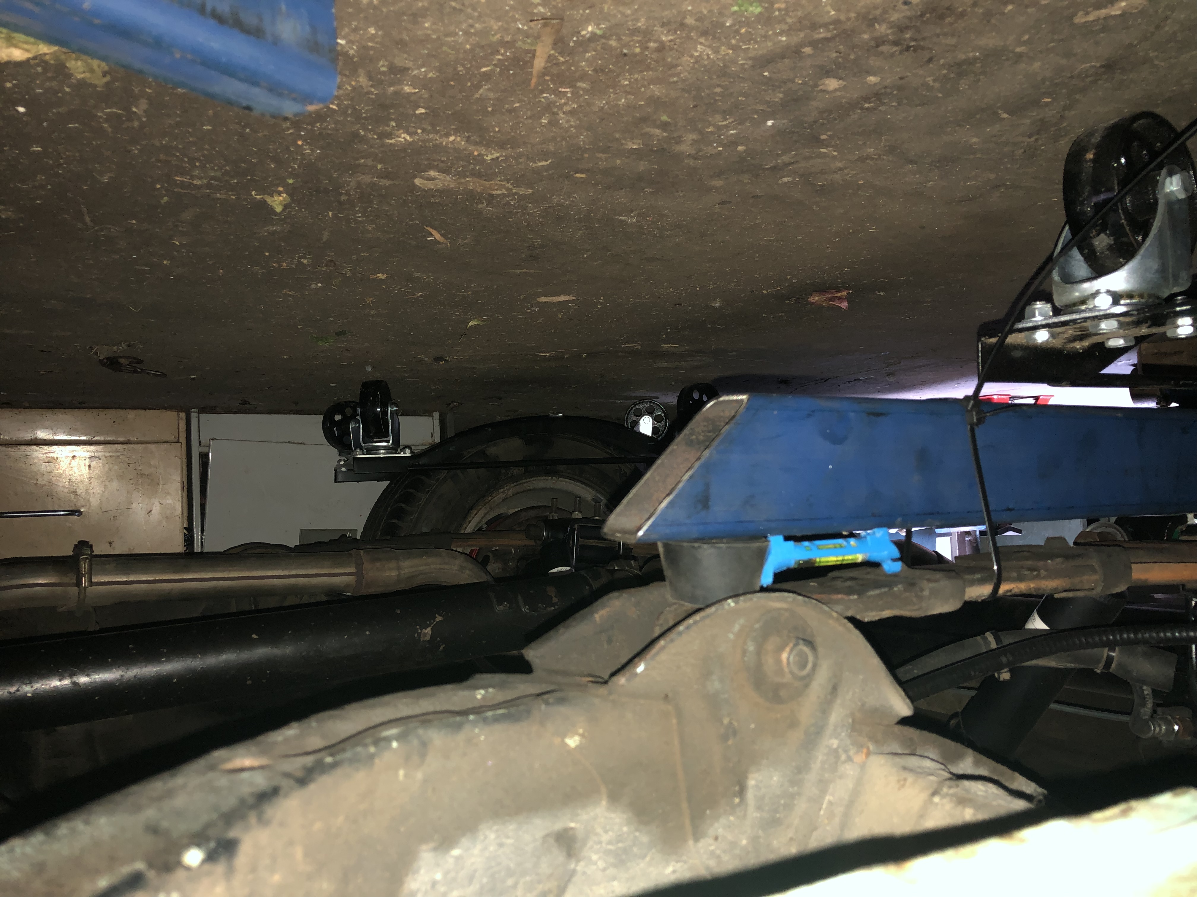

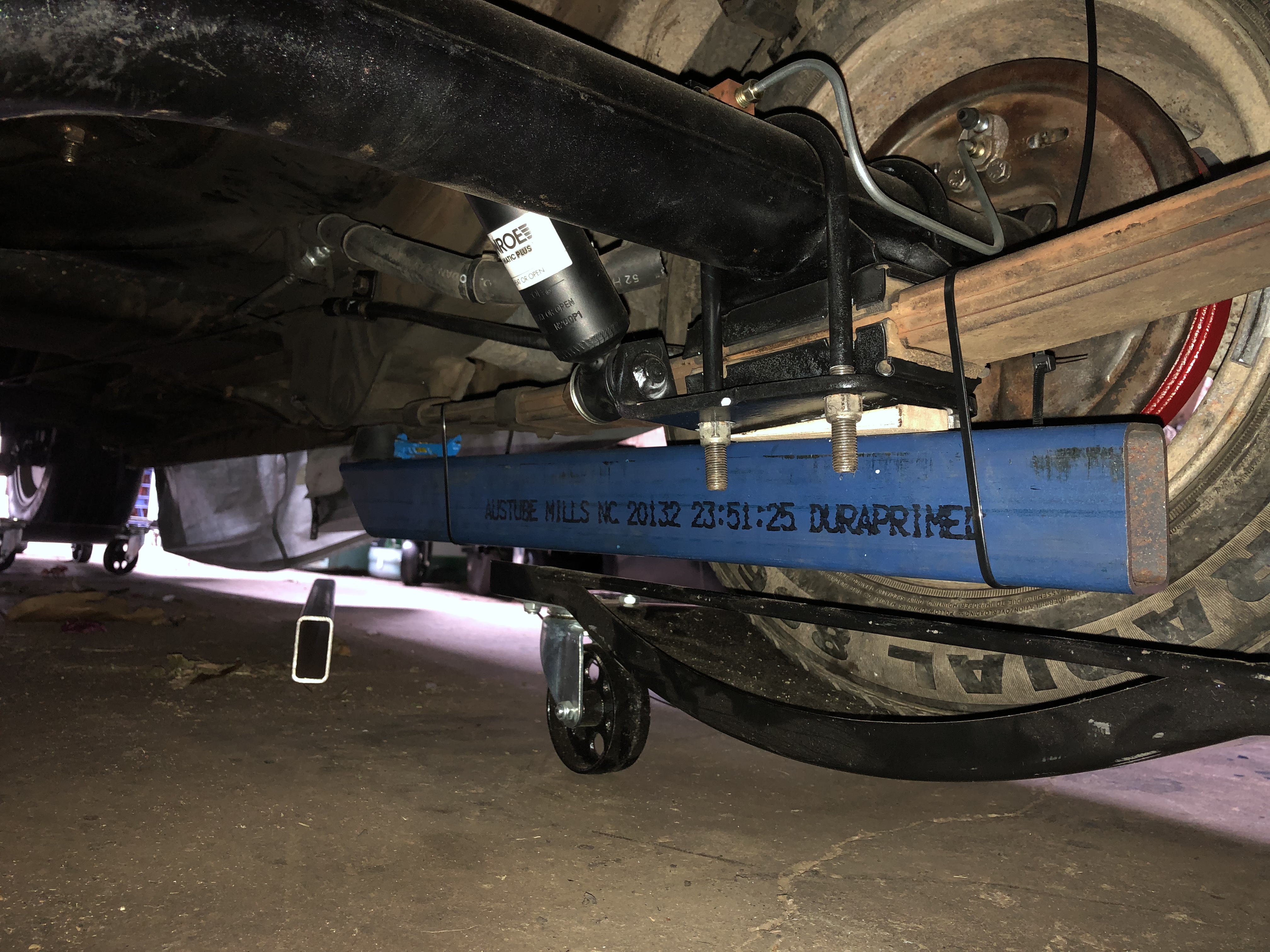

Getting closer.
Need to get the bars horizontal. Bump stops trimmed to 1 1/8”. Needs a 5-degree wedge in lieu of the white wood chock.
Final trim up, then off to the brother-in-law for weld out.

Don't you need clearance from front snubber to spring perch mate ? I wouldn't think having them hard up at rest would work ?
Re: Harv's traction bar thread
Posted: Tue Nov 30, 2021 7:09 am
For race vehicles, no gap. For street vehicles, about 1/4" gap. The no-gap option works OK, but can make the rear suspension a little twitchy on the street.

Thinking it through, I need to tilt the bars up. Normally a steel wedge is used between the traction bar and bottom spring pad. The Mr Gasket/Lakemaster wedges are expensive (~$80 for two bits of steel :roll: ). Could make some out of ally plate, but had a better idea. The suspension rubbers on the FB are all pretty much flogged out. It would probably pay to replace them (and see where the new ones sit) before getting too serious on the traction bars. Nolathane will be stiffer than rubber, so some new Nolathane needs buying. Looking at the Nolathane saddle bushes, they are pretty hefty (20mm thick each) with little smoosh. I reckon I can skim down the bottom one to get the tilt I need without a wedge.

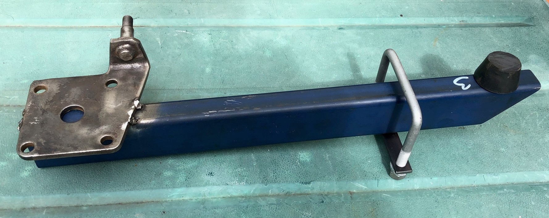

There is to be no 'laffin at my boogery tack welds...
traction bars tacked up.jpg (491.52 KiB) Viewed 4943 times
Waiting now for the nolathane saddle bushes to arrive, then final fit and fiddle.
