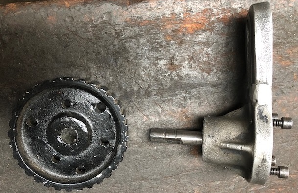

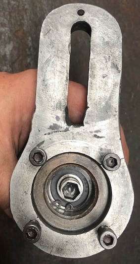

Managed to pull apart and rebuild the McGee pump mounting bracket that came with the red motor set. These brackets are used to mount the injection pump in line with the crank, and drive them with a gilmer belt. This particular one has had a hard life – bearings were shagged, bracket had been cracked and weld repaired, and at some stage had been reshafted to suit an Enderle hex drive pump (the McGee pumps are tang drive).
The drive pulley was not recoverable… has had what looks like grinding damage at some stage. Why on earth you would paint it up in gloss black paint afterwards is beyond me.
