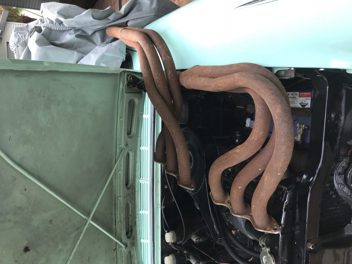

Managed to lay my hands on some headers for the project (with thanks Paul). They were out of something other than a car... might take a little bdy adjustment to get them to fit (pass me that hammer :mrgreen: ):
Optimized-Repco headers.JPG (617 KiB) Viewed 1913 times
They are 1 5/8" x 2'7" primaries, 2" secondaries. They will be damn useful for the run-in that the motor will get, and the dyno runs. They'll also be a good template for making up a new set. I'm figuring on getting two made... a set similar to these for the street, and a set of short zoomies for the drags (similar to Eldred's Eclipse Zephyr Special).

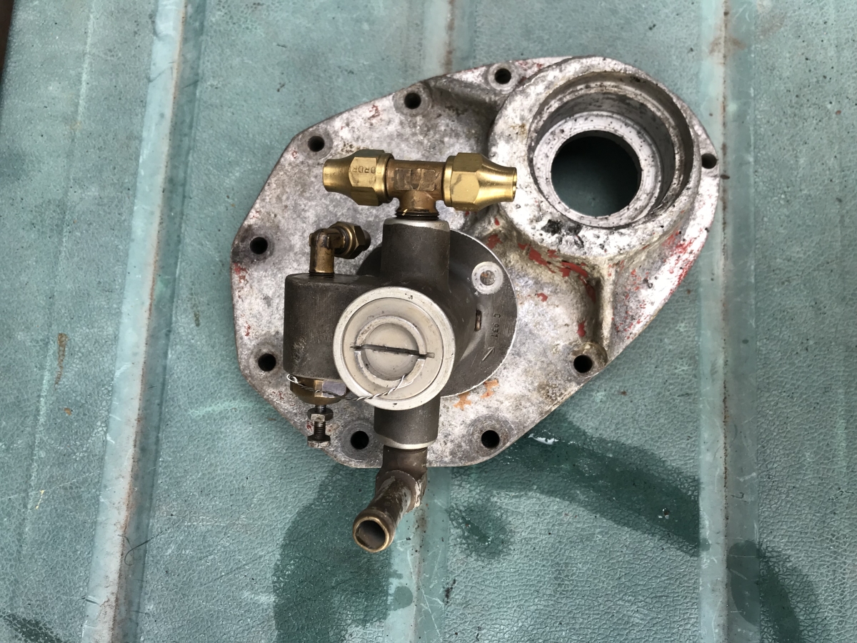

Also managed get hold of an ally timing cover (with thank Chris). Need the cover so I can mount a fuel injection pump off the cam end. (Bullshit) artist's impression below:
