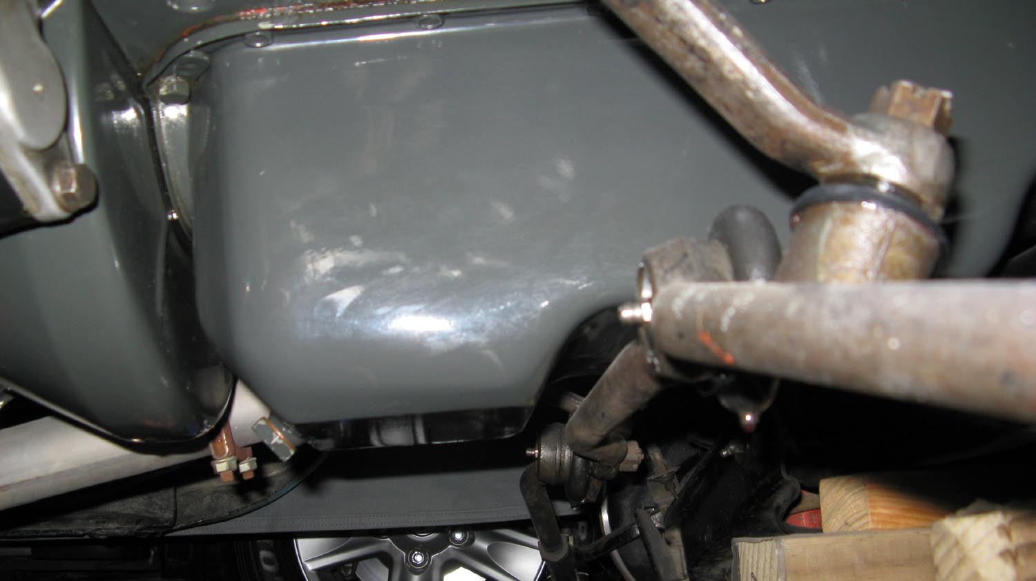

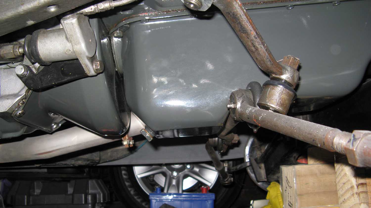

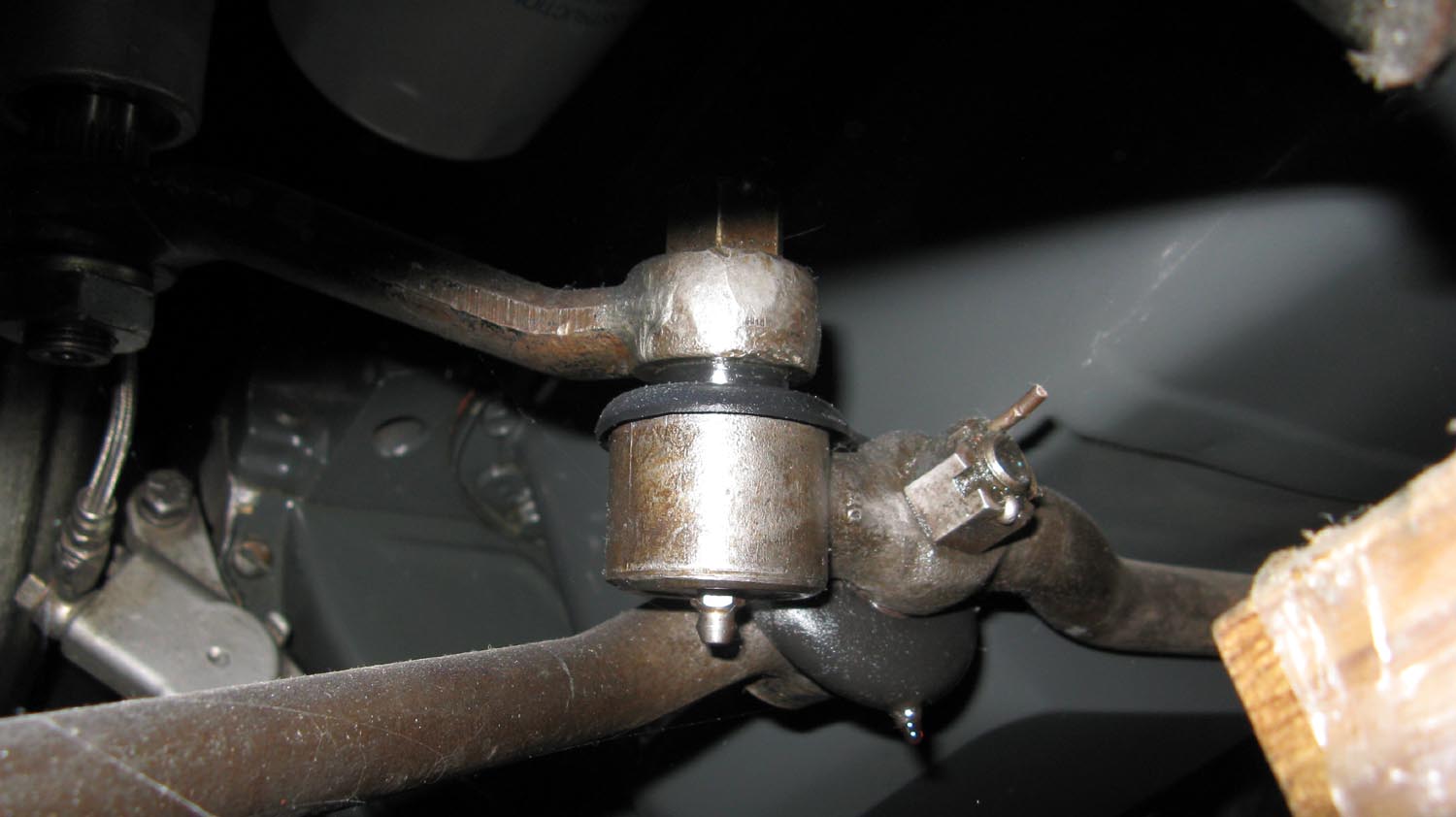

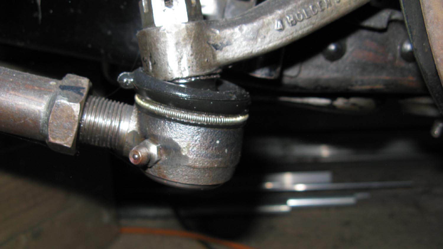

Ok Clay - as promised pix.... direct from this machine.
First up, r/h tie rod location at full r/h lock - the steering arm is hitting the stop on the lower control arm - can't ask for more than that.
Also, note that the vehicle is up on blocks at present... suspension is fully extended.
001 draglink rh lock mail.jpg (96.86 KiB) Viewed 7737 times
002 steering arm rh lock mail.jpg (91.71 KiB) Viewed 7737 times
Next up, we have the location of the draglink in front of the modified sump. First pic is full r/h lock, second is full left lock and final pic is with the wheel centred...
003 sump rh lock mail.jpg (96.02 KiB) Viewed 7737 times
004 sump lh lock mail.jpg (92.73 KiB) Viewed 7737 times
005 sump central mail.jpg (100.07 KiB) Viewed 7737 times

From the first pic I can see that your inner tie rod clears under the end of the drag link. Mine seems higher up. I was sus about these bits I got off eBay. Price was too good to be true.
I think next step may be to remove the whole assembly. Easier done now with engine and guards out the way. Seems to me adding the weight of the engine will not improve clearance. However I am easily sidetracked, and removal may not happen for a while.
