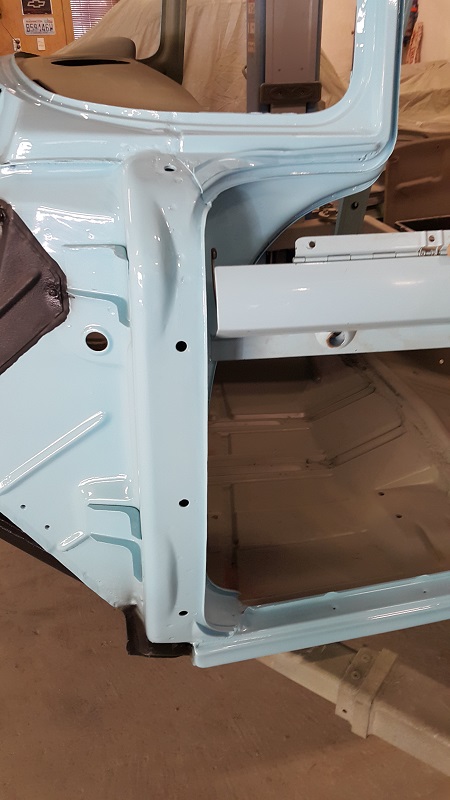

front end parts getting ready for reassemble

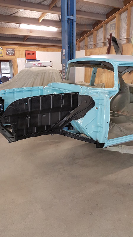

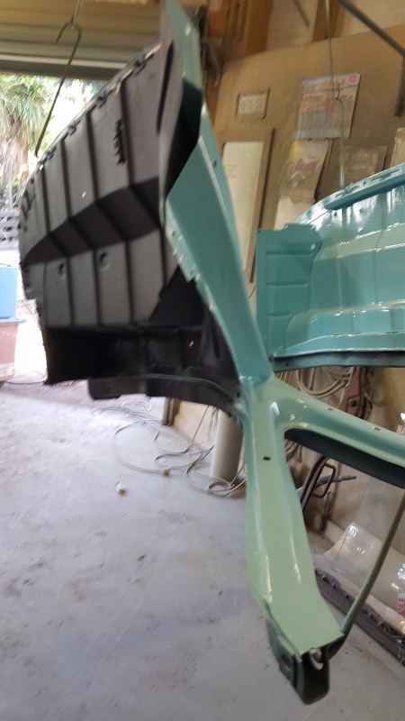

a bit of blue

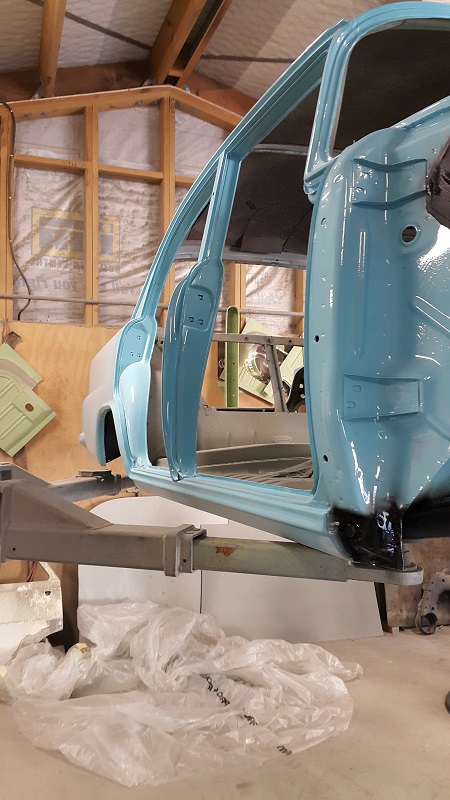

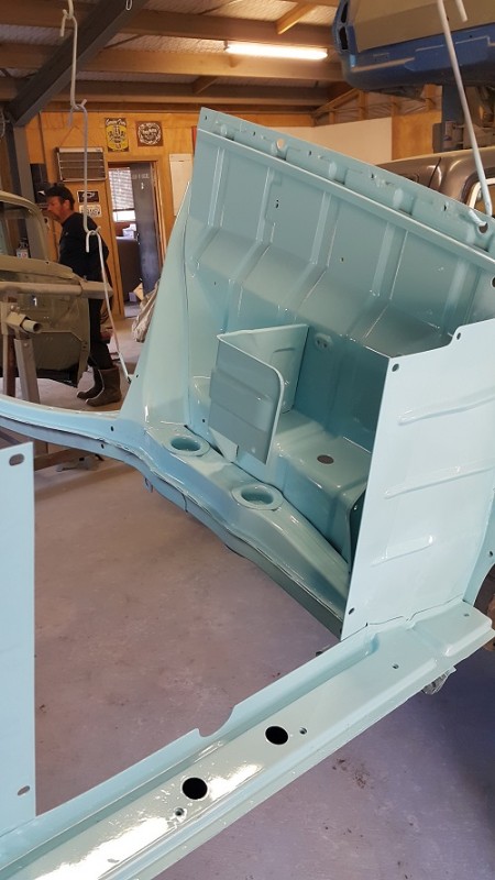

different angle

looks great mate, what colour is it ? A stock one ??

G'day Blacky,
sorry for the late response, stock color, well the best we can match, I would like to think its Lucerne Blue and Alpine Blue but cant confirm, I cant find any documentation which matches the paint code (sticker) (BALM) colors.
I am painting the car using two pack, and when we mixed the paint as per the recipe (dulux) old (BALM) they were close, but not quite right, the best way I could describe was they were too clean, the darker Blue was harder to get right, and had to make the color dirty.

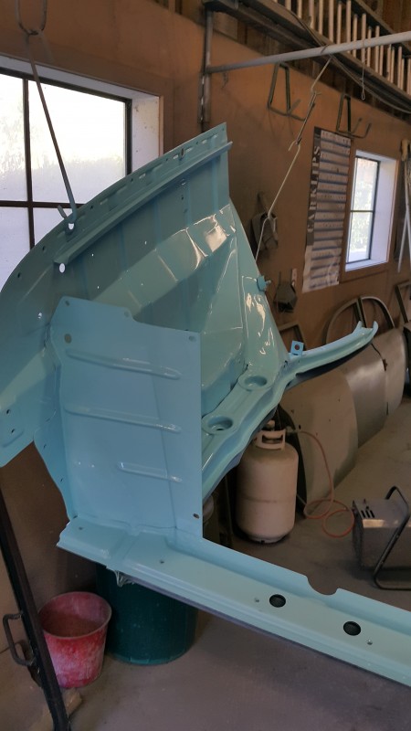

Different light, the black for the radiator surround will go on later.

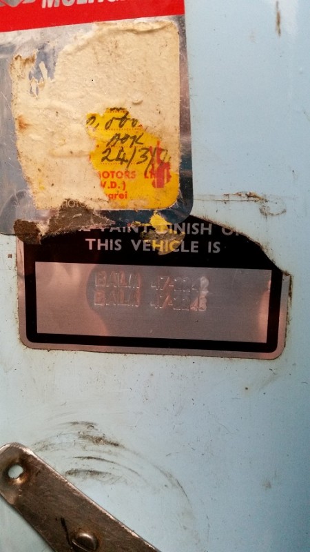

G'day Sunny Tim,
please find the tag, not much info, the 225 is the only number which means anything too me.

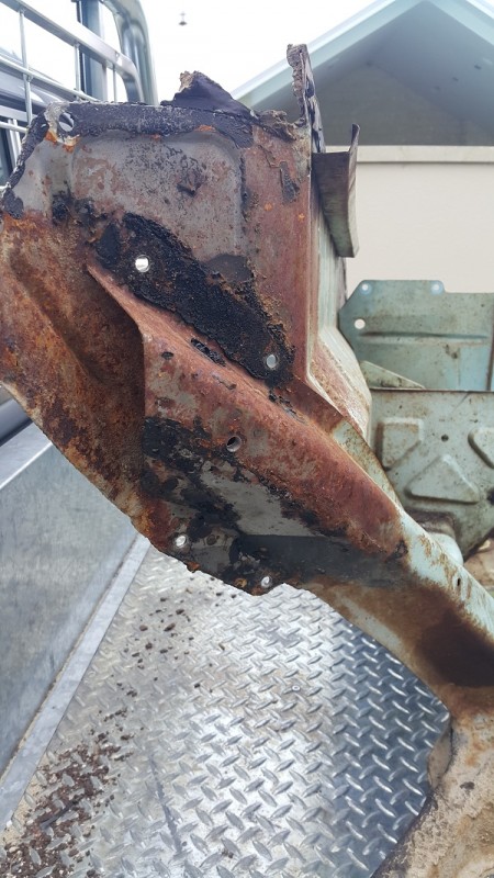

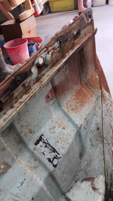

G'day Sunny Tim,
There is no numbers stamped on the front sub frame. It would appear my NZ assembled car had the front sub-frame bolted to the body unpainted, as when disassembled raw galvanizing is showing where the panels meet, looks also to have the bonnet hinges and bonnet installed prior to paint, and the blue blown in as far as they could have reached, the radiator black surround applied after the blue, there was also blue under the small guard brace ( the small rod ).
In short, I reckon the complete car was painted its light blue as a whole, the darker blue applied, there was over spray inside the door pillar ( b pillar) , and then the car was rust proofed ( black tar shit) applied every where, which has ran through any holes.

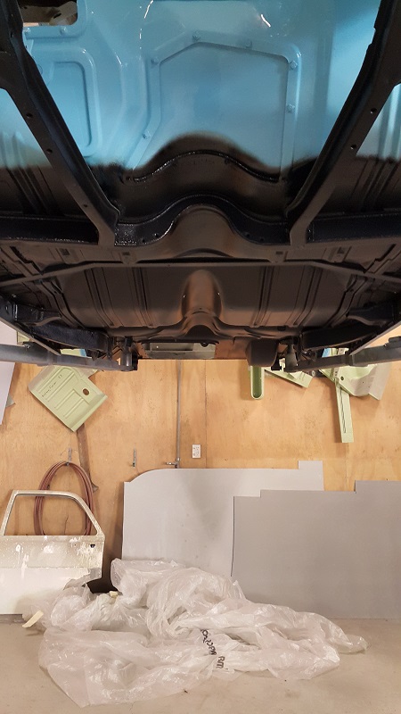

Still just chipping away, this is the FB as of Saturday the 2nd July

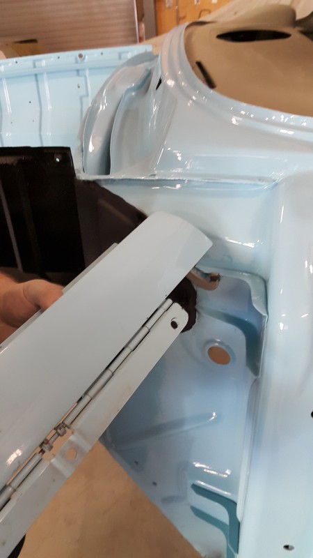

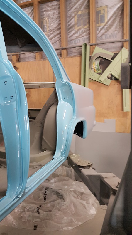

Just a couple of photos of the color, the new color against the glove box.
