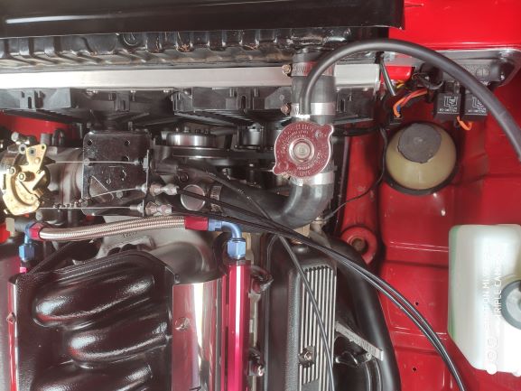

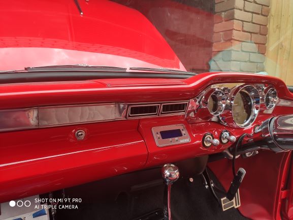

Been a while but worth it i think. Been for a few test drives, over heating problems solved after fitting right size thermo fans, 2 1548CFM Maradynes, although A/C not charged as yet. Which brought me to my next problem, i fitted a 120A alternator, damn Gilmer drives too under driven, so found standard single V pulleys and had the alternator pulley machined from 62mm to 52mm now have ~3-1 ratio, idle charge good and solid.
The electrician did a great job of getting everything to fit neat and tidy and still have a bit of glovebox space.

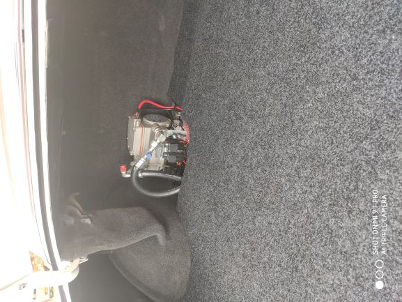

The A/C compressor will probably be covered by a fake subwoofer enclosure to complement the real sub enclosure on the opposite side of the boot.
