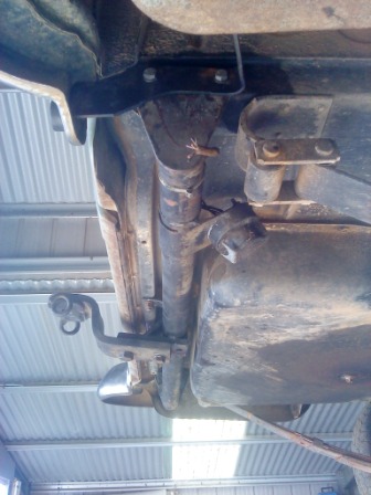

Are you painting it Craig or just an undercarriage restore?
I bet that's not the first time you've pulled your fingers out of a hole looking like that!!!

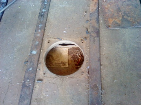

Looks like the previous owners used farm dam water in it..
Re: Seagull Grey EK 2106
Surprised there aren't any Carp in there, then.... a cheap way of getting "fishoil" into places like that....ssshhhh! - don't tell everyone, we'll run out of Carp...WayneXG95 wrote:Looks like the previous owners used farm dam water in it..

No paint Trev but I'm trying to work out an easy way to clean underneath and maybe coat it for some protection. Paint might come after 2018 Nats.Trev wrote:Are you painting it Craig or just an undercarriage restore?

Spent the day digging and pressure washing the out water jacket. There was probably about 1" deep of shit around the back three cylinders, just lapping at the lower edge of the welch plug holes. The back cylinders were the worst for wear as they must have been running fairly warm. Funnily enough there was no thermostat fitted ether so it must have been playing up. Looks like it will be .010" oversize job. Hopefully I'll be able to find some pistons. OS cam bearings are a bit more of a challenge though. Tomorrow will be a start on the head and gearbox.WayneXG95 wrote:Looks like the previous owners used farm dam water in it..

What you are doing now, Craig - is more than likely going to outlast you...
I ordered my current 179 HP block engine from GEM in Sydney - had to wait for it... back in 1982, before commencing disassembly of the front section of my old bus.
When the motor finally turned up - I trailered it home.. and started "looking" at it... I was absolutely shocked at the amount of crap I got out of all the cooling areas.... it may have been chemically cleaned - draino is a word which immediately comes to mind.. I got an awful lot of crap out of the water jackets and deep down in the lower areas around the base of the block.... the head was equally disgusting.
I phoned GEM up the next day to be told that "I had now effected modifications to their supplied engine".. my response was the fair trade ombudsman.. to which I was invited to return the engine for inspection and rectification.... no chance, and some 33 years later - the cooling system remains clear.....
Do the work now, maintain the system with treatment... and drain/flush/re-fill every two years.

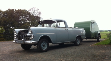

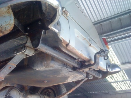

Well I got a little astray today. Didn't get to the head or gearbox. Decided to fit the towbar which went real well. A little manipulation here and there but nothing too difficult. Even some of the paint on the bar matched the car colour. Thanks again to Kel!

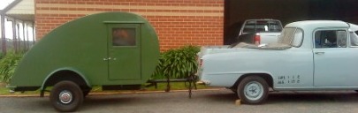

Did a test fit with the teardrop on and the ride angle looks spot on. I was looking at fitting drop axles but wont now. I'll look at reworking the guards now that I've got the 13" in wheels on. The old wheels were 16" off a 1933 Dodge.

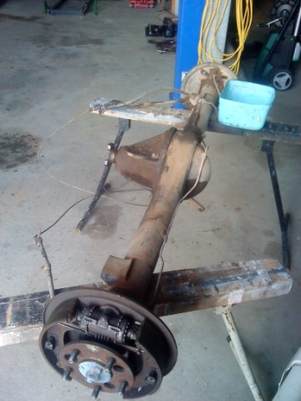

After that it was time to drop the rear end and continue on with the rest. Springs out ready to go and get redone so I can carry the rated 32 Hundred Weight! Shocks definitely are original. Not one drop of oil left in them! Top mount access points under the floor still had the paper covers stuck over the holes!

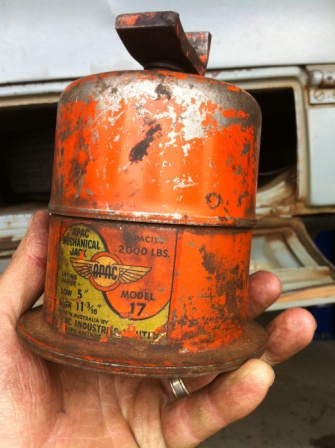

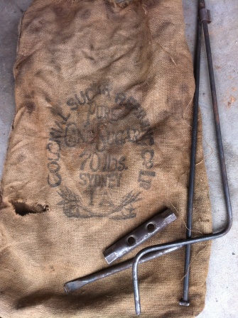

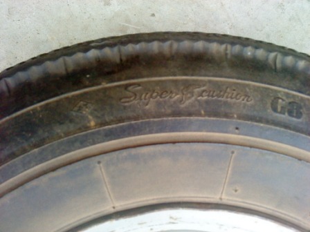

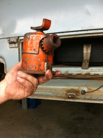

Had a good look at the spare wheel gear. 1 x Goodyear 4ply "Super Cushion", 1 x Colonial Sugar Refining Co Pty Ltd 70lb Pure Cane Sugar Hessian Bag, 1 x APAC Mechanical Jack (Not sure if this is original).

Like the tow bar with removable tongue.

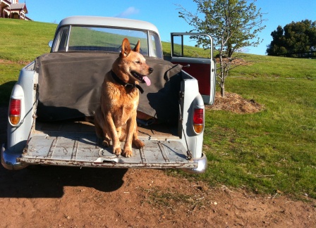

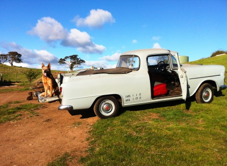

Red dog looks rite at home
.[img]http://i47.photobucket.com/albums/f177/trevwood/WOOFTOsmall.jpg[/img]

Yep the dog loves a ride in any car.
Luckily the tongue comes off. No chance of getting the spare out with it on.
