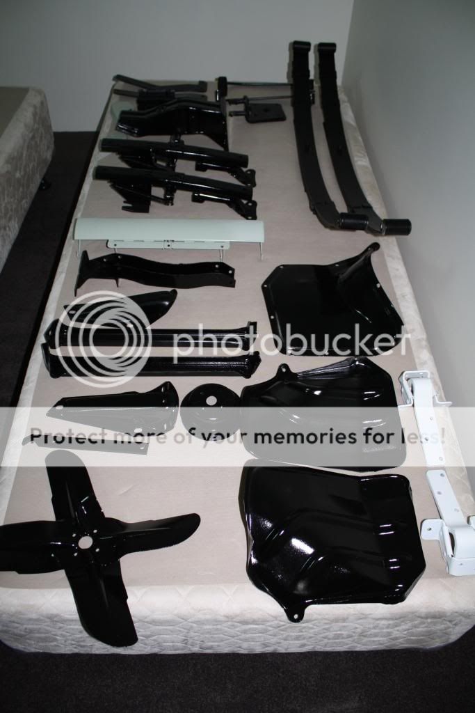

Just thought I would post a quick update on the FB

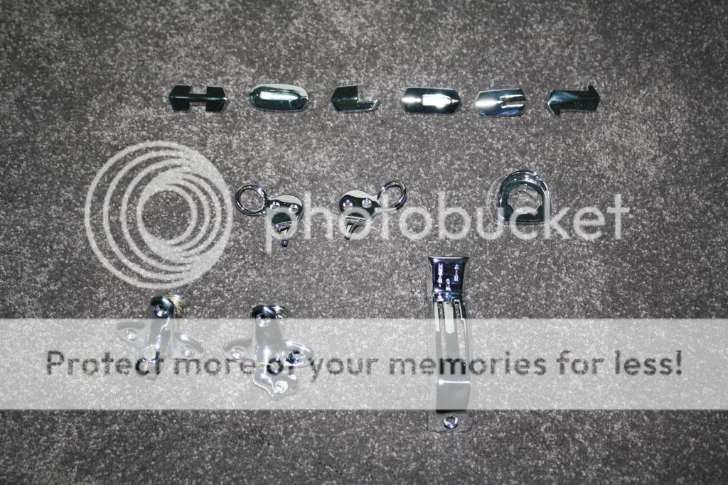

While I patiently wait for the body and panel works to be completed I have been busy sourcing, cleaning, blasted, priming, re-chroming and cadmium plating all my old parts
Here are just some of the parts that I have refurbished

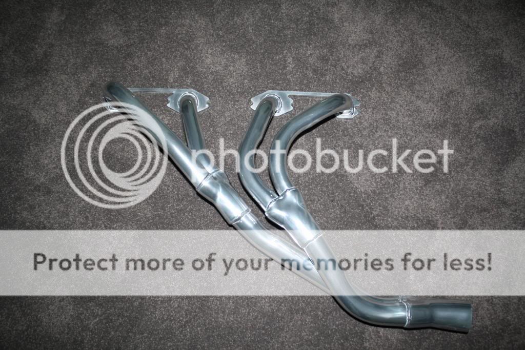

The new extractors I had ceramic coated

A whole heap of parts I blasted, primed and repainted
Refurbished seat sliders

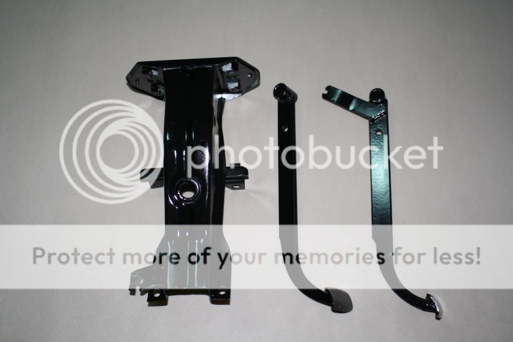

Refurbished pedal box

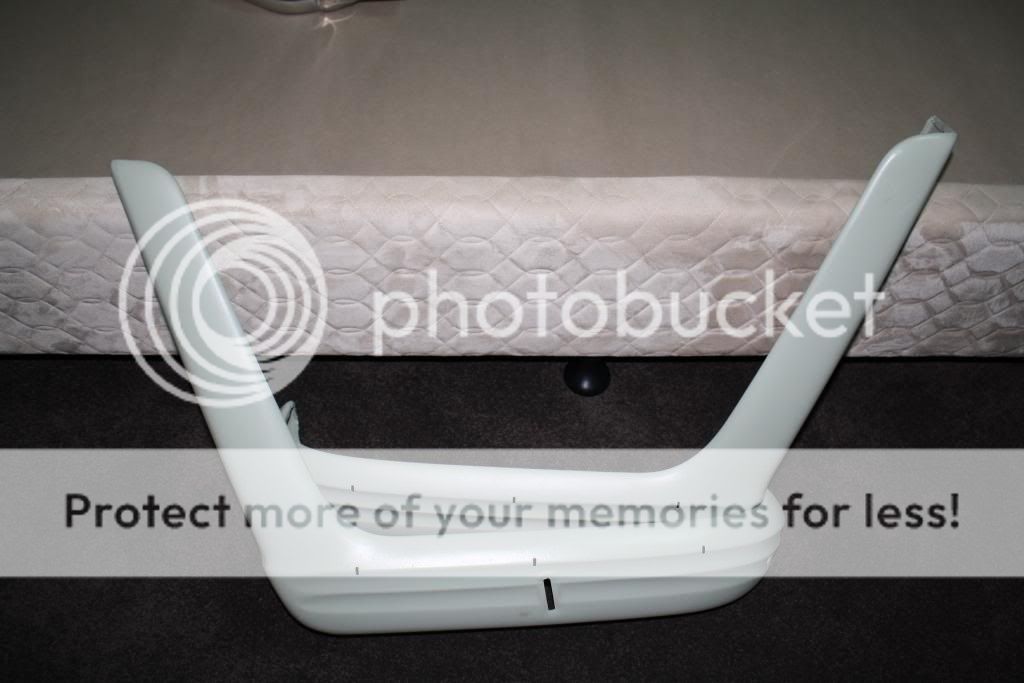

Bench seat side panels, sanded, primed and ready for paint
A few little pieces rechromed, my wallet is to scared to get all the big items done

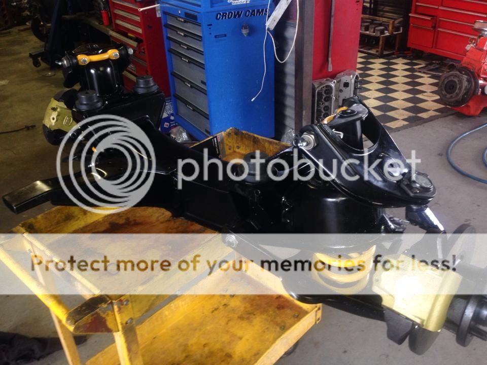

Finally finished the front end
HR Disc brake front end, fully stripped, blasted, rust protected, primed and painted. Replaced both upper and lower ball joints, all new bushing kit to both upper and lower control arms, new stub axles, brand new rotors and calipers fitted. Just waiting on shockies and new brake line to be made up

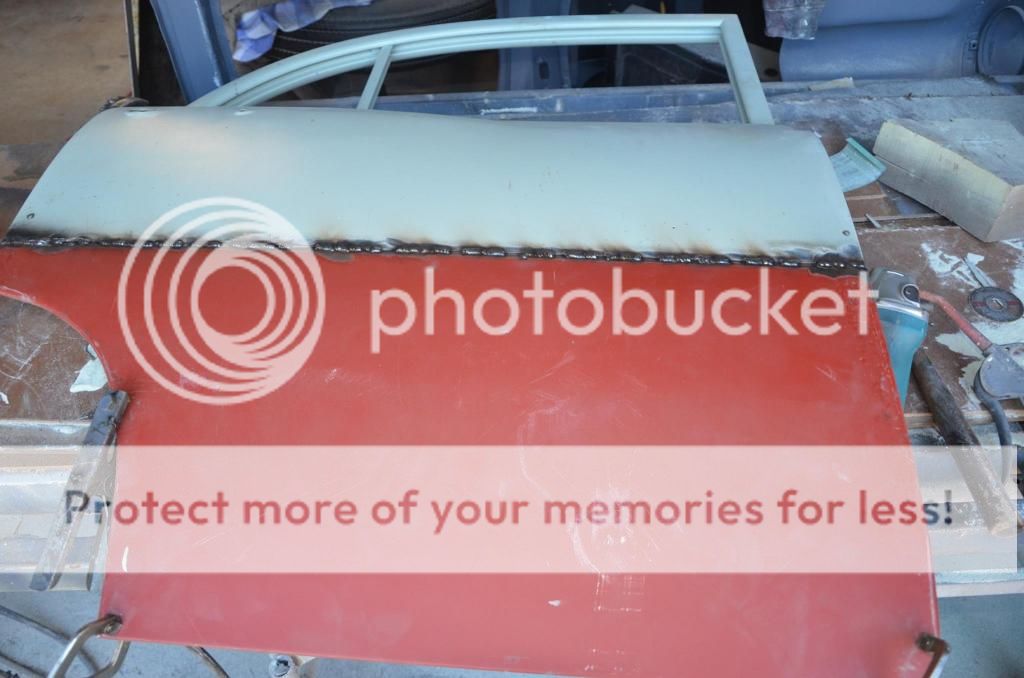

Just a quick update on the build, with some more panel repair work done.
All four doors complete, with new door skins from Capalaba in Queensland (Rare Spares), skins were just about perfect, just some minor mods to the rear wheel arch section but all in all an excellent product if anyone needs replacement skins.
