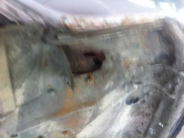

Bit of an update. Found the same rust on the left side of the firewall as on the right. It was well hidden behind dirt, until Dave had a good go at it :shock:

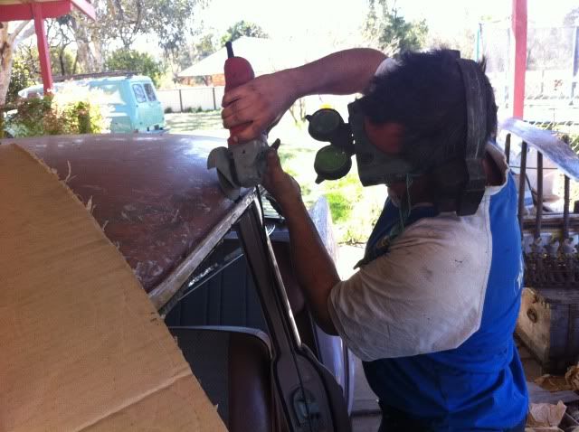

Anyway, I paint stripped back the roof and sunvisor. Finally got the hang of it without snapping blades every minute, and making a total mess

Amazed at the condition of the roof. It had a small 3-4mm rust hole on the left side which I assumed was part of a much larger problem, but that was it.

This was the rust on the left side of the firewall, actually worse than the right hand side.
Before
After

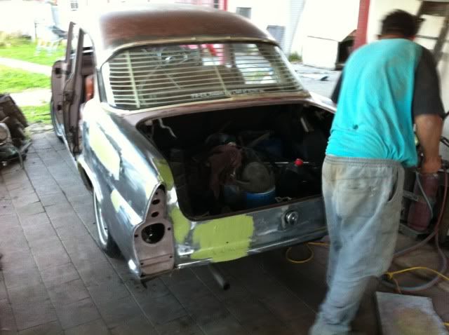

Dave did his magic on the right guard. Had the same previous dodgy repair to the peak as the other guard. the rusted section on the top rear of the guard was also replaced
Rust repair on rusted section on roof. I was sitting in the car with a bucket of water and wet rag keeping the roof lining moist, as my heart was skipping a bit weach time I saw weld spatter through the lining :shock: . Thankfully nothing caught fire :mrgreen:
Whilst Dave was working on the guard, we moved the car to the grass, where I was cleaning off 50 years worth of grease and whatever else from the front end. Still more to do, but the amount of shit that came off was unbelievable

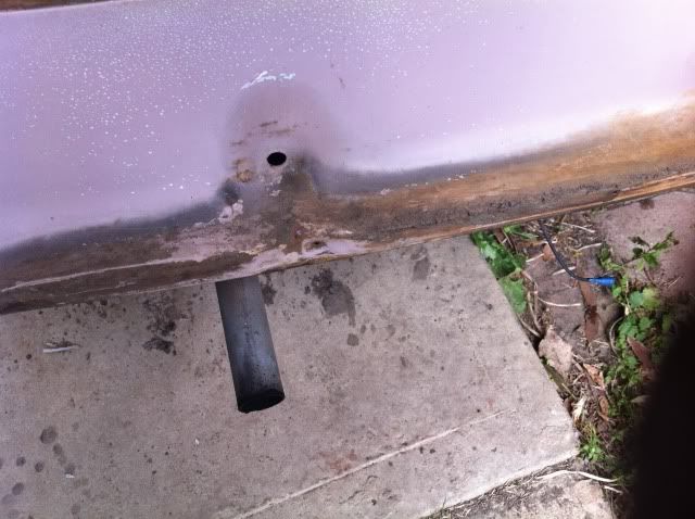

The repair on the roof tidied up with a bit of filler

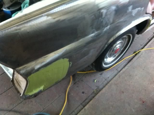

The damage caused by the over riders was whacked out, plus Dave heat shrunk the metal in those areas, as it had stretched
A few minor dents and scrapes on the quarters repaired. A bit of filler added
