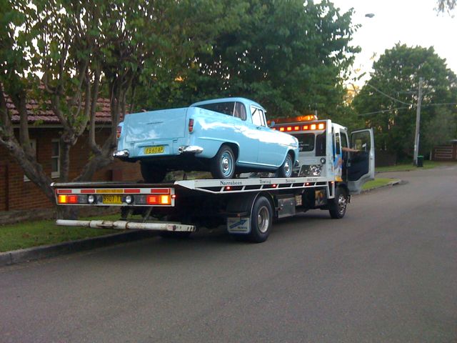

so I shipped her off to the Mechanic (courtesy of NRMA Roadside membership - pays for it self in triples)
Mechanic noticed:
• timing was out. fix
• Did a infared reading- said temp gauge was out by a little, so new gauge installed
• the exhaust had a little leak after the manifold ( this is interesting. said that the hot air coming from the exhaust was also contributing to the increase in temp)
• So full new exhaust system ( it need 1 badly any way)
So finger crossed after all that ??? exhaust system is being installed tomorrow then the mechanic is going to check a few other thing & we'll c what happens...
