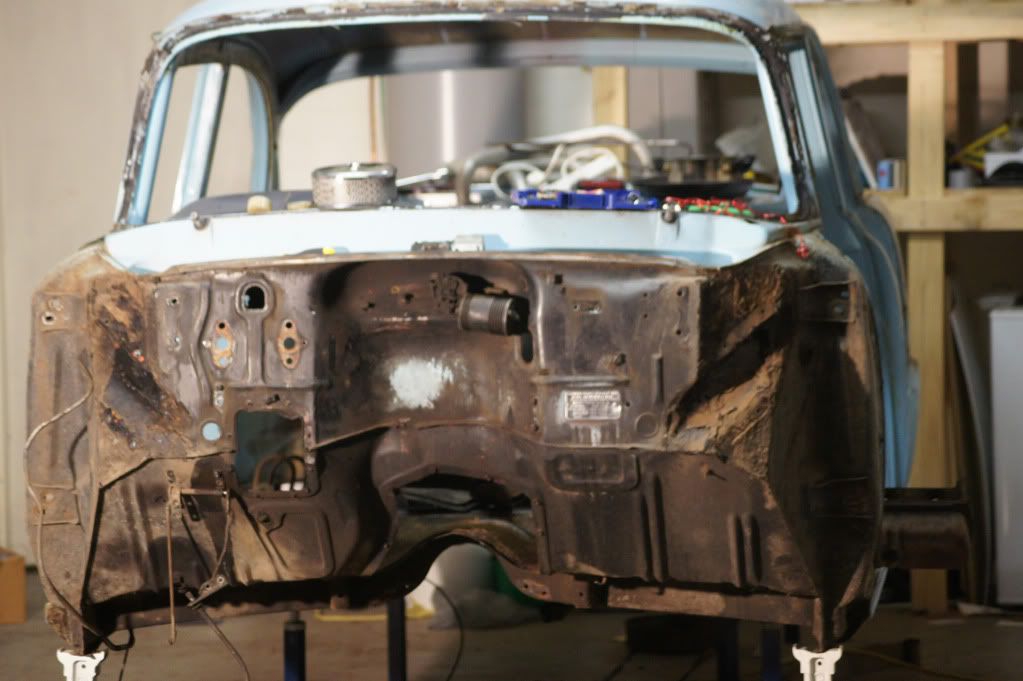

Havent had much time in the garage the last few weeks, but I finally got back in there tonight. Got the front subframe off only to discover a number of small rust holes which I am sure that upon closer inspection and poking will become large rust holes.
Also got the diff seperated from the rear leaves and the passenger side leaves out. Tried to remover the fuel tank but the screws were rusted and the heads basically shattered as soon as I took to them with the screwdriver. I will have to attack them some other way, but by that stage I had had enough. I am not on a deadline.
Basically the fuel tank, RHS Leaves, fuel line and brake line and that is it, then I gotta start fixing stuff.
Let the games begin!

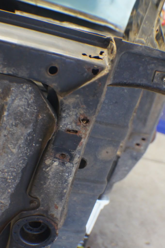

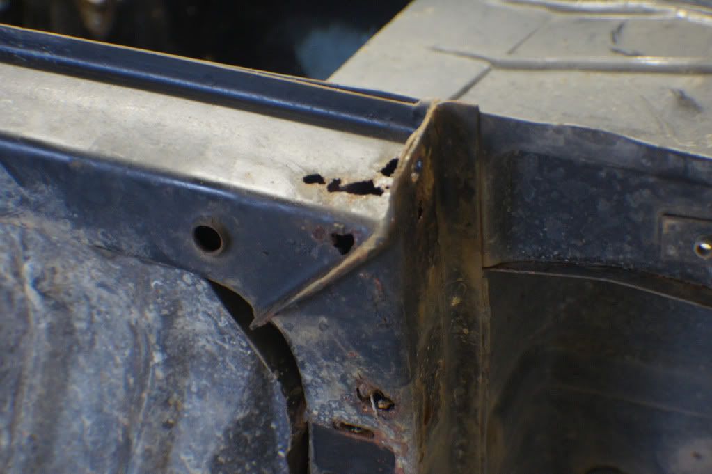

I should have known better than to poke stuff with a screw driver. Damn Damn Damn

BB it is better to find it now rather than after it is back together and painted. It is a reasonably common spot for rust, one of the front clips I had was virtually non existant in the same area but I couldn't see it because it was covered over with paint......I nearly used that frontend on Sue's EK
...... lucky I poked around with a screwdriver
At least when you have fixed it you know it will be 100% and as Scotty said it good for your peace of mind. Keep up the great work.

Yep,
Rust from the inside. That part is the the thinnest from the stamping because it has been stretched to make the shape.
Pitty the technology of rustproofing wasn't an option to car builders of the day. Actually its a relative easy part to repair because the shape holds itself while your welding it. Cut it all out and replace with new and there will be no looking back.
Keep the pictures coming !
