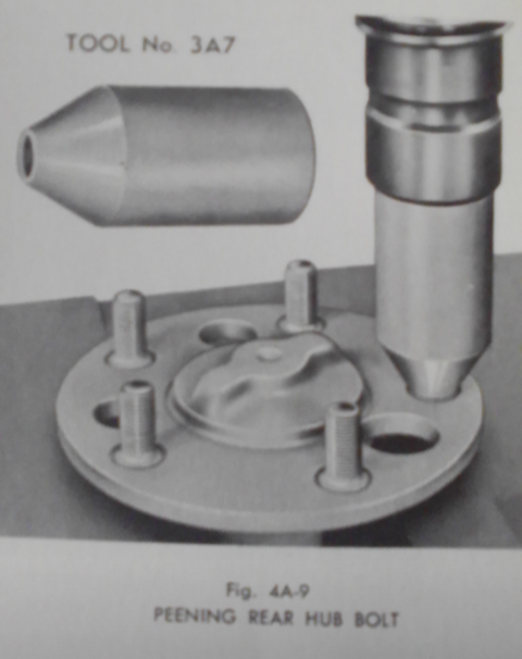

Noticed one of the front hub wheel studs is loose, rocking back and forward slightly. I replaced these when I fitted new rotors to the sedan back in ‘93. Thinking to put couple small tacks with the mig. I will see if any others are loose. If so may have to source some over size studs, unless I could shrink the holes on the anvil maybe.

I don't like the idea of welding stud to hub.
There's Tool No. 3A-Whatever: Stud Peening Drift, which looks like a heavy-duty wad punch. Wad punch. There's an idea. Otherwise I was going to suggest grinding a centre-punch into a D-section, and peening the knurled shoulder of the wheel stud.
Posted: Wed May 05, 2021 11:08 am
More just adding tiny amount of weld to hub Rob but yeah thanks.
