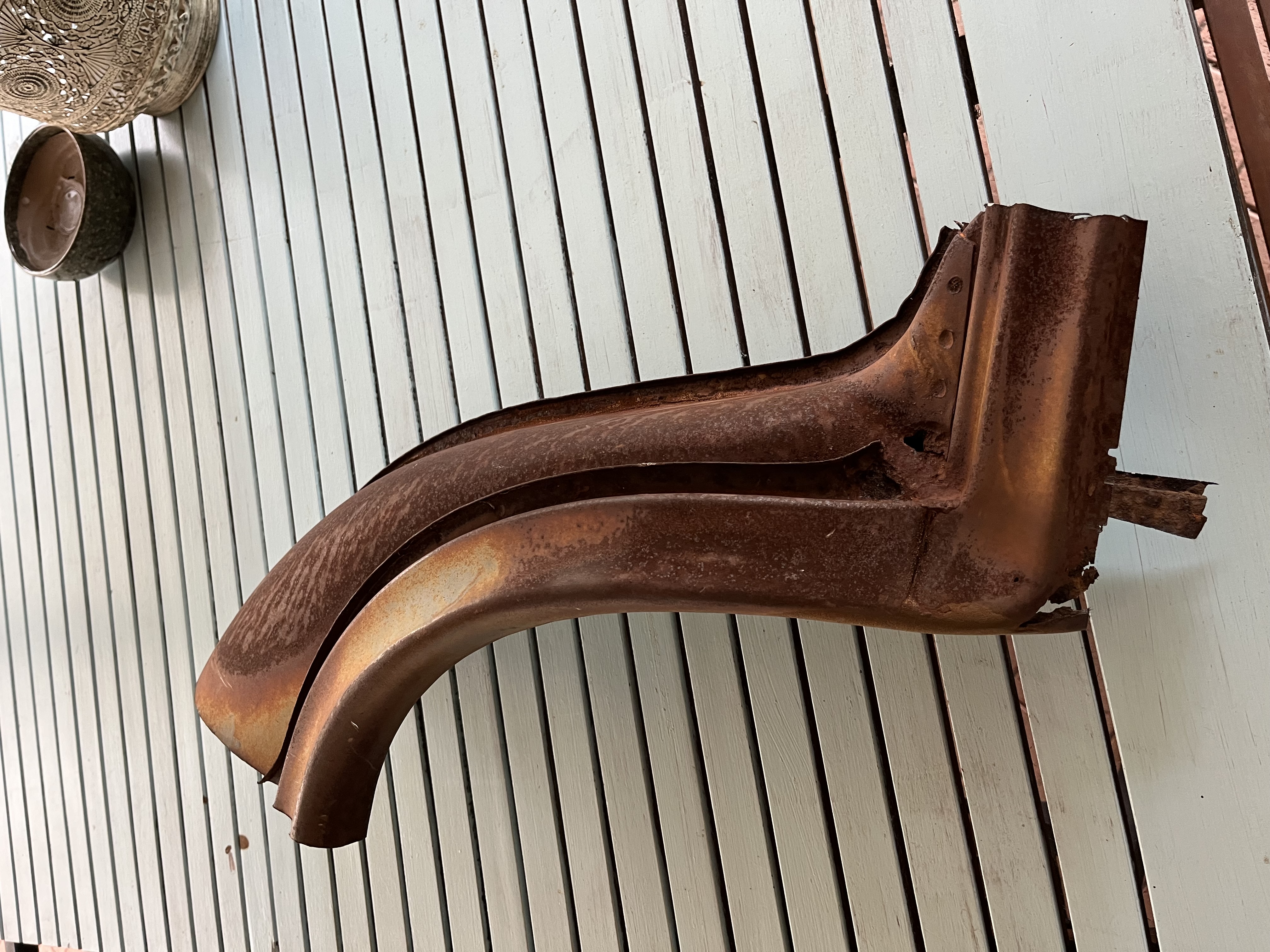

So I’m resigned to the fact that my supercharged dream is over :thumbsdown: :thumbsdown: so I’m going to puta cam package in the engine I have, some VR heads to lift the compression and I can almost be at the same kw as Franks engine and the L67 I wanted.
Finishing the last two floor repairs today, big step, finish dog legs then it’s time to deal with the roof I suppose :lol: :lol: :lol: when’s the nationals :roll: :lol: :lol: :lol:
Re: Neil's FB Station Wagon
Posted: Sun May 12, 2024 10:40 am
by FireKraka
Cut from the donor for the drivers side, going to my company workshop to get blasted tomorrow
Posted: Sun May 12, 2024 10:41 am
by FireKraka
Trim it down a bit more before fitting.
