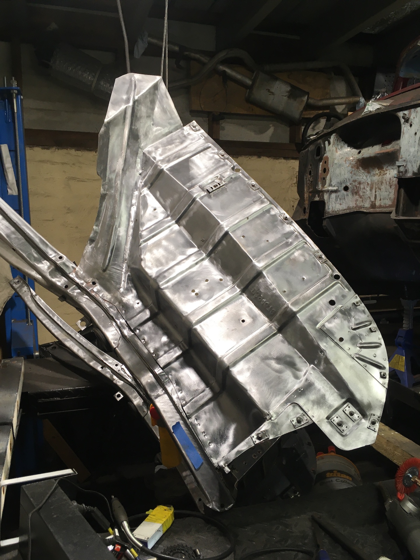

So working my way round the subframe and came to this. The first wing I repaired.
Thems some blobbing bits I just had to get rid of. Hour and a bit of grinding and welding some holes.
Now it matches the other side.

Re: Ol' Rusty - FB/EK Sedan
Project bell curve Scott. You make a start but then skills and expectations increase. When you get near the conclusion you start cutting corners to get it finished. Well that’s my experience. Anyway it looks bloody perfect mate.

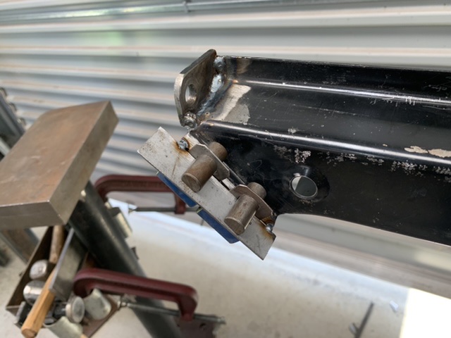

I know what you mean about the bolt holes on the tie member…
This ends just got cut off on mine and I welded some 3 mm plate on to match the correct width of the side sub frame, even got the holes in the right spot.
Had to also extend the tabs as I fabricated my side sine frames, had to make it all match up but it was a good result in the end.

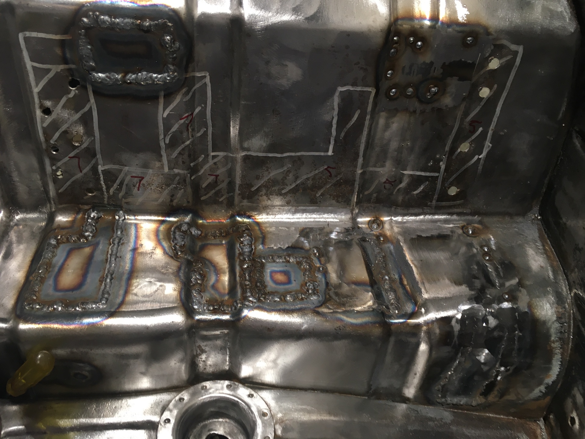

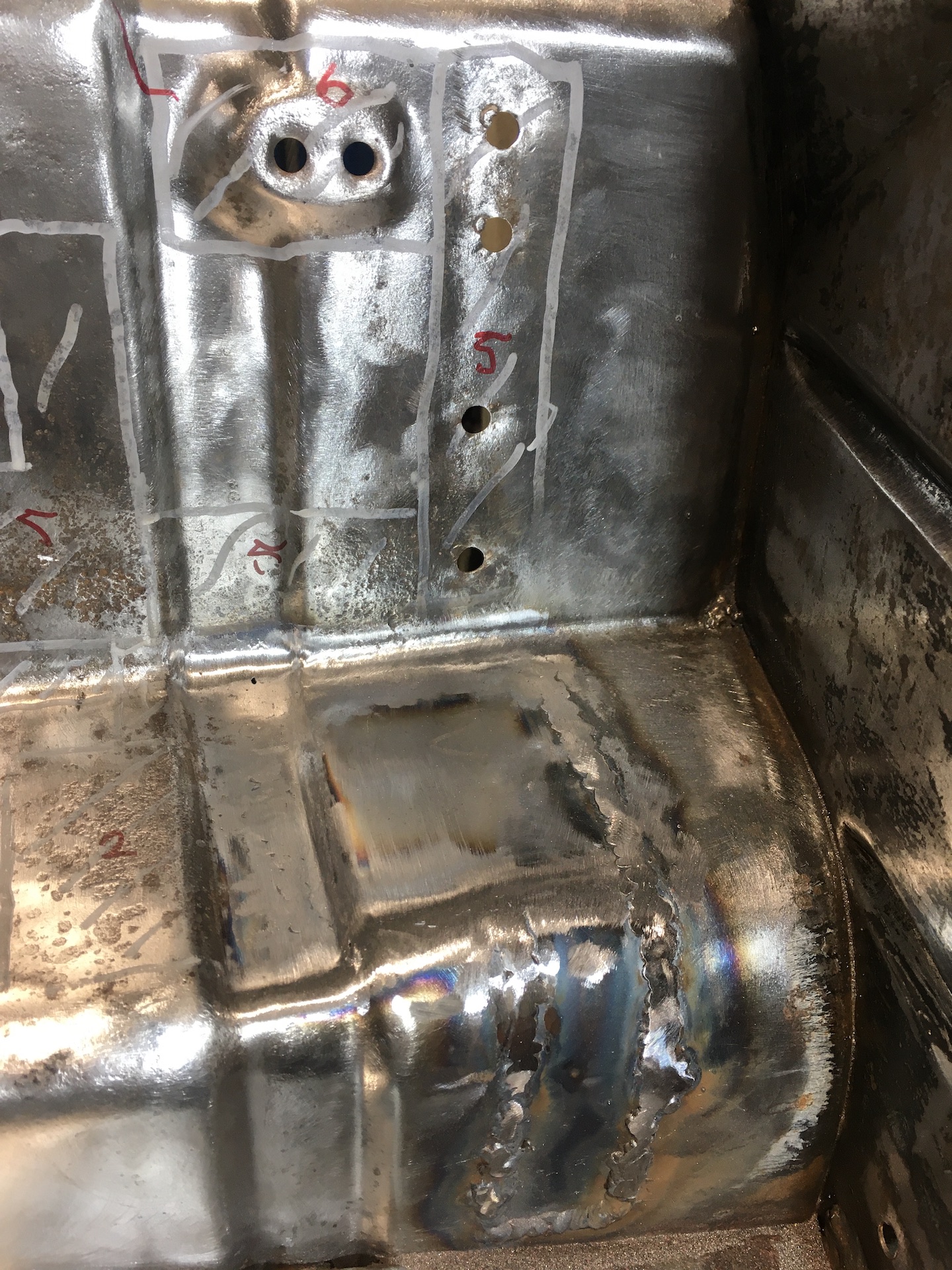

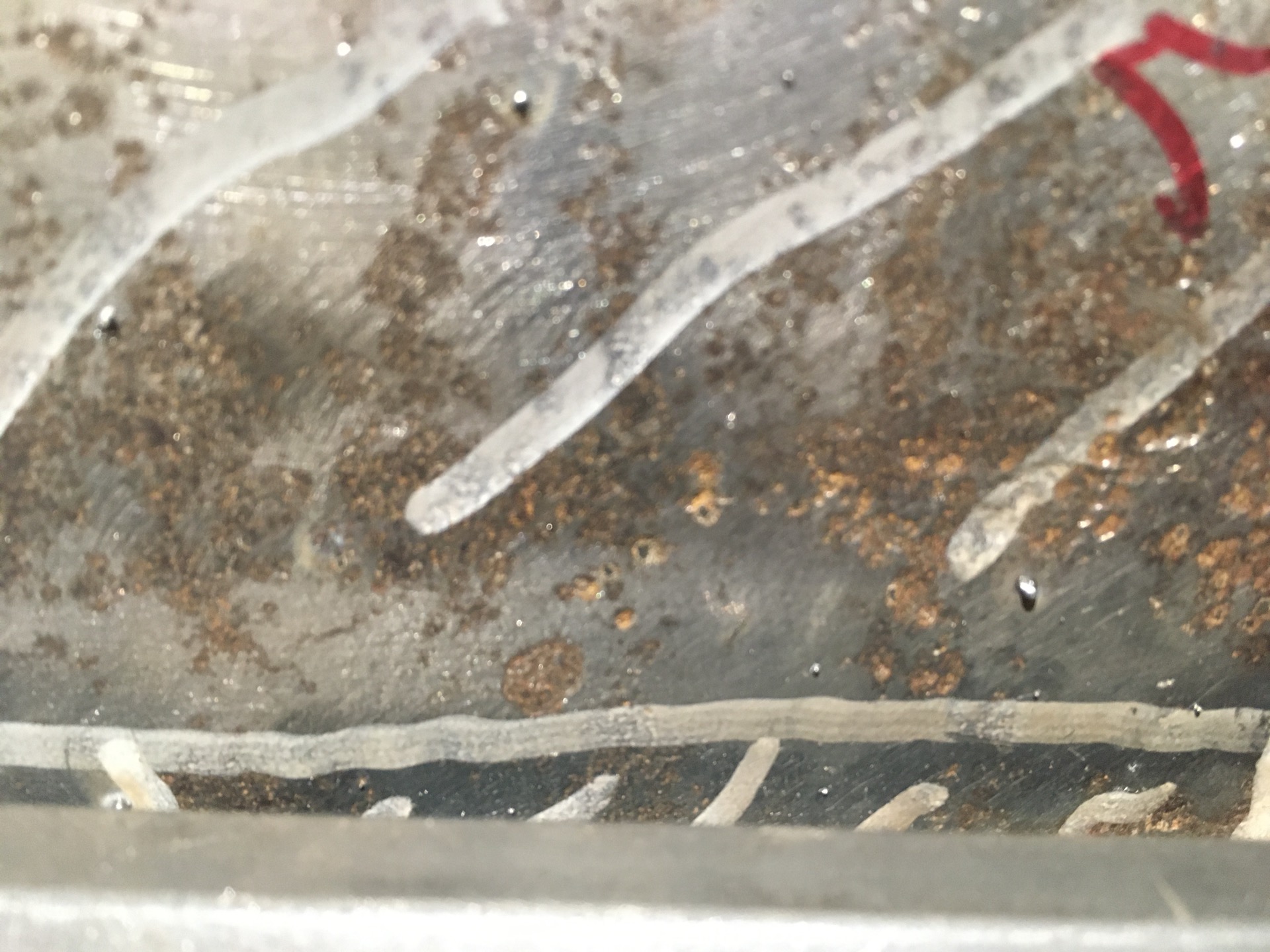

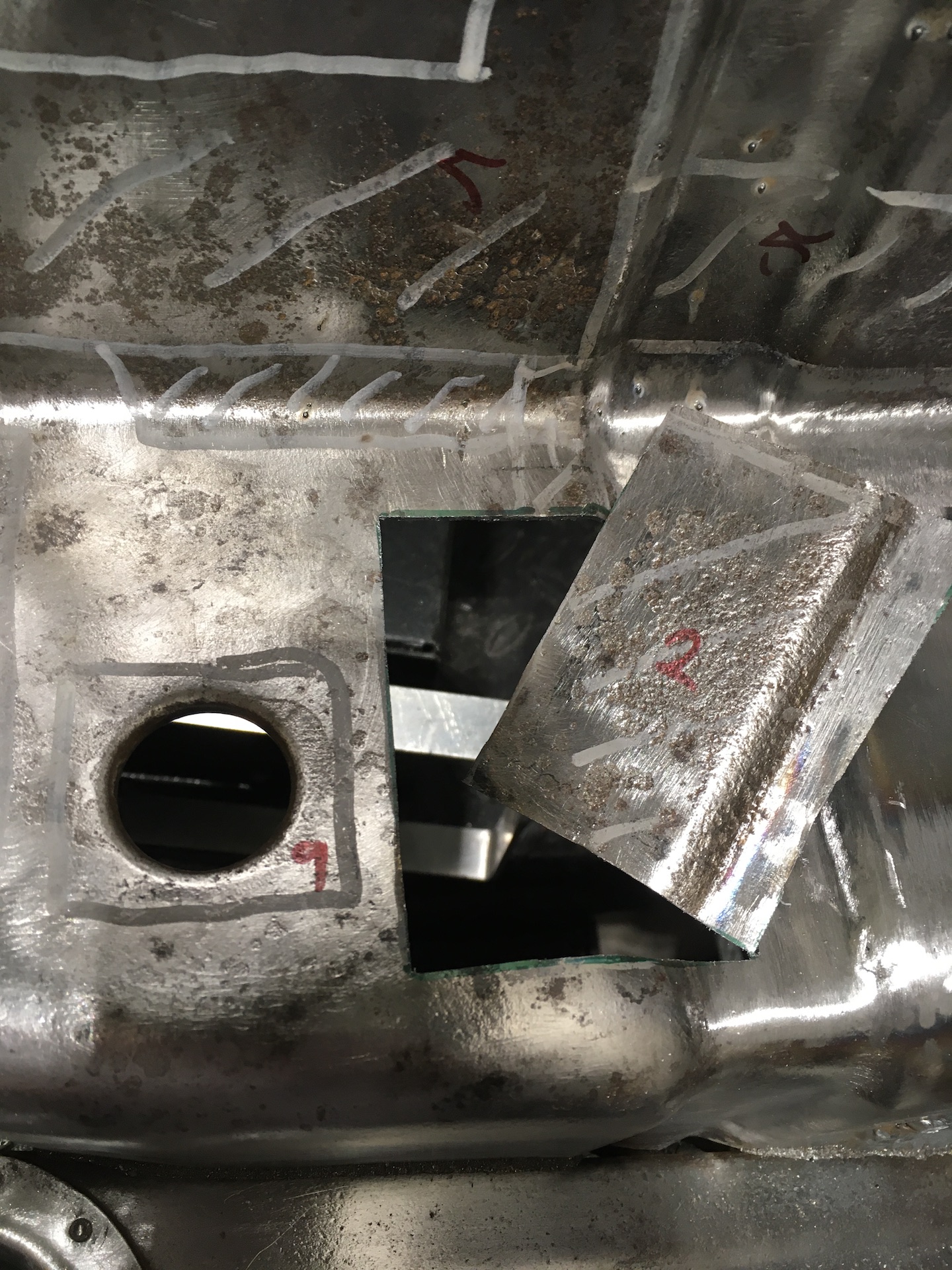

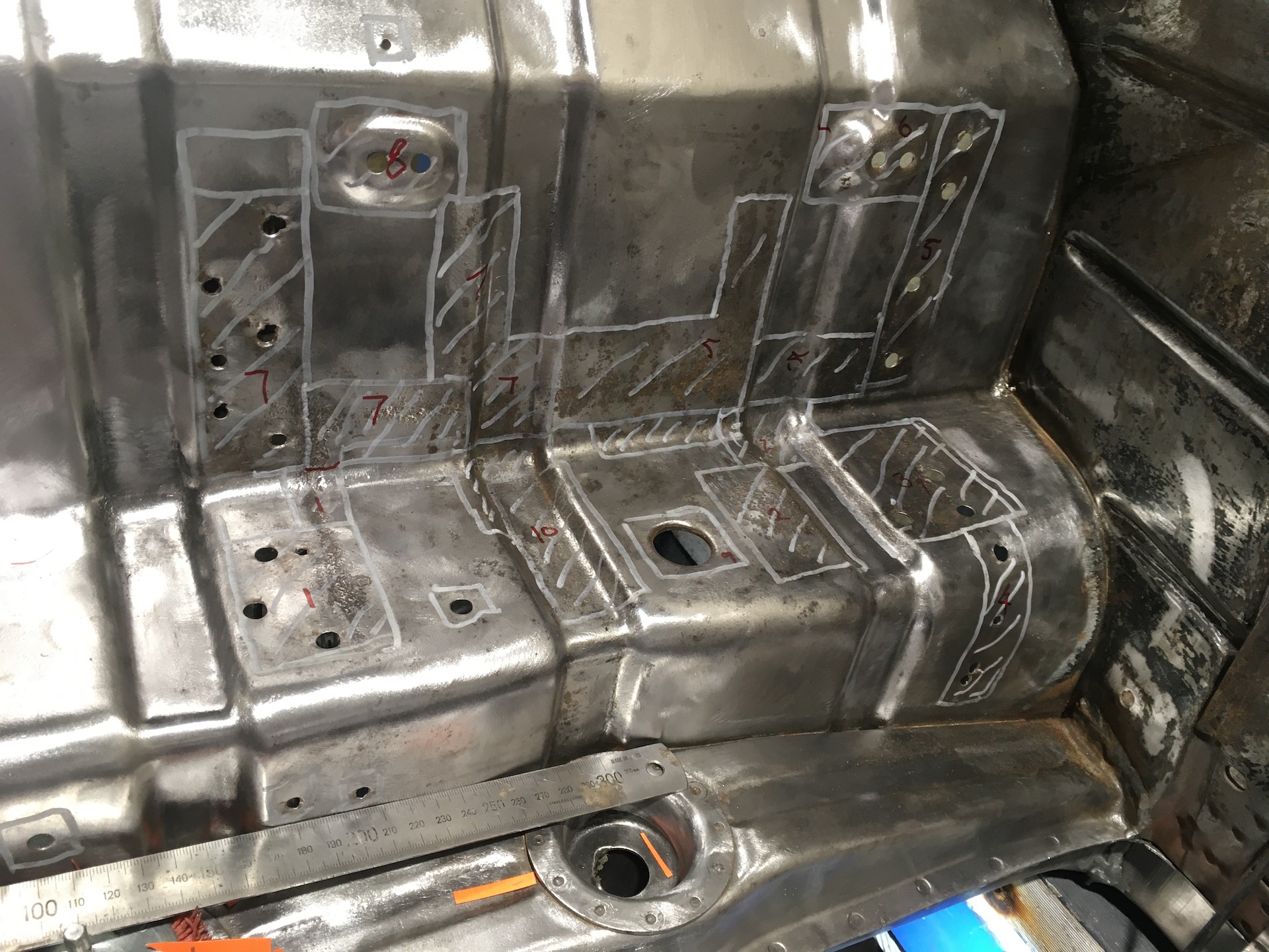

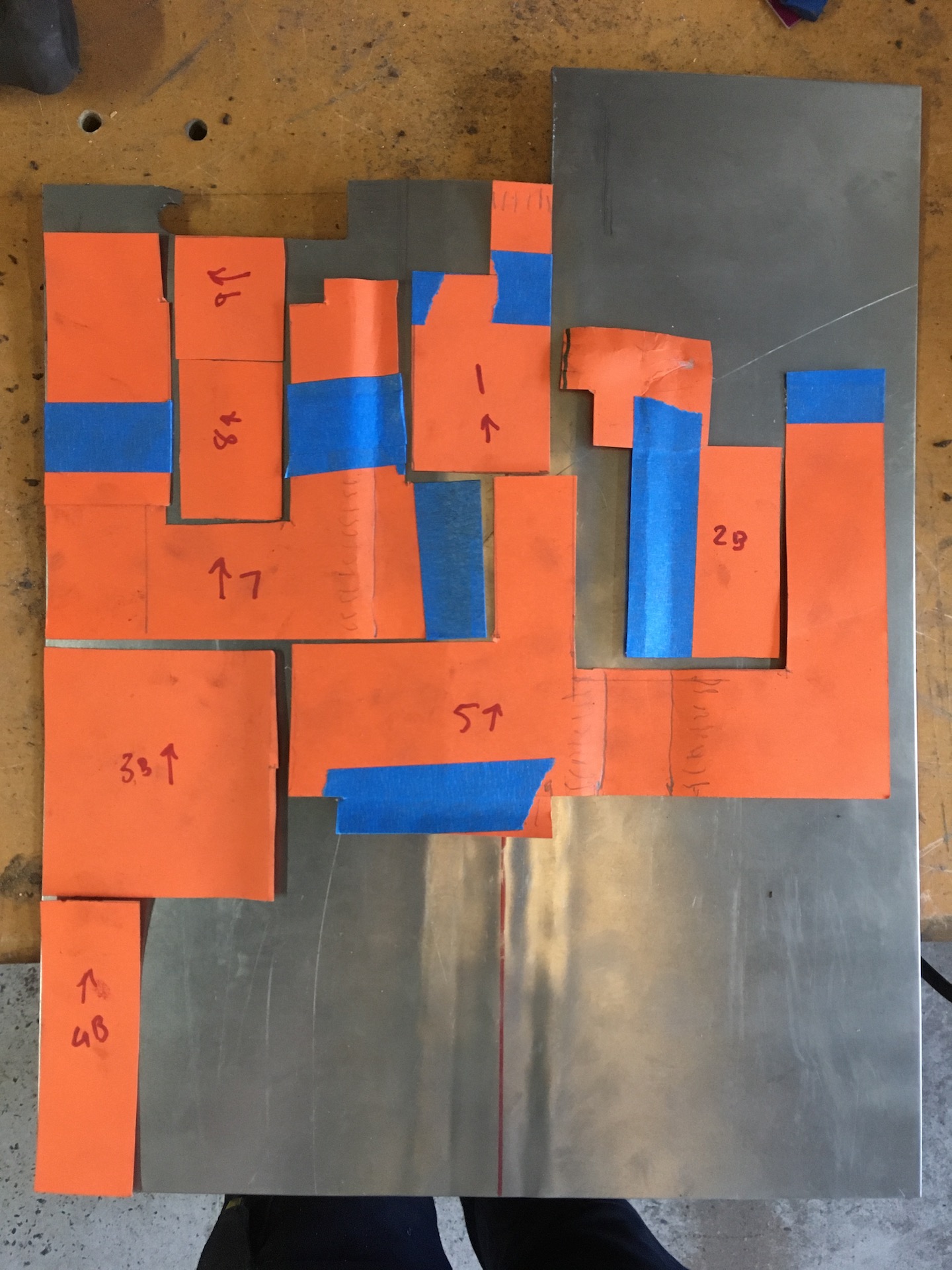

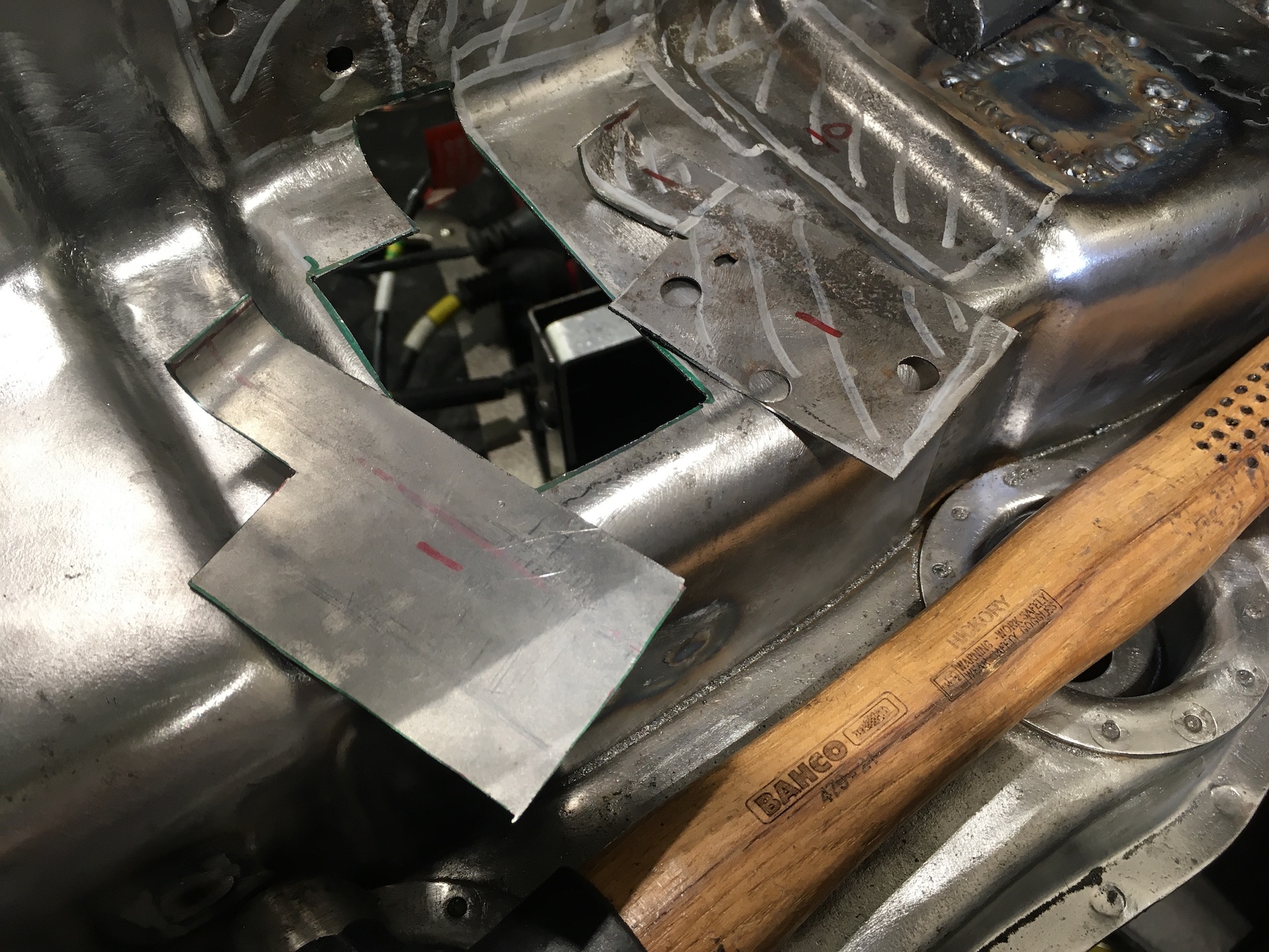

Still working my way round the sub frame getting back to bare metal with the wire (nylon) wheel.
Filled all the holes on the drivers side with weld. Then procrastinated for a bit with the area around the battery on the passenger side. There is a number of drill holes, and pitting around where I guess the battery tray would have been.
8956 It’s not the worst but I can see it starting to show on the other side in places.
There is also a drain hole and indents on the side for the battery that I wanted to delete. Figured I could never make such a complex shape, so I broke it down into many smaller challenges.
Played a game of tetris Started forming and fitting. 1 piece at a time. Welding is a bit rough and now being punished as all that weld has to come back off with the grinder. The grinder gods punished me by seizing the bearing on my powerfile. Replacement from locked down Bunnings took a few day to sort.
Doing all the easy ones first About half way there for forming and welding. Then a day on the grinder to finish.

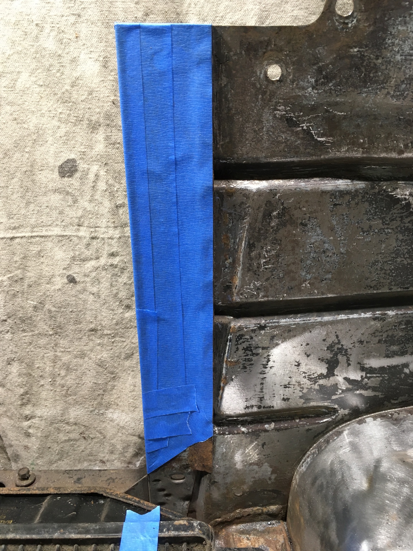

Whilst I’m welding away I have been thinking about the area around the radiator. When the larger radiator was installed with the 202, it looks like they hammered a metal flange over on both sides (I guess that helped position the original radiator and gave the front sheetmetal some strength), to fit it flush. Blue tape on the radiator represents the area that is blocked by the front of the sub frame and gets no airflow.
Many trips down the Hume to Melbourne and back, and I can only recall once running the heater in the middle of a scorcher with all the windows down trying to keep temps in check! Seems stupid to leave it as is. So closer pic is the area I would be looking to delete.
Any issues that I should be looking to address here? Cutting out all this metal will lose the folded double layer that the original radiator bolted to. I was thinking of adding an extra layer of metal where this radiator is bolted through.
Scott
I guess its too late now but you could have saved yourself a swag of work if you had of cut a strip out of the inner guard and taken it to a sheetmetal shop and got them to press you up a sheet big enough to cut 2 big patches and welded them in rather than all those little ones
A strip of flat bar tacked down either side of the new larger radiator hole should do the job
