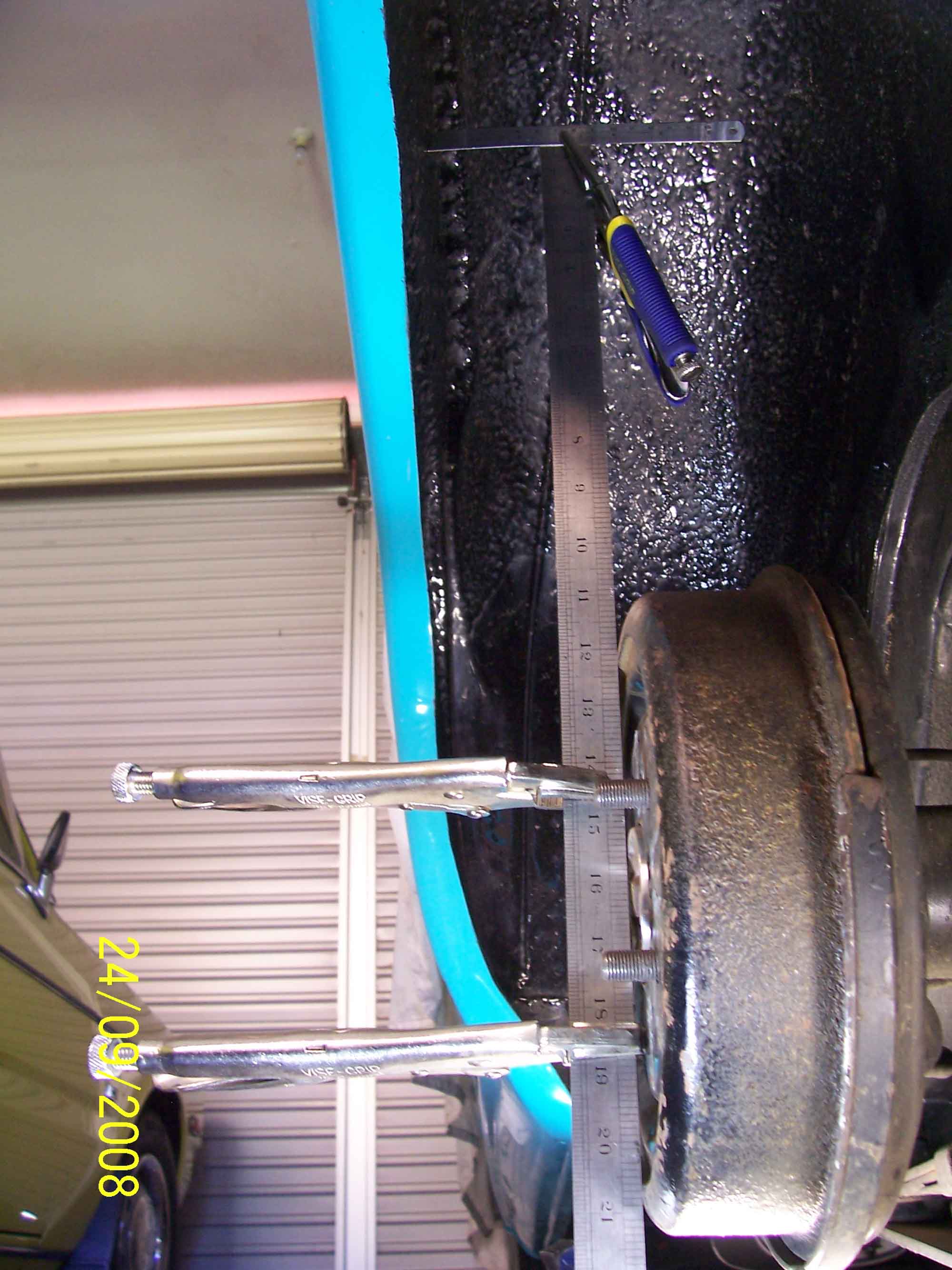

I don't know whether I put this up before, I have posted it in the past week - but it may have been on another forum.
I fitted 14 x7 Dragways to mine.... had them made up especially by Ray Dunn of Dragway, Kinglake Vic.
I spent quite some time with straight edges and rulers and a borrowed 6"x14" wheel from Dragway before deciding on the 7" rim.
I have an EH diff which is pretty much centre as far as the left and right wheel arches are concerned.

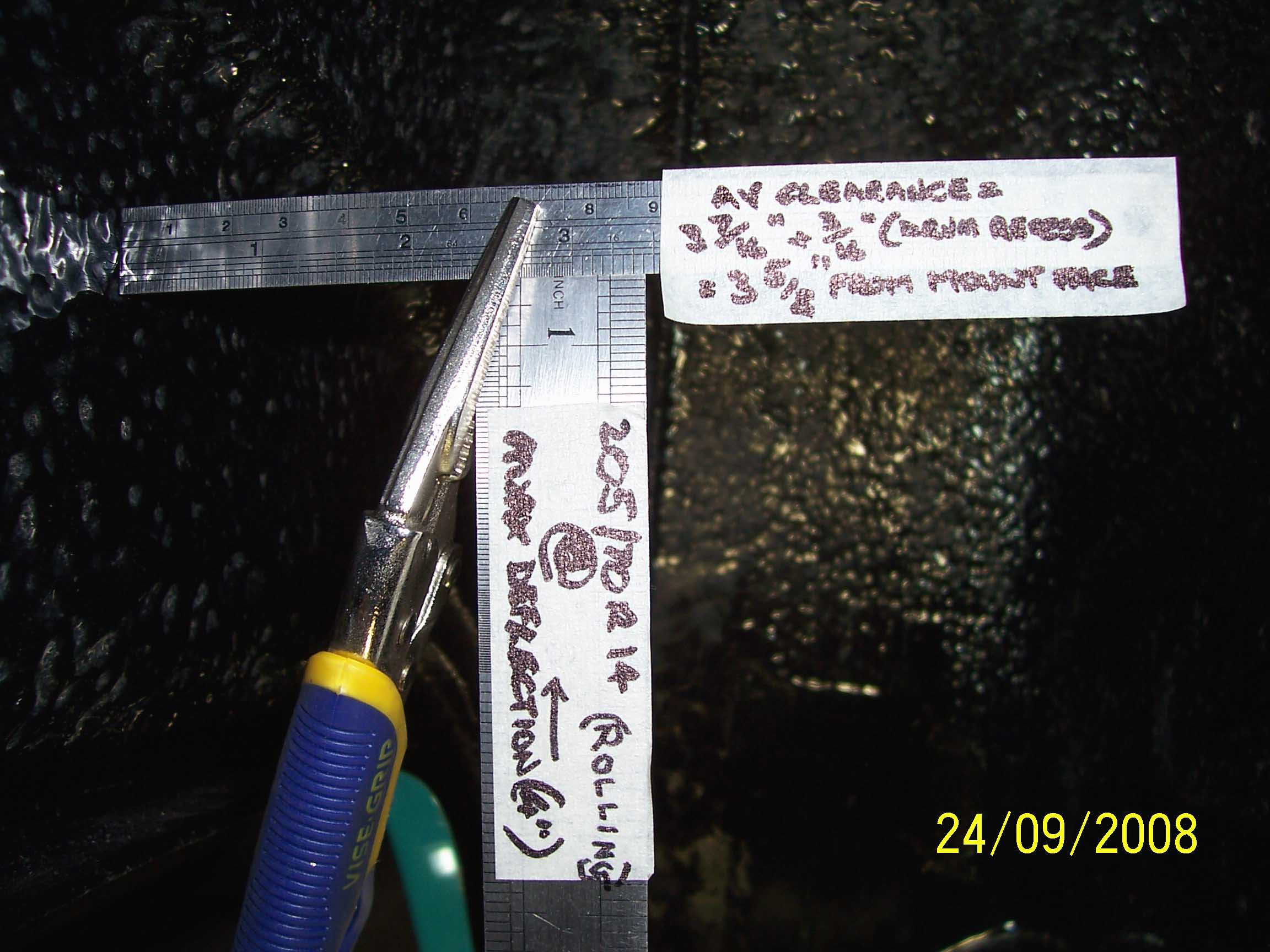

My measurements resulted in me finding that I had 3 5/8" clearance from the brake drum face to the average point of the outer wheel arch inner skin.
These two pix show my measurements... one with wheel and texta written measurements not legible.. the second with on the markings...
Pix -
I still had rub issues when hitting dips in the road at speed... I fitted deeper bump stops to the over-riders which lifted the vehicle a little, but added much more tension in the over-rider springs... it was only on the odd occasion that there was any further scrubbing heard from the rear.
The issue I found with 7" rims - was not so much the back, but the front. If you set the offset for the rears to keep inside the outer arch - you will find that you will foul the upper ball joint on the front... if you have a ball joint front end. If not, I can't say whether there will be an issue with a king-pin front end, because I don't have one.
I took around 80 pix of all these measurements before Ray and I decided that I could have the 7" rims.. I would seriously suggest making absolutely certain that 14" x 8" rims were going to fit your application - they most certainly would not have fitted mine... EH rear axle, HD ball joint front.

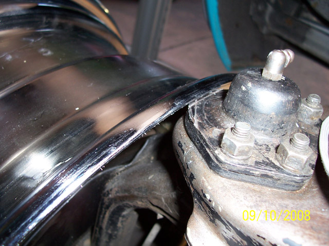

This final pic is of the 14 x 8 with 205/70 14's... vehicle is sitting on axle using stands.... this is unladen ride height.
This is the same wheel at the front - you can see how close the rim is to the upper ball joint body...
it does clear the ball joint body, and also the wheel weights - as mentioned, I don't know how this will be with a king pin front end - if that is what you are using.
This pic is the 14 x 7" rim and how close it gets to the tie-rod end... I believe tyres would be an issue with 13" x 7" rim.
Pix -

Ok, took me a while... didn't pick up on it reading the above threads.... you are running early Torrie rear axle.. that will give you greater clearance out to the wheel arches....
Just check though - unless you run different wheels front and rear - your 14 x 8's may foul the upper king pin...... or the tyres will foul the tie-rod end.
