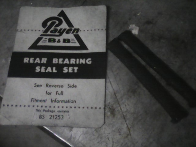

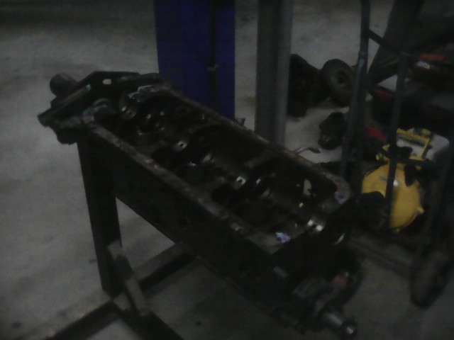

Anyway block stripped so I can replace the rear main. I am sacrificing to the gods my last asbestos rope seal. I was going to save it but now my hand is forced as these graphite seals don't cut it. After that I'll be looking at working a conversion to lip seal if the rope seal leaks again. Had enough of pulling engines down for oil leaks!

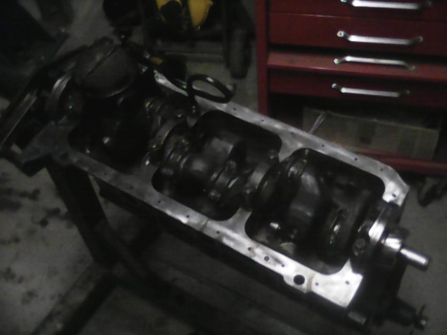

Smashing it back together now. Did some relief work on the oil drain hole in the rear main cap so it'll get a bit better drainage but not too much in that it exposes the rear seal to excess oil splash from the crankcase.
Set rear main seal (crank in and out 4 times to get it right).
Lunch break.
Re: Seagull Grey EK 2106
Posted: Tue Jun 20, 2017 6:30 pm
by Craig Allardyce

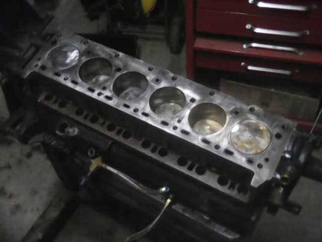

Crank and pistons in. Side note all bores measured up well. Wrote a letter to the mob who built the head, don't think I'll hear anything from them. Knock off.
Digging through all of my old gaskets and found some original rear main seals in a brown paper bag. Todays bonus!

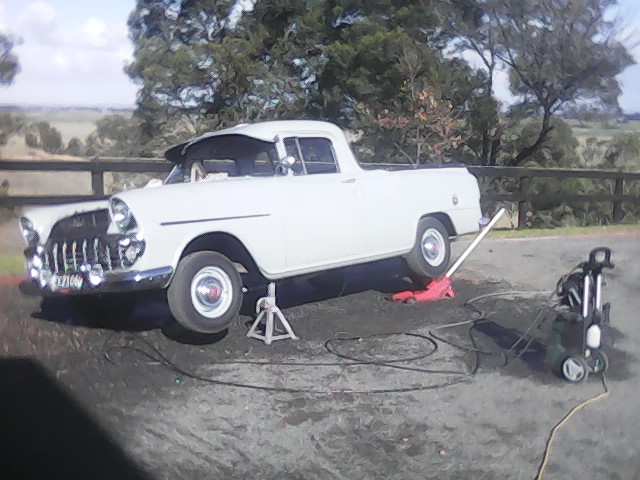

Cleaned bum of car after all the oil leakage.

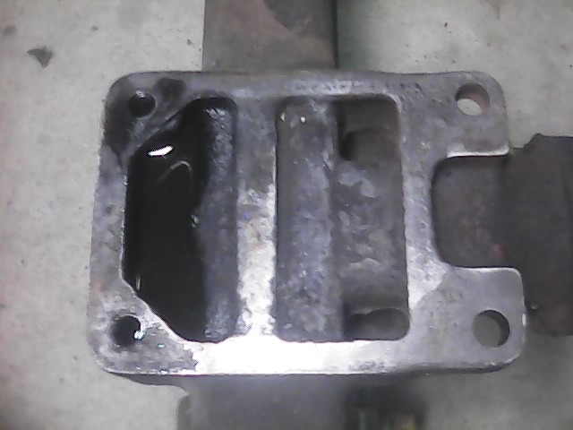

Checked manifold fit up as the gasket was a bit leaky. Tried to separate hot box to aid alignment and as usual some of the bolts broke even after heating with the torch. No dramas, remove broken bolts and re-thread. Another issue found, the hot box section around the inlet manifold was totally blocked. No wonder it was icing up in Tassie. Most of the work is done, just waiting on new valve guides for the head.

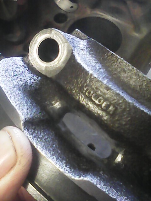

Ok a bit more today. Valve guides done but I've been scratching my head to find a way to chamfer the top edge of the valve guide. Chamfering mill tools are very expensive and no one seems to have heard of them out this way. Closest I can get is $124 for a deburring tool that might work. Some of the reviews were ordinary. So I ended up using a tube work deburring tool that is in my flaring kit. Pressed it into a large 3/4 drive socket and with a speed brace we're away. Got cocky and found a adapter for the cordless drill and managed to do all of them in 20 minutes. Lucky I think as the guides are cast iron. Not sure how the tool would go on anything harder. Next job to rework the coolant holes for the new revised head gasket.
Hoping to turn the key this weekend.

Posted: Fri Jul 14, 2017 8:43 pm
clever !! :thumbsup:
