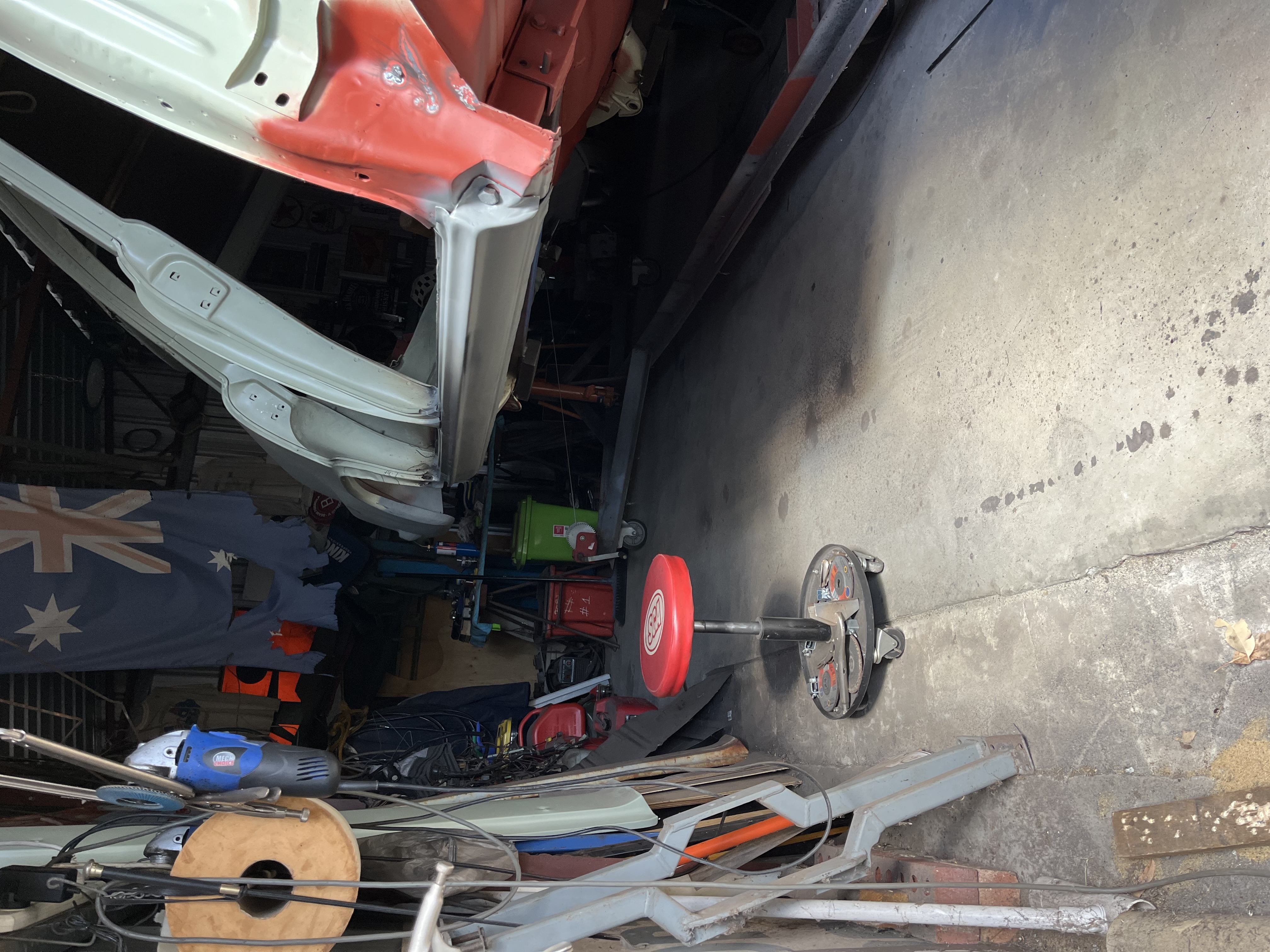

Finished the driver side sill
Have some issues in the bottom of the dog legs so going there next.

Slaying it ol boy.
Re: Neil's FB Station Wagon
Posted: Tue May 07, 2024 6:07 pm
by ardiesse
Well done, Neil.
The doglegs and inner rear wheel arches are about my least favourite repair. You might almost be better off raiding a donor shell for the complete outer section from rear door shutline (where there's a factory seam) to the sill. And we all know that straight, rust-free dogleg sections are there for the taking . . .
Does the cancer extend to behind the door seal retainer strip?
(For your reference, pages 22 and 23 of "Found Object". 1.2 mm sheet is the right thickness.)

The drivers side Dogleg I have from a donor from EK Mart, I did have the passenger side as well but I had forgotten that my passenger side needed work so gave the passenger side to another club member :wtf: :crazy: he actually needed a lot more than I did so I was happy to do it.
Drivers side is the worst but I think the seal strip is ok I'll post some photos when I get a chance and thanks for the reminder of where your part of the thread was Rob I will check it out again.
