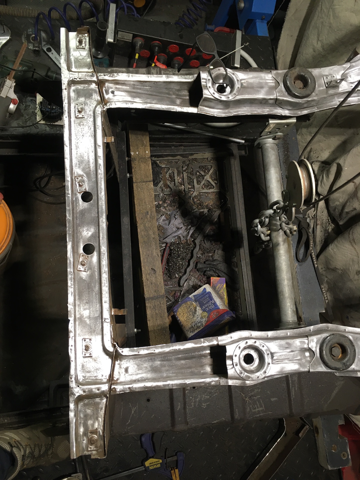

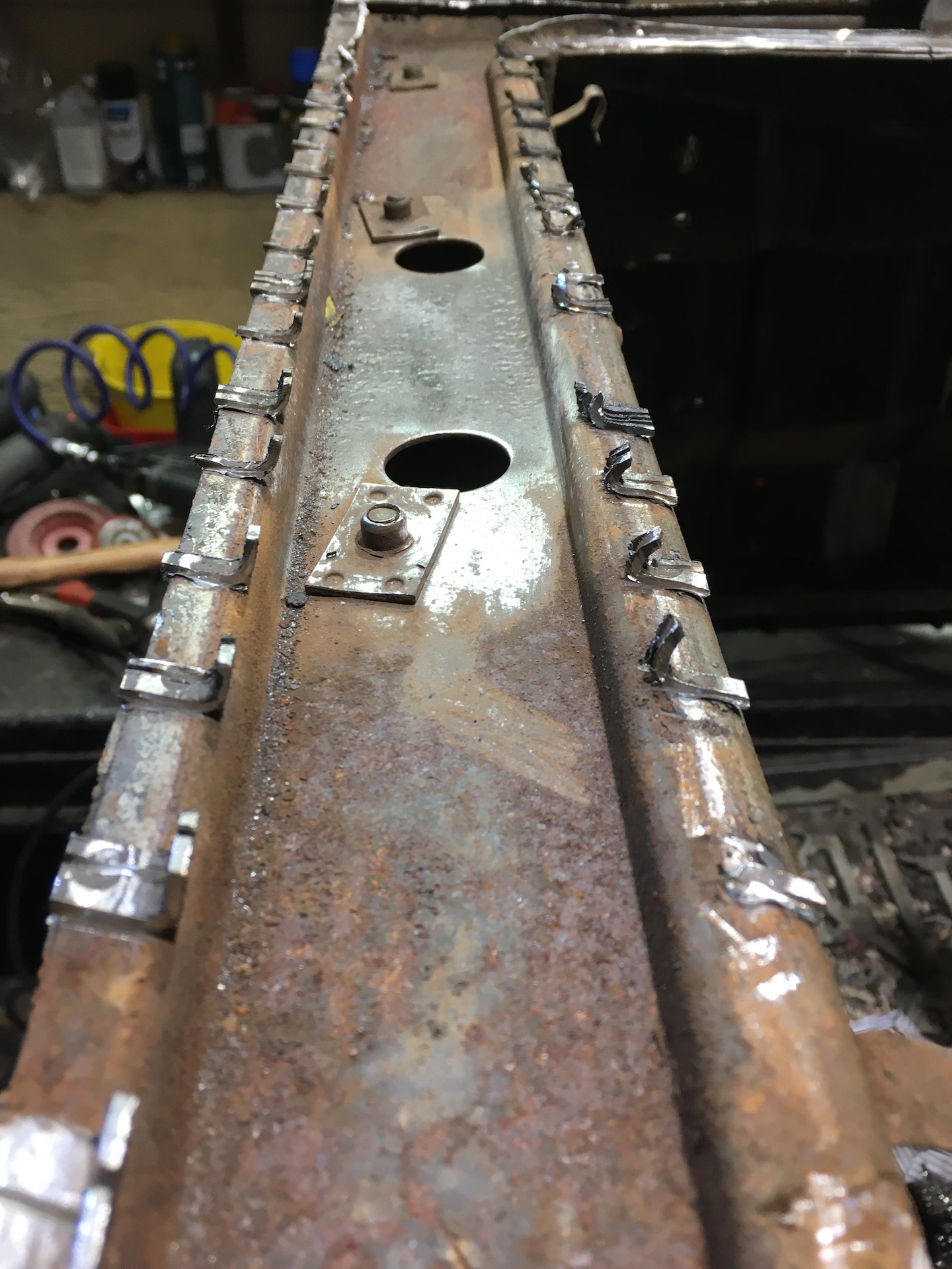

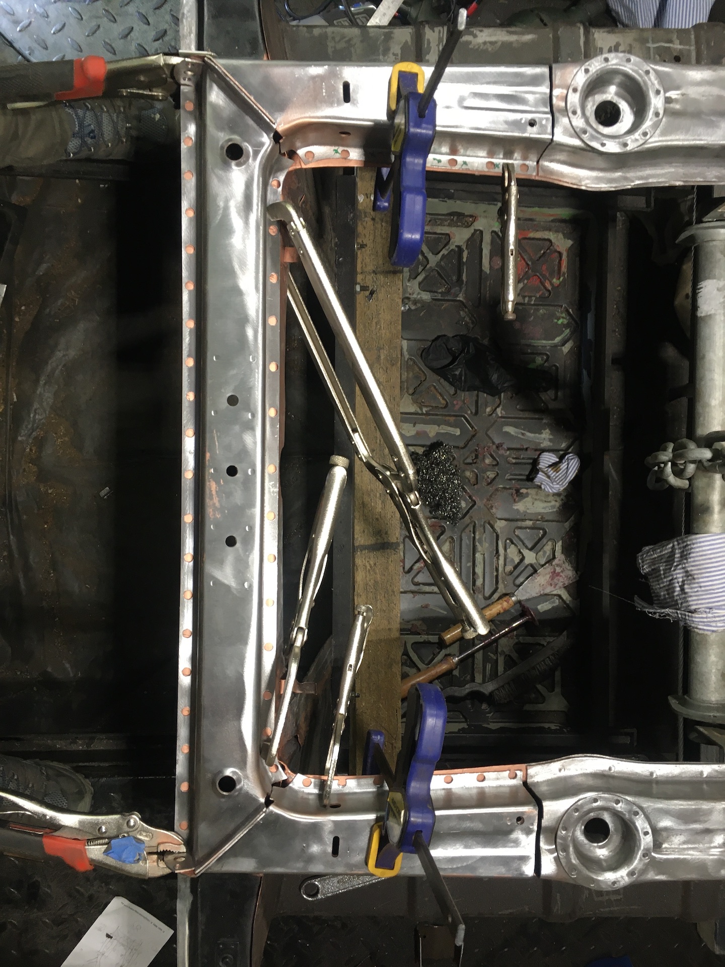

Cleaned up the top side of the frame.
Ran over all of the spot welds with the cutting disk and knocked out the metal in between with a cold chisel. Also did a quick test in the middle with a combination of power file followed up by wire wheel. Bit of pitting but solid.
Safety note #1 - When using angle grinder, make sure that you either 1./ wear a welding jacket, or 2./ face the grinder so the sparks are not slamming into you. Small fire on self extingushed with frantic hand slapping. Welding jacket put on. Action shot - stainless wire knocking the rust scale off the drivers side. Safety note #2 - Don’t let the wire come out the end of the area being cleaned. Always wear leather gloves. Attempting to catch the now 90 degree to the drill wire is fruitless and will further destroy the wire and give you a decent slap on the wrist for your trouble. Some time later, after flap disk (40 grit) on spot welds, power file (60 grit), and finally wire wheels.

It'll be better than new. Have you tried a good German steel spot weld drill and a pneumatic chisel? An unbeatable combination for that job. I pulled my whole K frame apart and then reassembled with different aprons and new bits in fairly quick time. Just watch out for the Spot weld drill - they can re-design a finger in a fraction of a second

Good work Scott,
That subframe looks real good now, another tick towards finishing !!!

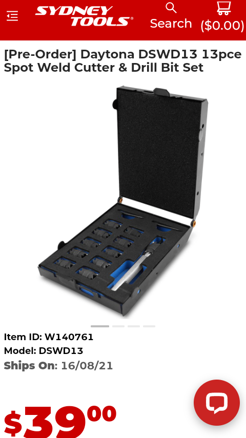

Hi Scott, I've been happy with the ones I got from Sydney Tools (11 double sided heads - from memory I just used one for that whole front section)

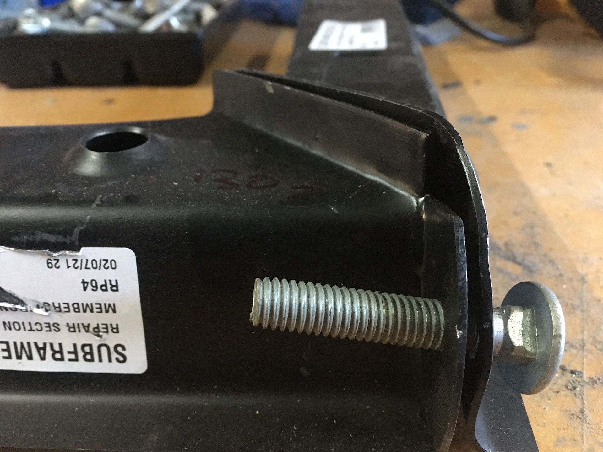

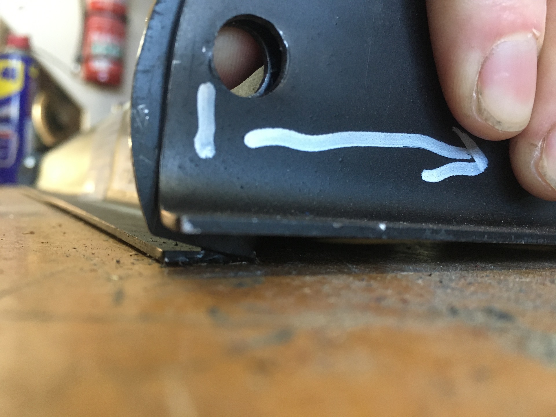

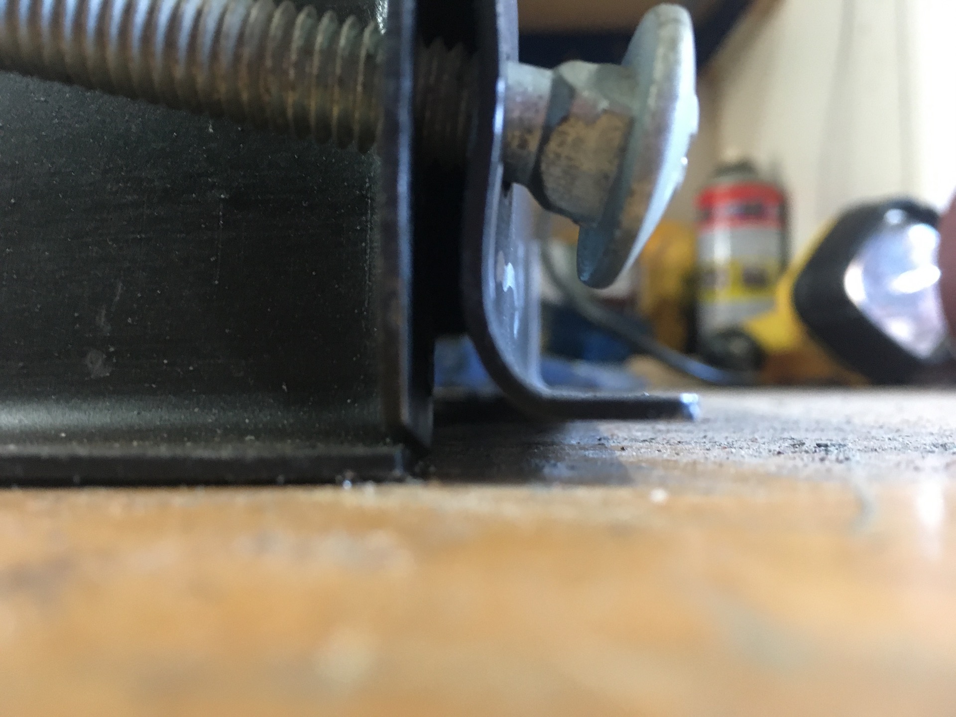

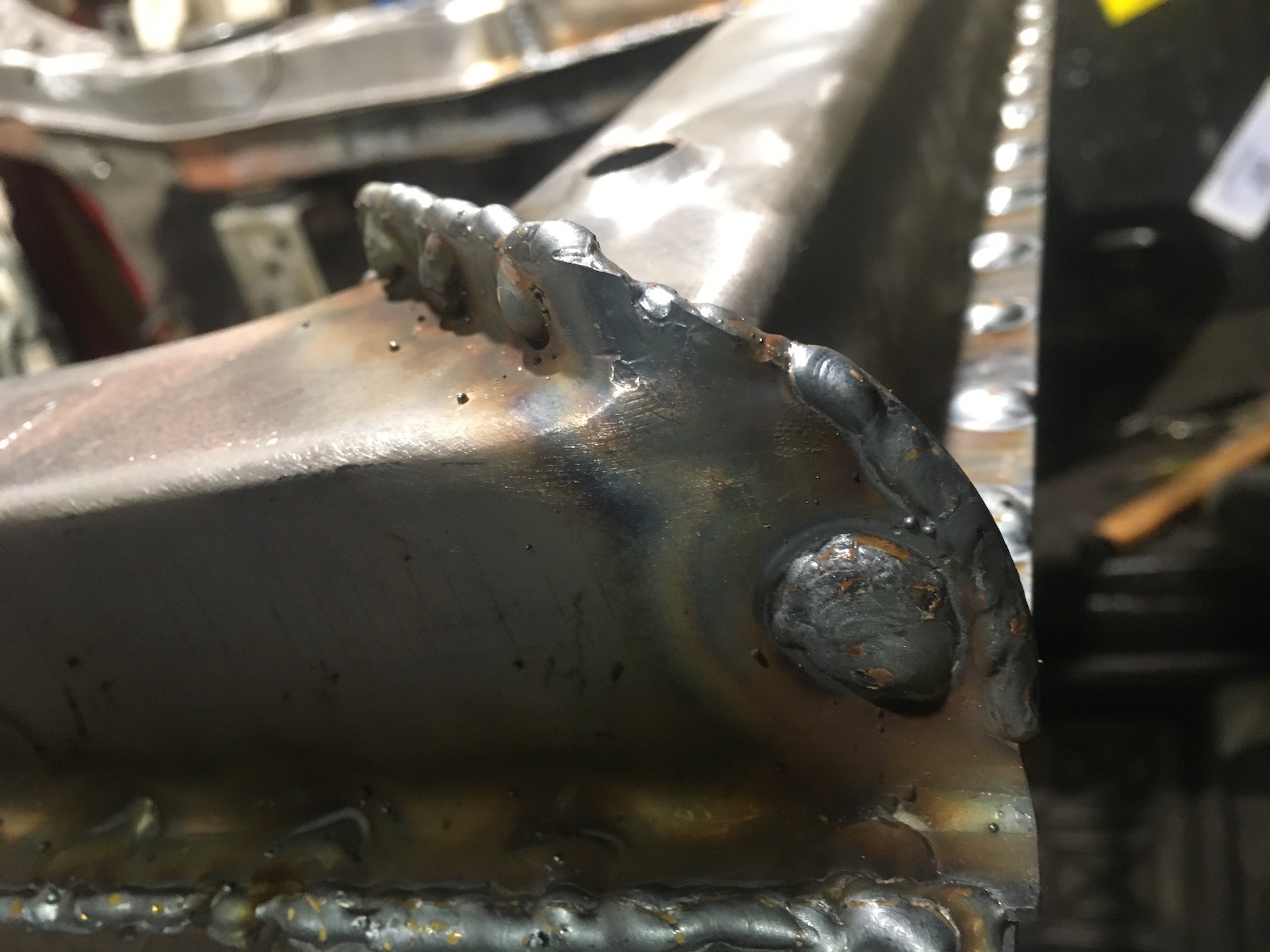

So the joy of the Rares Repair sections was short lived. If I line up the bolt hole, the bottom (as it appears on the bench in the photo) folded section that will be plug welded does not sit flush. Same on both sides.
My thinking is to line up flush (well I have to ) and weld and re drill the bolt hole.
Also, do I plug weld these folded tabs at the top? Previous repair was stitched together. Don’t think that would have had much strength. Figured I’d plug weld, and as its off the frame, flip it and stitch inside. Probably overkill but got the wire and gas.
And now after reading how Drew fitted the subframe before welding in the front tie member, is it crazy talk to do it off the car. At the moment the legs are clamped to a 50mm angle section, with 25mm packers on the inner legs. Did this before I started cutting and nothing has moved (famous last words).

I would think as long as its clamped down straight it will be fine - they aren't the stiffest things in the world when they are off the car so they have a fair amount of give when refitting
Bloody Rare Spares - I can't understand why if you are going to go to the trouble of getting parts remade why not get them made the right shape ????? Do they have no quality control at all ?????

Its not great that the parts don't fit, but I reckon you would have a good chance of getting them to fix the issue. Takes some input from end users (like us) though to help.
In the past, I've fixed ill-fitting Rares bits through contact with Les McVeigh (sadly passed away) and Dave Ryan (great bloke, but no longer a Director) and Lance Corby (now the Managing Director).
If you are game to help make the change, I can try to hunt down a contact with Lance? Been a while since I last spoke to him (from memory it was the drillings on the crashbox input shaft that we fixed) but willing to give it a go.
Re: Ol' Rusty - FB/EK Sedan
Scott,
Bolt holes in the Rare Spares repair sections are for indicative purposes only, I've discovered. They always need to be shifted, and that's where Mister MIG, the grinder, and a drill come in very handy. Let's not forget the round file either.

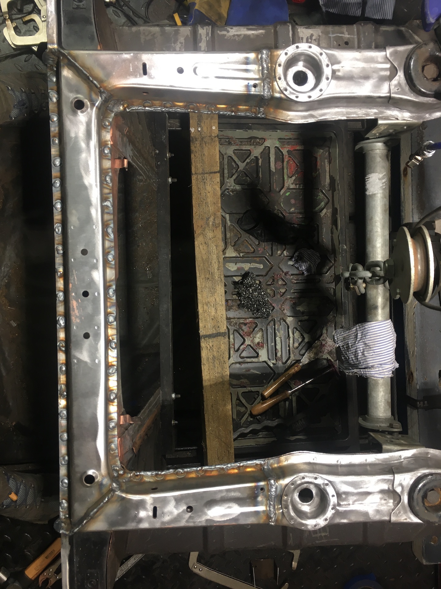

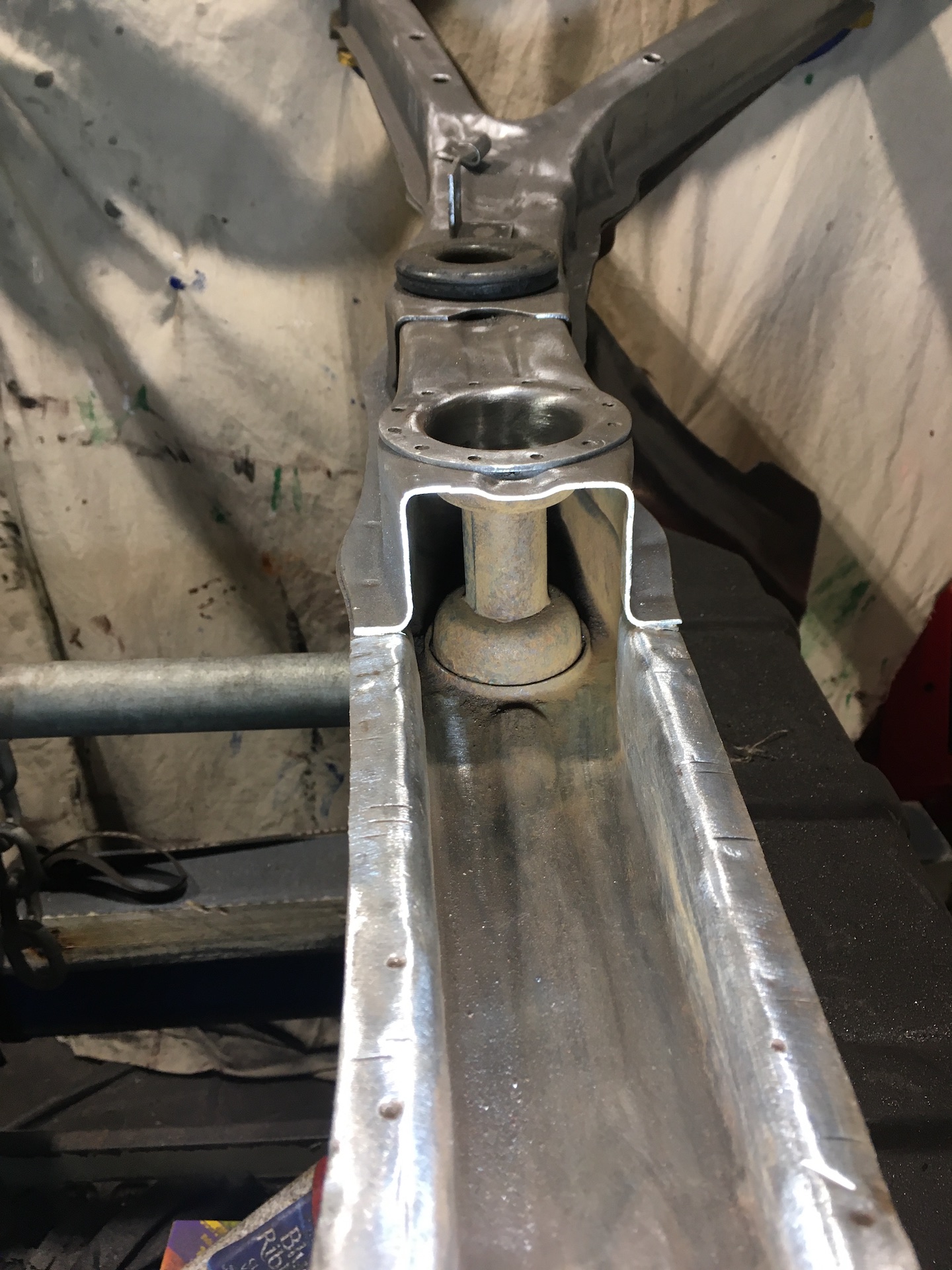

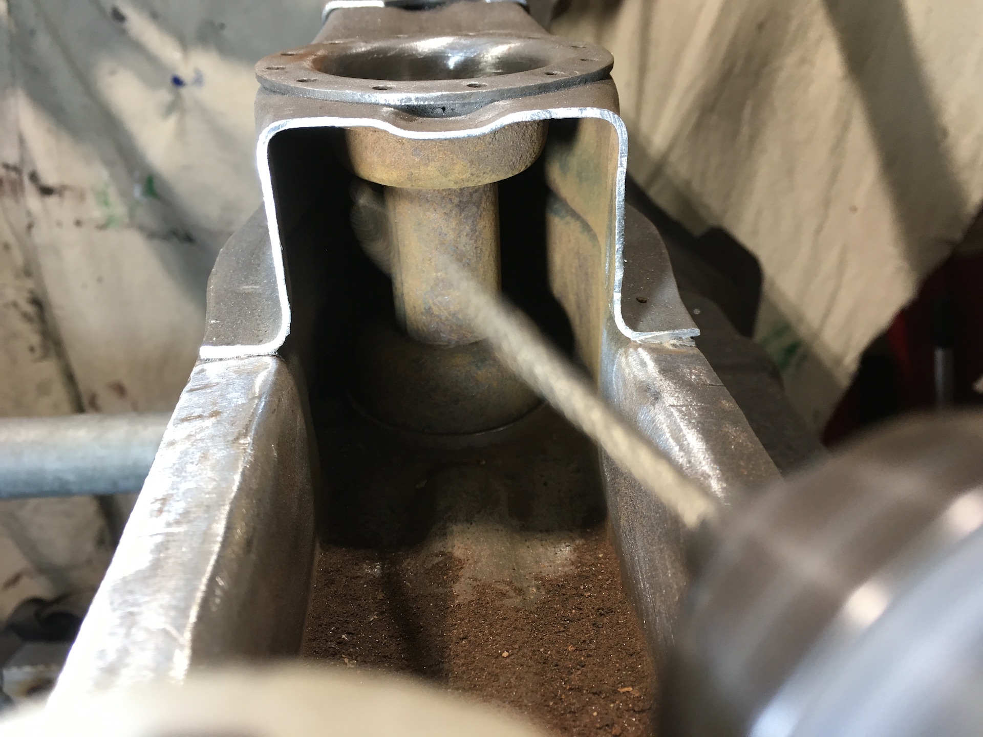

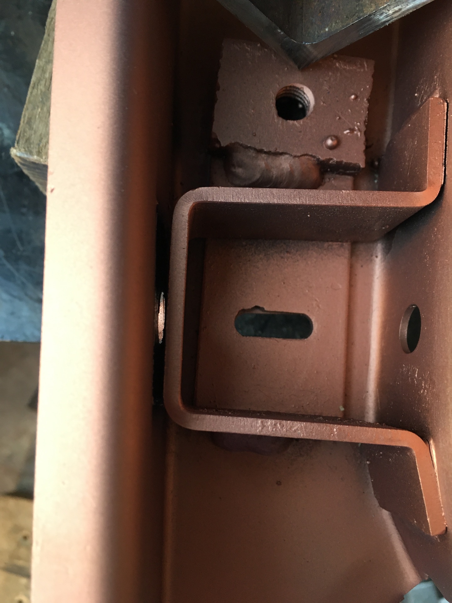

Spent some time running cavity wax up inside the frame while the front was off. Also did all the legs. The cheap schutz gun I got off ebay was not doing it for me. The 360 degree nozzel seemed to only want to work in 180 degrees no matter what I did to compressor, the gun, or the hose/nozzel. Cavity wax was warmed in water.
Solution was to pass it through areas twice, twisting the hose 180 degrees. Tested in a bit of PVC pipe to confirm coverage.

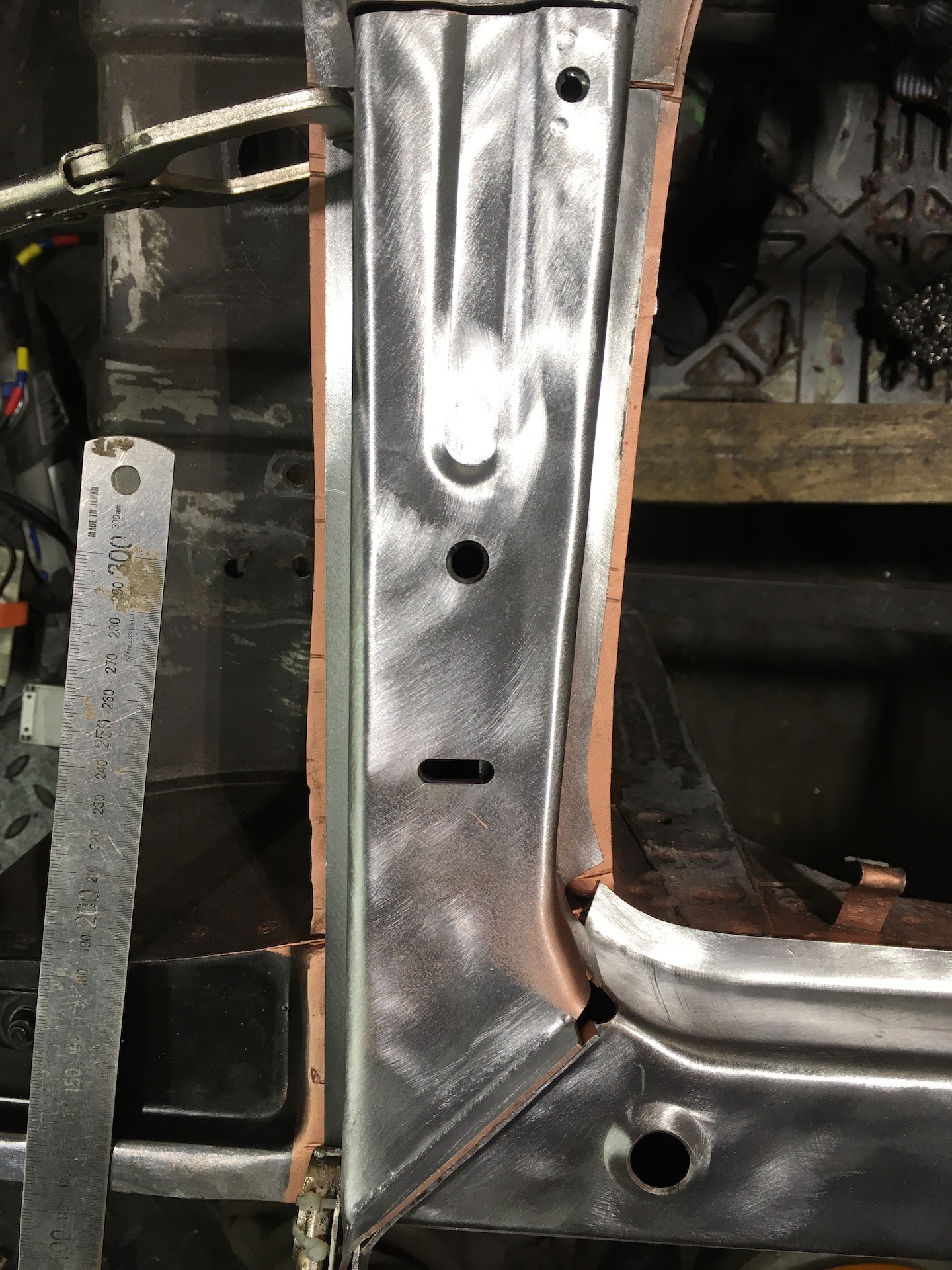

More fun with Repair sections. Seems like they ran out of metal when they made the sides. The base has about 5mm less on it than the existing. This is compounded by it being a little skinny as well. Makes plug welding a little more of a challenge.
Final position shows how well the holes (don’t) line up.

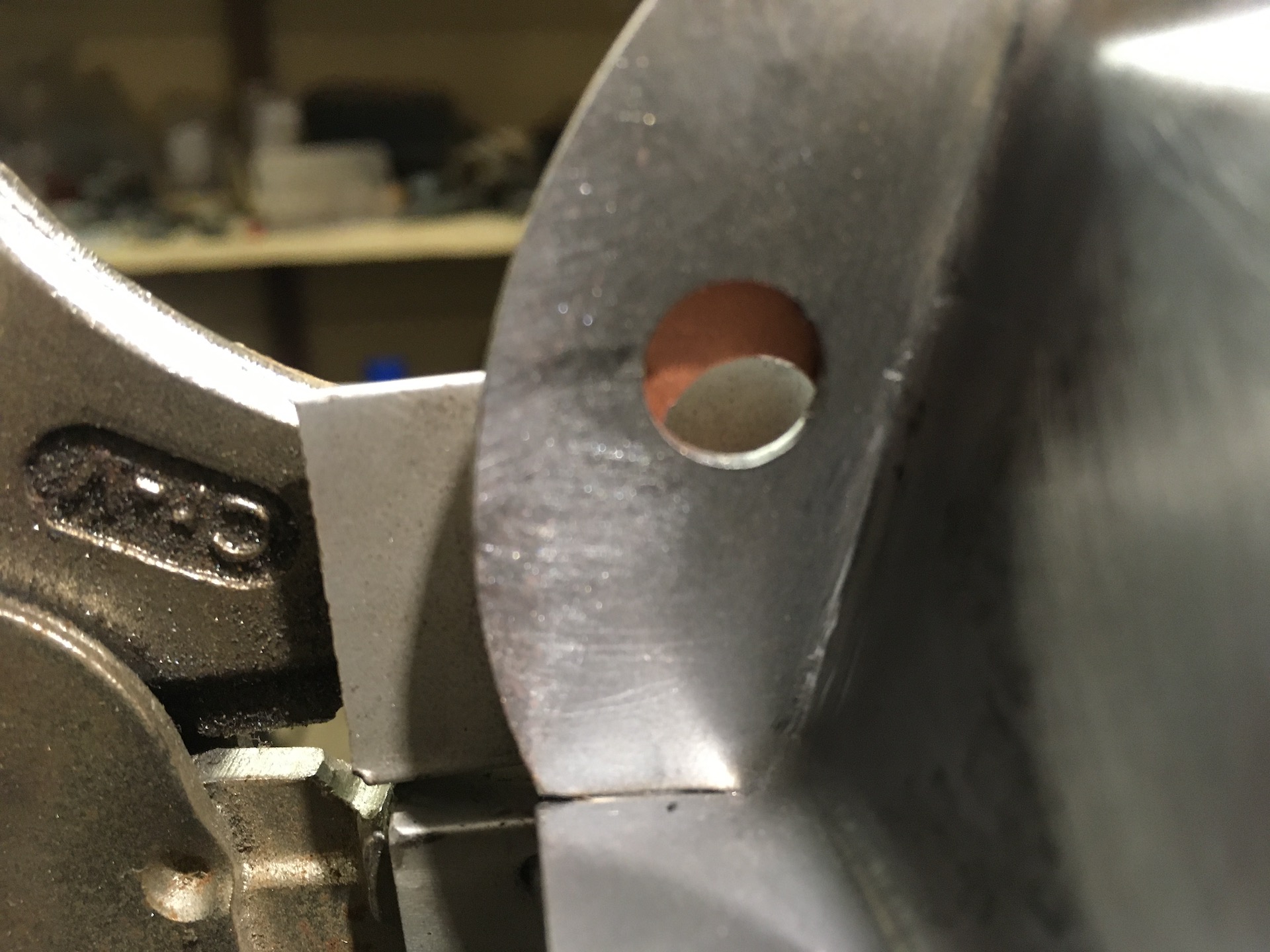

Decided to give the legs a little spread to help the fit.
Which opens this up.
So I did my best to hammer the metal back around the bolt hold keeping the gap at the top and welded it up.

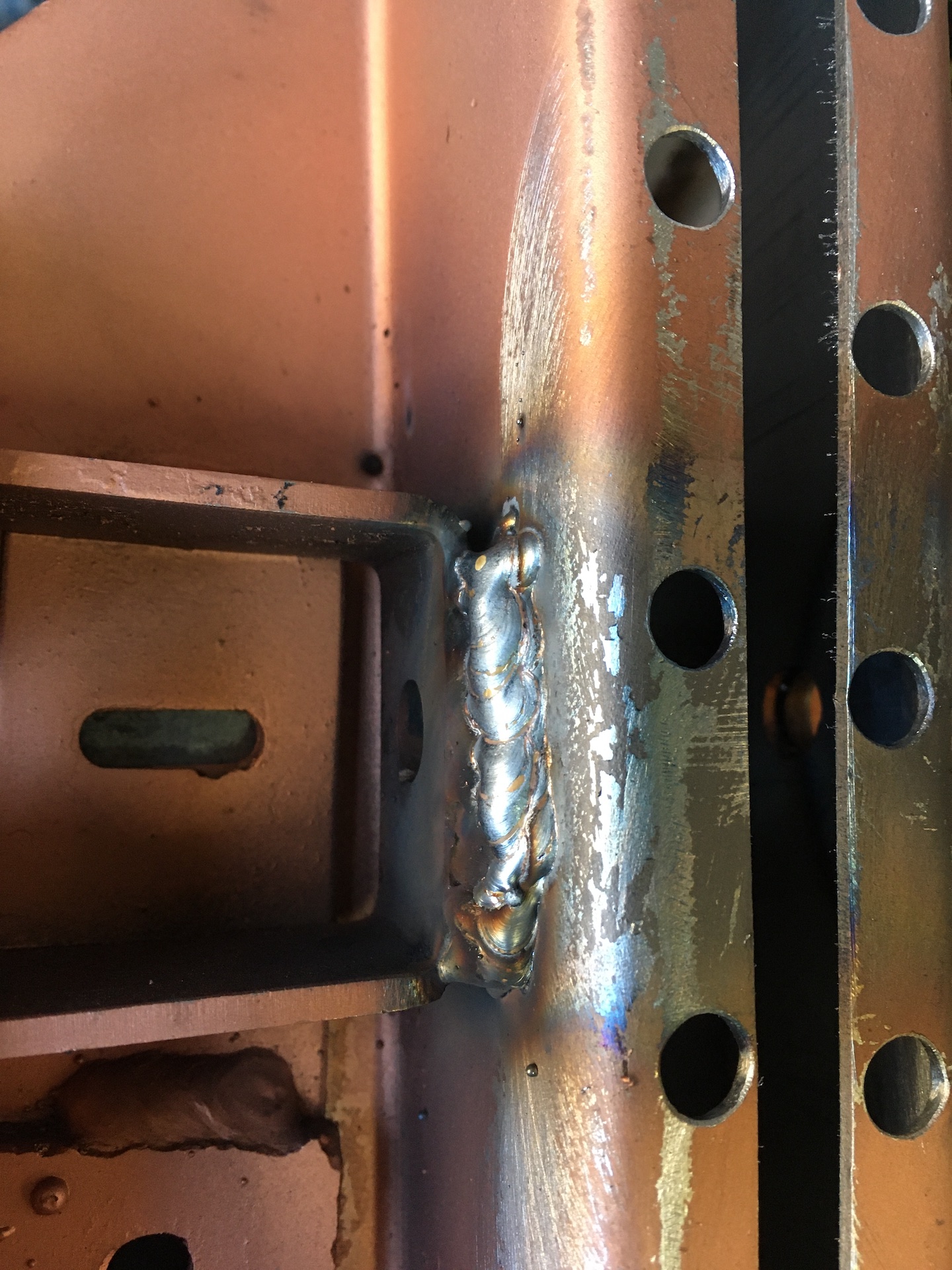

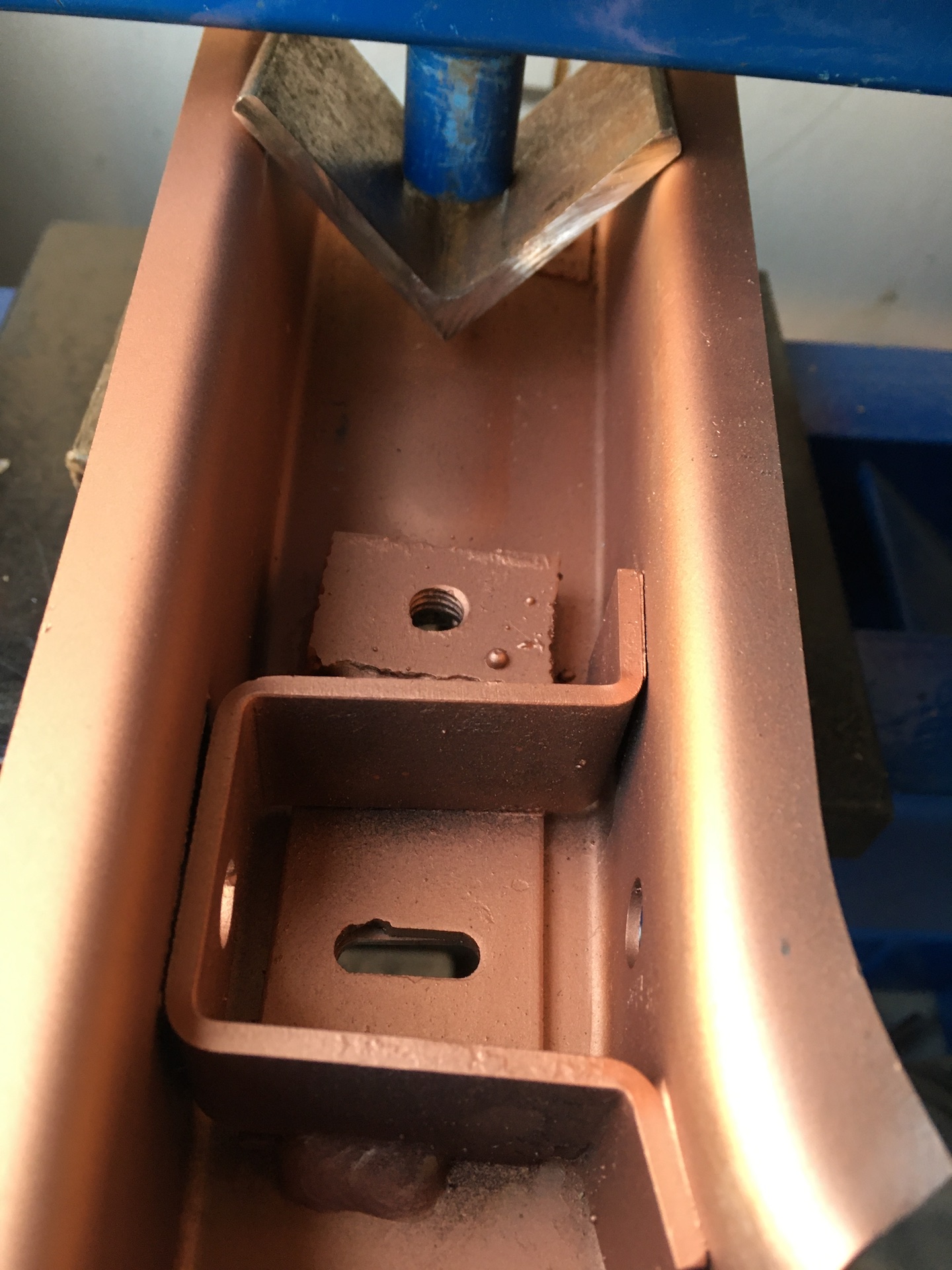

Front tie member was a little wide so I squashed it in the vice to make sure all plug welds had some metal to weld into.
All welded up.
Lessons learnt. 1./ Clean the back side of the area being welded. I didn’t, and the toxic fumes floating straight up into the welding mask made for a fun afternoon. Was clearing the fumes after each weld with a blast of air on the weld then a blast of air up inside the face mask. 2/. Hoods on welding masks are great for keeping light out, and great for catching sparks. Had a few bounce in from time to time, but this one bounced in my ear - not fun and freaked me out a bit even though it was just a little one. I have read a horror story about molten weld in ear.
All welded up.
Scott
