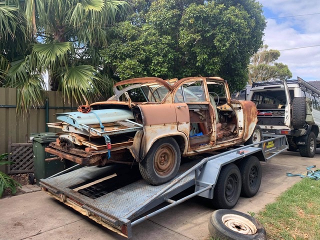

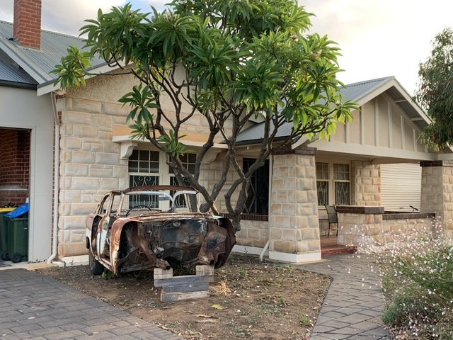

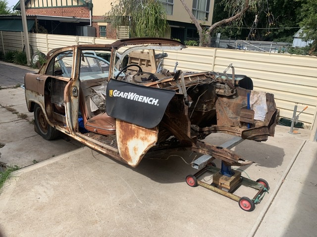

So back much earlier in the year I picked up this ratty wreck for the princely sum of 1 carton of beer, it’s amazing the bits that you can still scavenge!
Got to meet a good new mate named Jeff too while I was at it.
This wreck is now in more pieces and has been transferred to the back yard lol

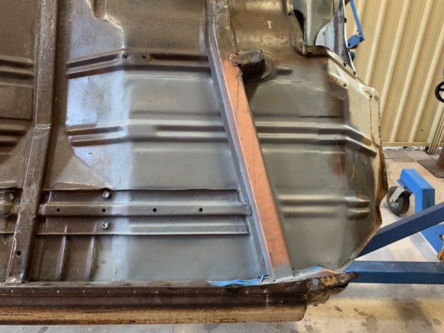

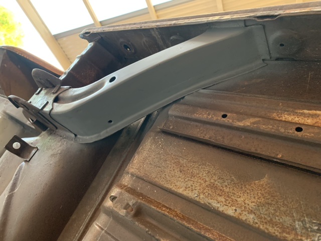

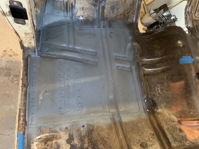

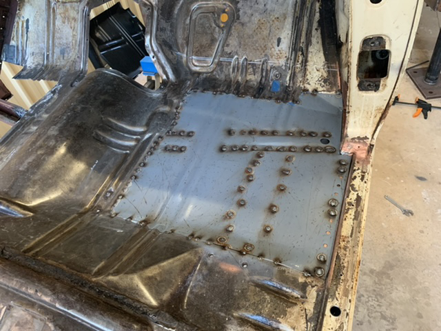

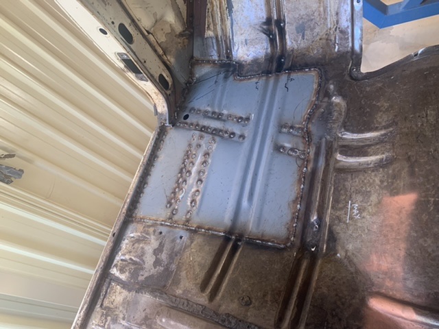

Got the chassis sub frames a fabricated up and finished and managed to get some new floor pans in.
Geez you quickly forget the a out of work you do to get these jobs done.
Seemed like it took weeks inbetween life and my job!

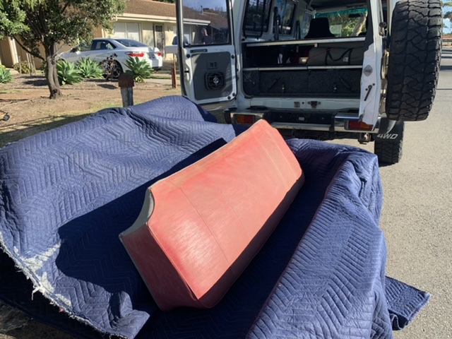

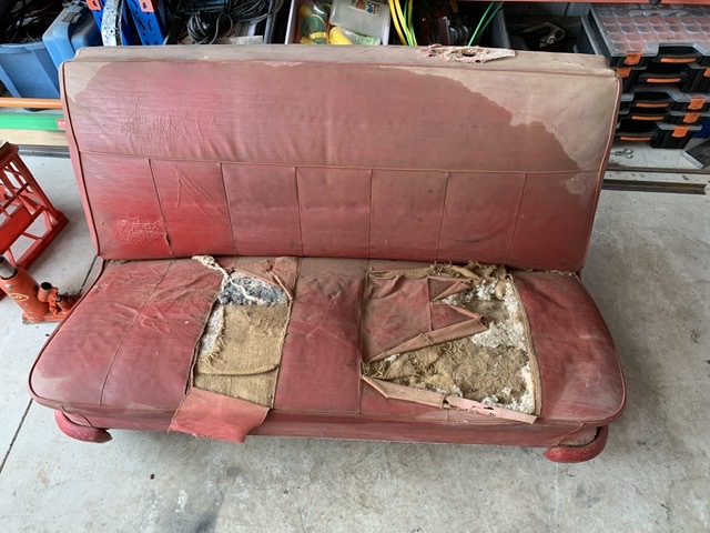

I met a good bloke you did some trim work for me from his shed.
Drew
Posts: 11592
Re: FB Standard Wagon
At last. Rust repairs and trim looks great drew

good progress mate , must be getting pretty close to paint underneath and assembly by the looks ???

That red trim looks awesome!

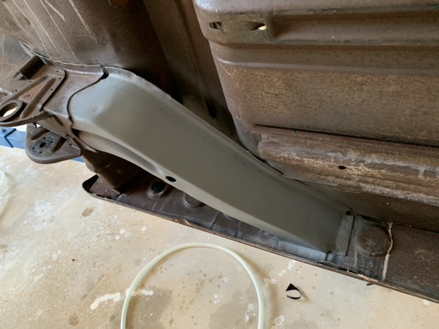

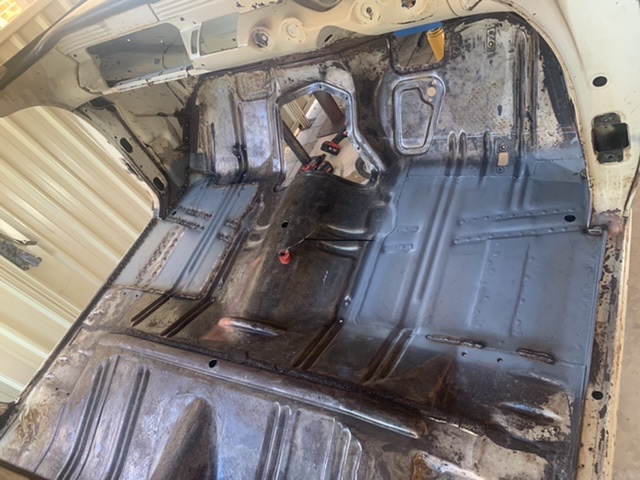

Blacky wrote: Tue Aug 10, 2021 3:19 pm good progress mate , must be getting pretty close to paint underneath and assembly by the looks ???
Gday Geoff, yeah mate all the rust is done and yes I’m starting to seal the underbody up.
I am about to cover it underneath with body deadner but I’m getting last minute nerves.
If I ever need to do any work on it underneath again it will be a mess to get off…
Not sure if I should do it or not.
