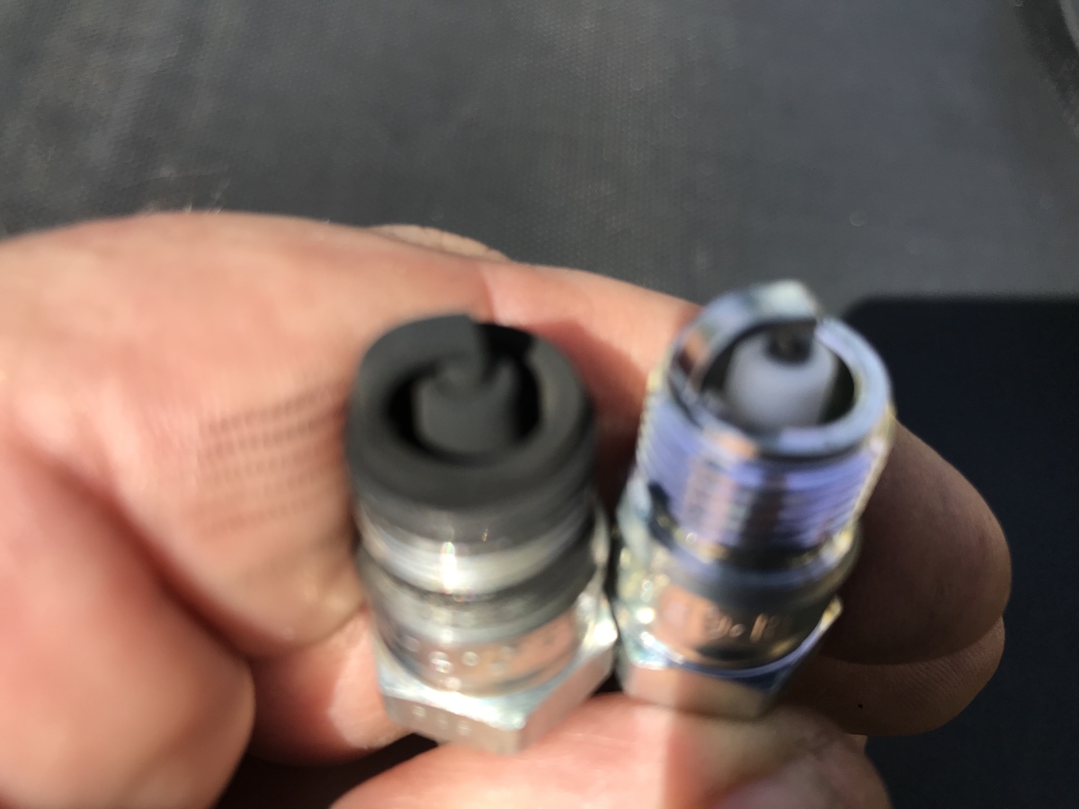

The main drama at the moment though is not so much plug wear, more plug fouling. This is what the rotten thing does after about 10km of driving:
With the high compression ratio, she struggles to get enough zap to light off. A (not so) quick clean, and it starts. Time for some smaller main metering jets methinks. Just got to find the Holley box-of-jets in amongst the rest of my crap.

The fuel of today is just crap sitting around so that could be part of the problem as well.
I used to muck around with jets plugs etc and thought that dynos were for wankers, but the moment I used one it opened my eyes and I will never tune without it.
The fuel air mixture is graphed so jetting is easy,the timing can be measured for ultimate bang and if the tuner is switched on its set and forget.
The dyno will also highlight any other issues real quick including transmission slip etc. I believe its the only way to go especially if your engine is warm as you have said.
Dont worry I have to take 2 plugs out by feel and can barely see them around the booster and exhaust !!

You could also try a hotter plug Harv, I run one range hotter in my drag car with a small block. It will still foul if it is not fully warmed up before it's shut down. Not sure what ignition you have, but may need an MSD or similiar.

A hotter plug is good advice. I run a range hotter in the FB, and the plugs come up beautifully. The colder range of plugs that I used to run end up really sooty.
The ignition seems to run OK, or at least so the dyno says. It's an MSD billet dizzy, running an MSD Blaster coil. Pretty simple stuff, but for what I am doing it doesn't need the "features" of a full electronic ignition box.

Took the wagon over to the chassis dyno mob on Saturday to get the mixture set across the whole range. Car ran OK tootling along in Sydney traffic. A little hard to start from the fouled plugs. Speedo checked out OK on the way over, so at least there was one win. Got over to the dyno place, and the dyno bloke takes a quick look to make sure it is OK before putting it on the rolling road. Good voltage at the coil, air cleaner off and carb looks OK. Fired it up, and the bloke reckons the car has a horrible noise. Stuck my head under the bonnet, and have to agree with him. Thought it might have been the water pump, but no. Looks like significant bottom end damage, drivers side rear. Dyno bloke checks timing, and it has 34º at idle and 44º all-in. Waaaaaay too much advance, and has detonated itself to death.
This was probably when the WA guys heard me swear.
Engine had been built, and I spent a small fortune having it engine dyno'd by the builder before I put it into the wagon. Haven't touched the timing since. It would fire up relatively easy, though after a few runs would struggle. I figured it was fouled plugs... more likely it was so damn advanced that it would not light off. Chassis dyno bloke wound the timing back a tad, and now it starts damn easy, even with crappy plugs. Managed to limp the car home again and park it in the naughty corner.
I've had the engine back for about a year, mucking around getting the car finished. It's been up and down the driveway and to the end of the road perhaps a dozen times. All low speed stuff, with the dizzy sitting at low timing (not much more than 34º). Last weekend's run down the M4 (to set the speedo) was at 100km/h - dizzy wound in the advance to 44º, and she detonated out. Didn't hear any pinging, but then again I was obsessed with the speedo (and then the smoke show from the failed trans cooler line).
