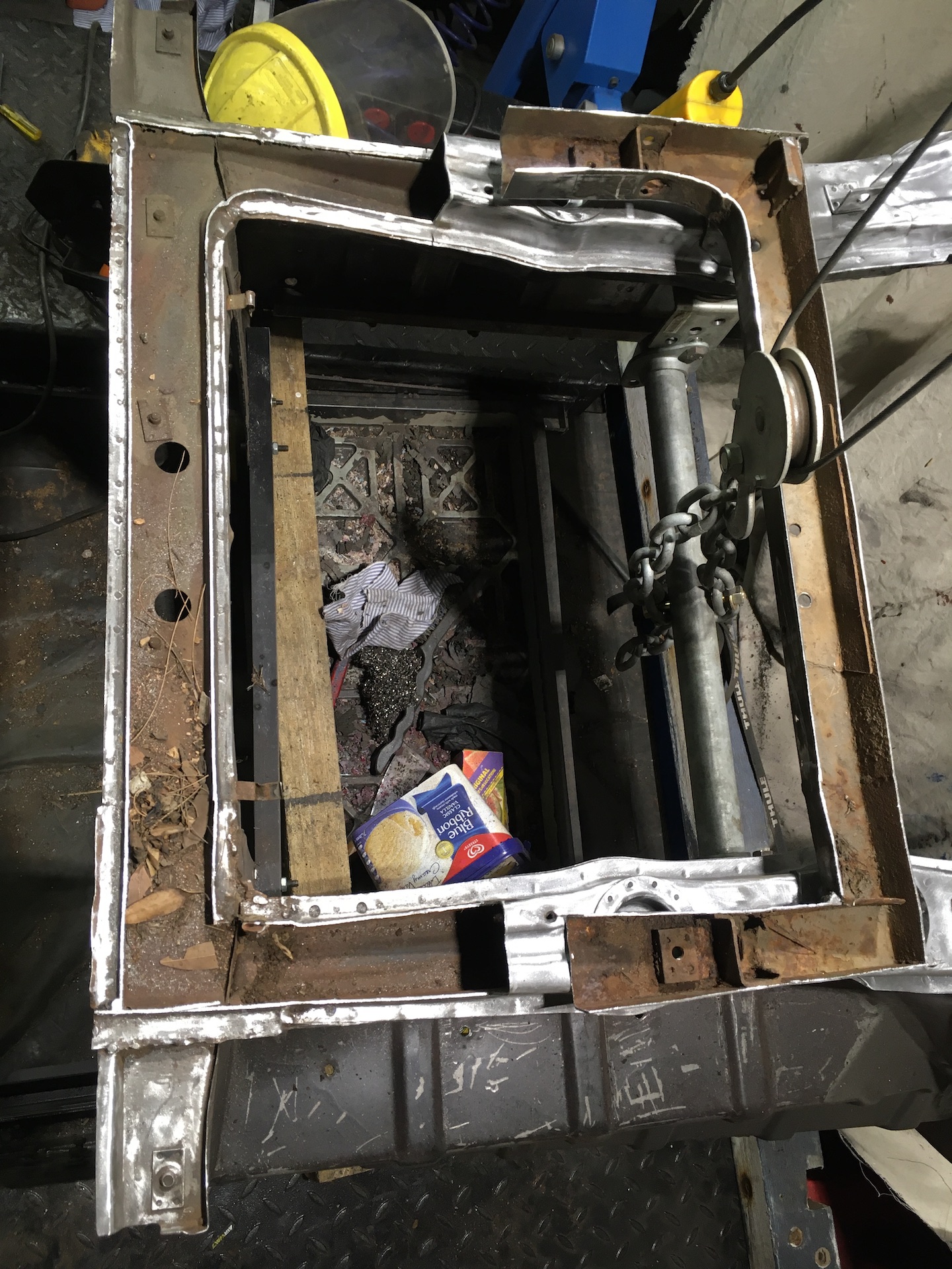

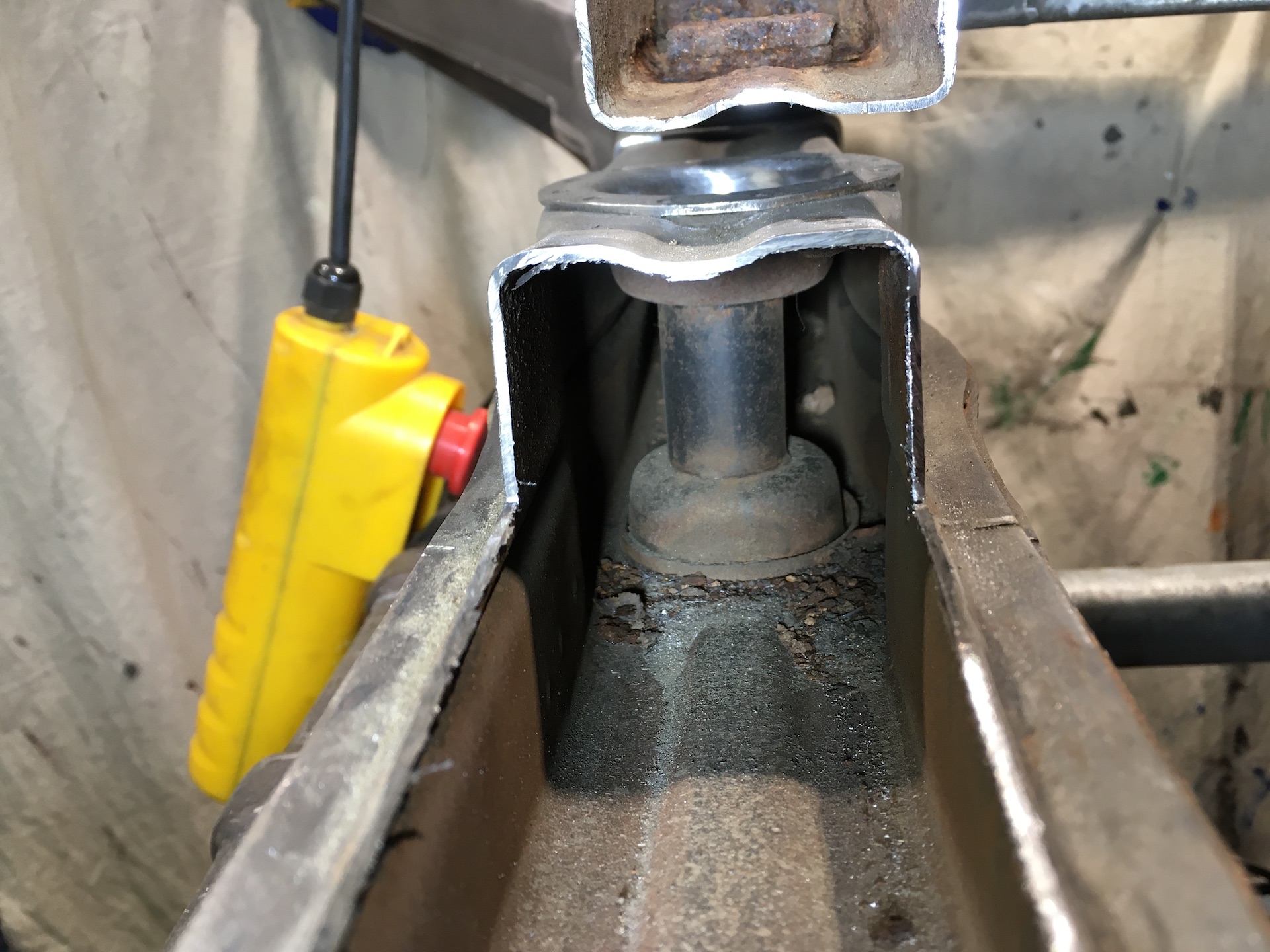

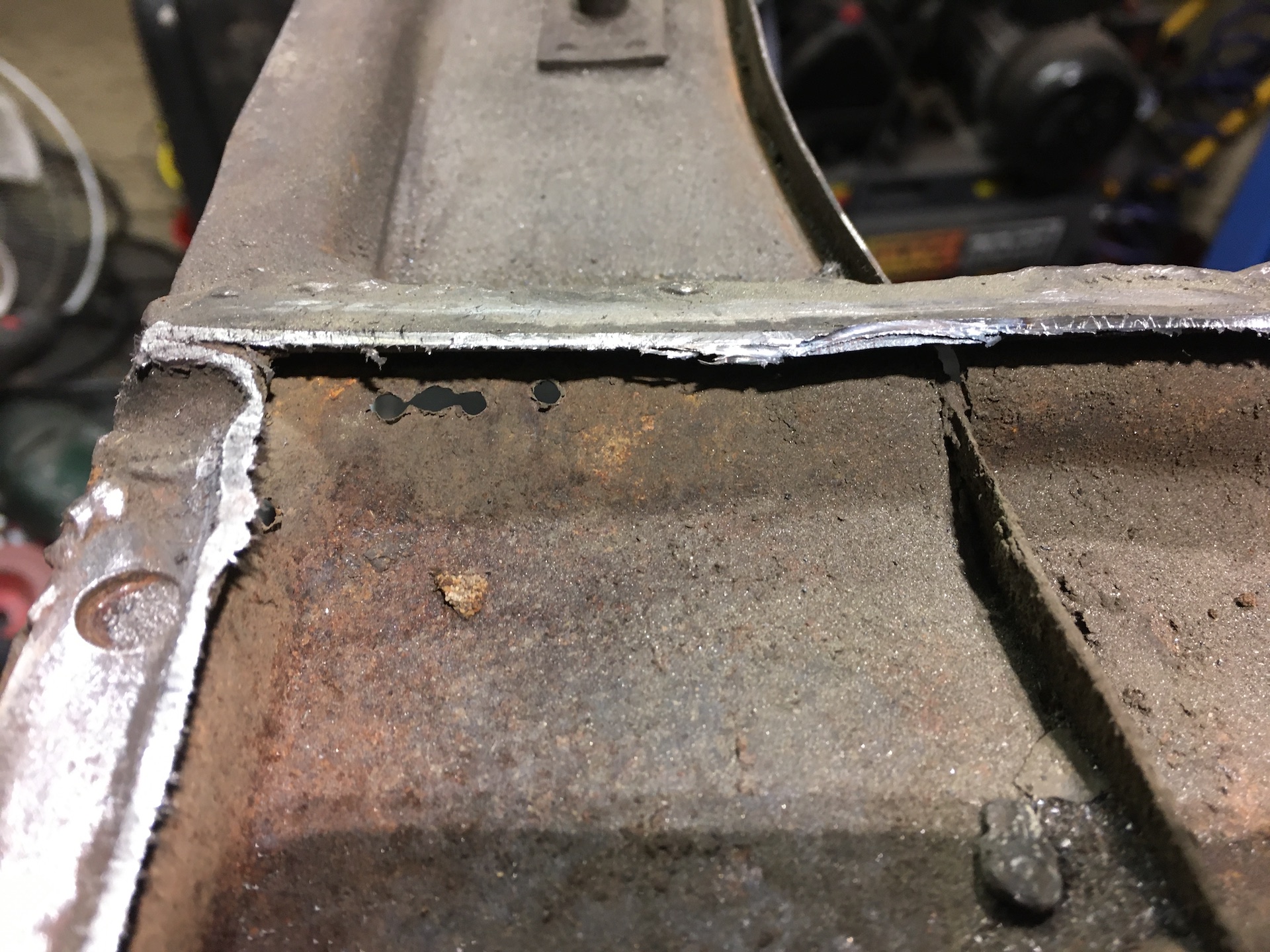

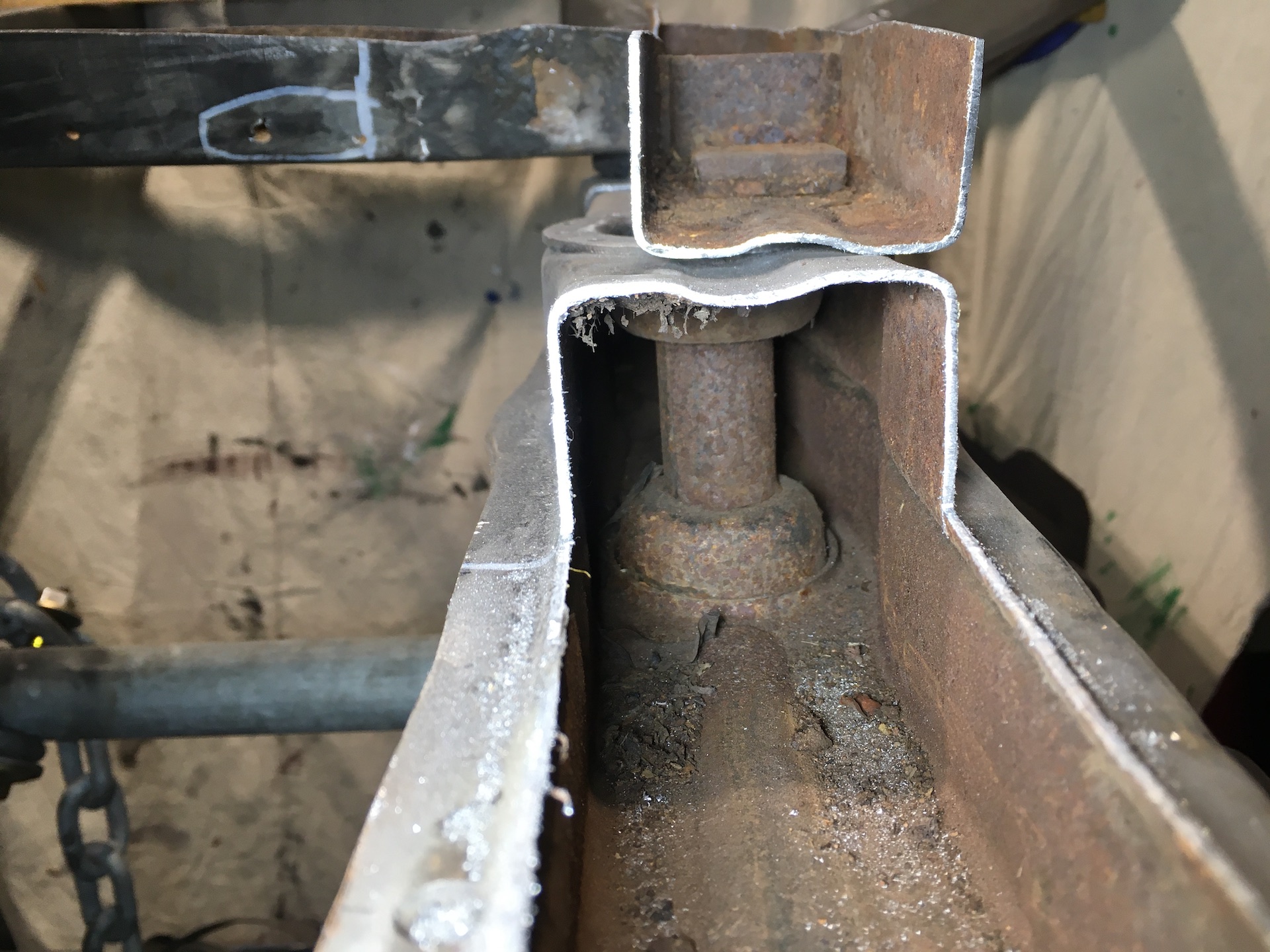

Cut the bottom out of the sub frame. Not the horror show I was expecting, although the top has a fair bit of surface rust and a few holes that will need some love. Bit of a theme with the rust - mainly drivers side. Must have been left parked on a hill.
- IMG_8795.JPG (741.31 KiB) Viewed 807 times
- IMG_8796.JPG (563.26 KiB) Viewed 807 times
- IMG_8797.JPG (620.28 KiB) Viewed 807 times
Scott

Re: Ol' Rusty - FB/EK Sedan
The ice cream tub?
Or the hoist?
If you mean the hoist then yeah its helpful for awkward things like this. Sub frame is not that heavy, and can be man handled if neccessary, but nice to be able to pick it up and spin it round one handed.
Balance point is just behind the rear front end mount bolts.
Or the hoist?
Scott
I threaded thick rope through the rear holes and knotted the ends. Then use engine crane to fit up to inverted body on rotisserie.
