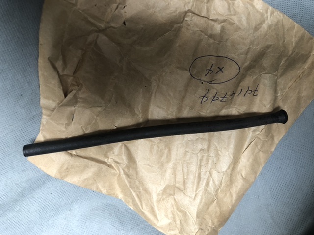

Primer onImage. Forgot to take old mastic out of hingeImage. Never mind more primer to come. No drain hole on top of this door??Image

Brett027 wrote: Wed Oct 28, 2020 6:42 pm No drain hole on top of this door??
I thought all FB/EK doors had the drain hole, and a fancy drain tube (?):

So did I. Maybe filled up previously or is it an original door? I’ve got a nos door on the van. Will have to have a look. Well done getting a nos drain tube Harv. They tend to be dried out so I try not to touch them.

I'd say you were on the money Clay. There was a fair bit of brass in that area so maybe an over zealous previous repair. The question is- is it worth making a hole or not? Does anyone sell the tubes?

Gland nut, rubber tube and shrink wrap. What I'm doing with my Bosch headlight wiring tails.

I've got two of those door drain tubes - I you want them, PM me an address and I'll throw them into the post for you.

Where can you get those drain tubes from apart from Harv's shop ?
