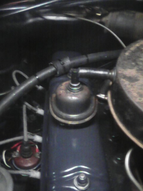

Here's the latest.
Tow boat to Winton. No oil under car at fuel stop after first 200km.
Get to Glenrowan, oil everywhere, huge puddle under car at servo. Used about a litre for that 300km.
Return trip same route same speeds and driving style. Used next to no oil, small drop of oil on ground as would be expected for a grey.
Averaged about 20mpg towing.
Compression test 140-145 Psi across all cylinders (dry).
Oil pressure 5-20 psi hot.
Crankcase pressure test 1.6 - 2.2 inches of water flat throttle accelerating through to 60mph. 3.2 at 75 mph.
Engine done 8000 mile since rebuild.
Using Penrite HPR30 (20w60).
From experience I think the crankcase pressure is a little high, the cause of which is still unknown. So today I did some more testing and revealed the following:
Engineers did things for a reason. Reversing the filler cap reduces crankcase pressure by about a third (down to about 1.8" H2O).
Some small effect in reduction of pressure on fitting an EJ breather which doesn't have the frog mouth.
As the years passed road speeds increased and problems became evident. Harv's work on the revised head gasket for high speed work is an example. I'm guessing the breather cap change on the EJ is the same. Interesting to note that the 149/179 reds retained the walking stick breather tube but got rid of the forward facing opening on the filler cap altogether. Could this be due to more increased crankcase pressure from a higher output engine (higher combustion pressures and increased volume of blowby for the breather pipe to handle)?
Now with some mods I have tested this set up and have got it down to 1" H2O flat out under full load at nearly 80mph. I used an old PCV with the guts taken out. I have had to slightly restrict the air horn to induce some flow across the breather into the air cleaner. fuel mixture was checked with oxygen sensor to ensure it wasn't running richer at full throttle.
After about 200kms driving at 50-60mph I am left with an oil drop from the rear main about the size of a 5 cent piece and possibly evidence of drop forming on the tip of the breather.
Now after discounting compression/cylinder issues I'm looking at exhaust valve guides and or muffler back pressure.
Good point to day is I have finally sorted the ignition and now I can fully map the advance curve. Now on 95 only fuel and some more tweaking with the curve and my detonation at 50 mph is almost gone. I now know the head was shaved too much by the machinist.
Not much more can be done before the Nats so this will have to do for now. Hopefully I'm narrowing it down.......hopefully.
