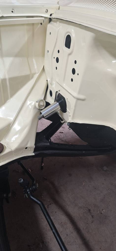

Started to mock up fitting the Billet works column late Sunday arvo. Need to get its positioning sorted so I can cut the shaft to length from the steering box. Has anyone in the forum fitted one of these to there build at all ? I did have a search but couldn't see anything ..

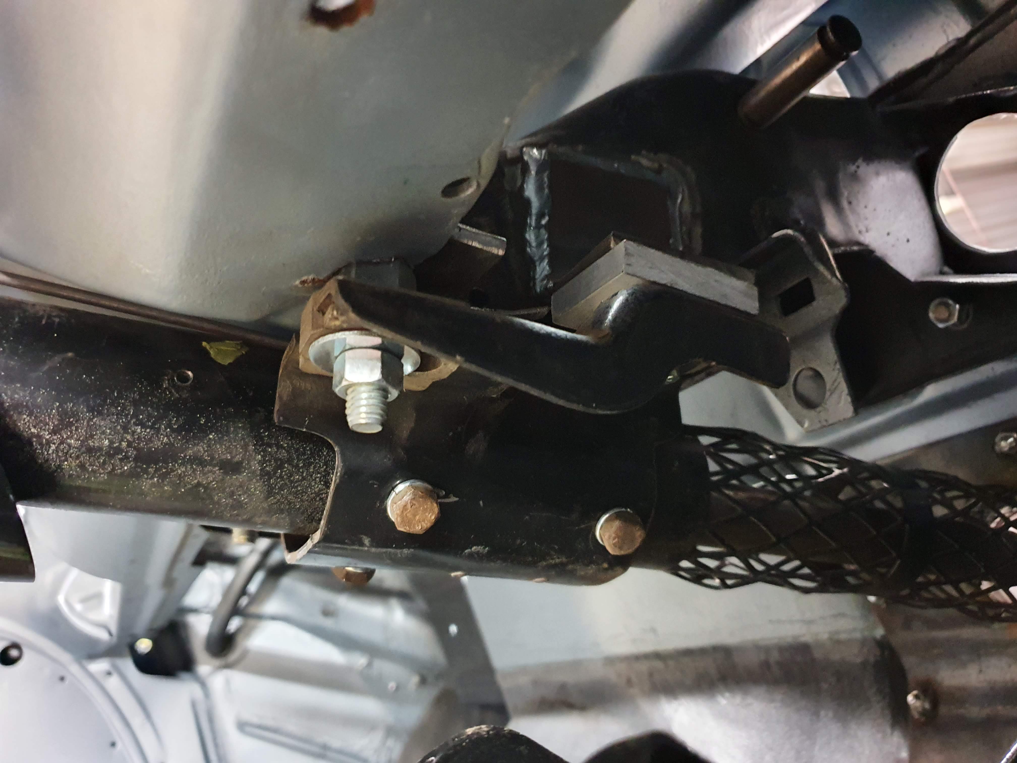

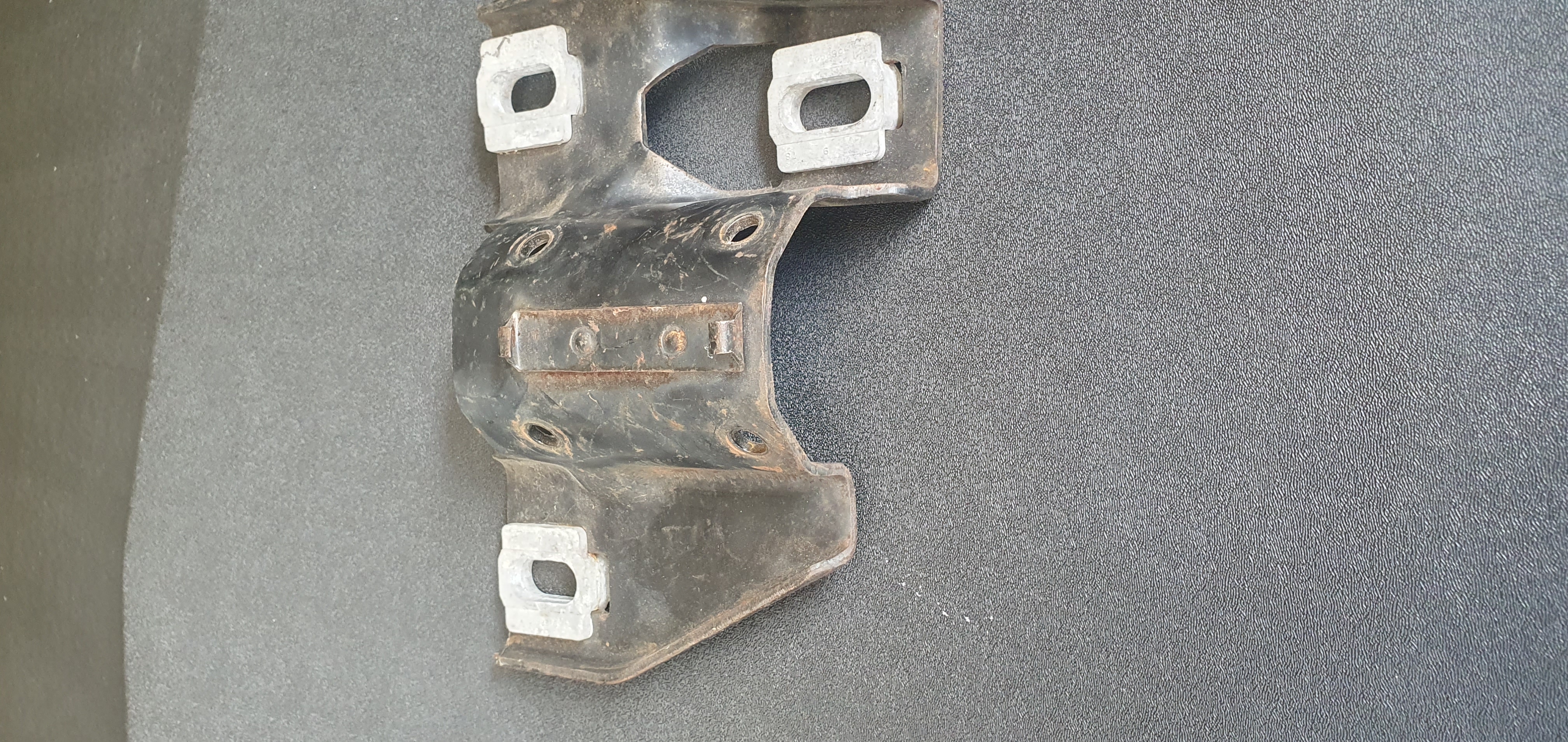

You can buy a 2 bolt breakaway from one or more of the hot rod places that can bolt onto the dash and clamps on to the column. The way I did mine was to use the holden 70's steering mount which has 3 bolts and works nicely under the dash. To do that you have to weld a bracket onto the new column to take the breakaway plate mounts. You can see the small bolt heads and the side of the column.

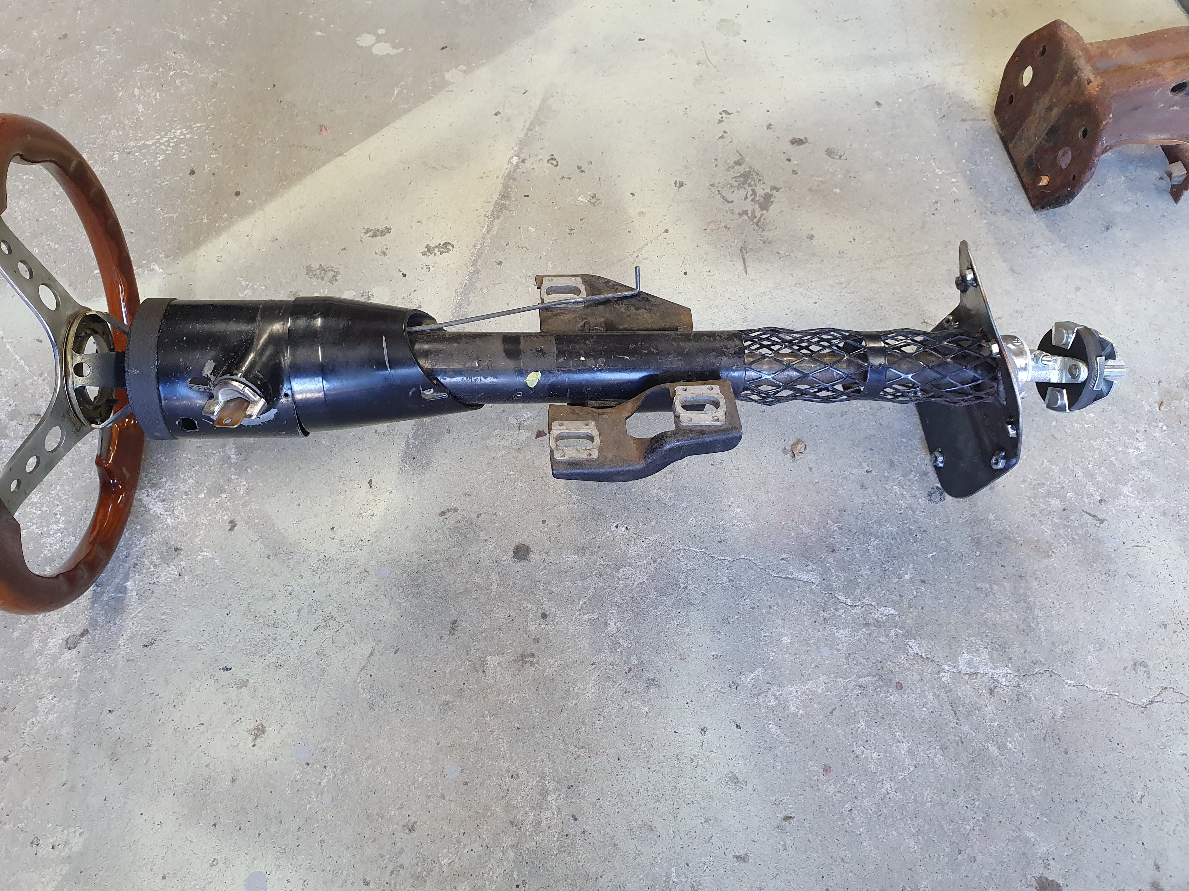

Re: Family Affair Ek Ute

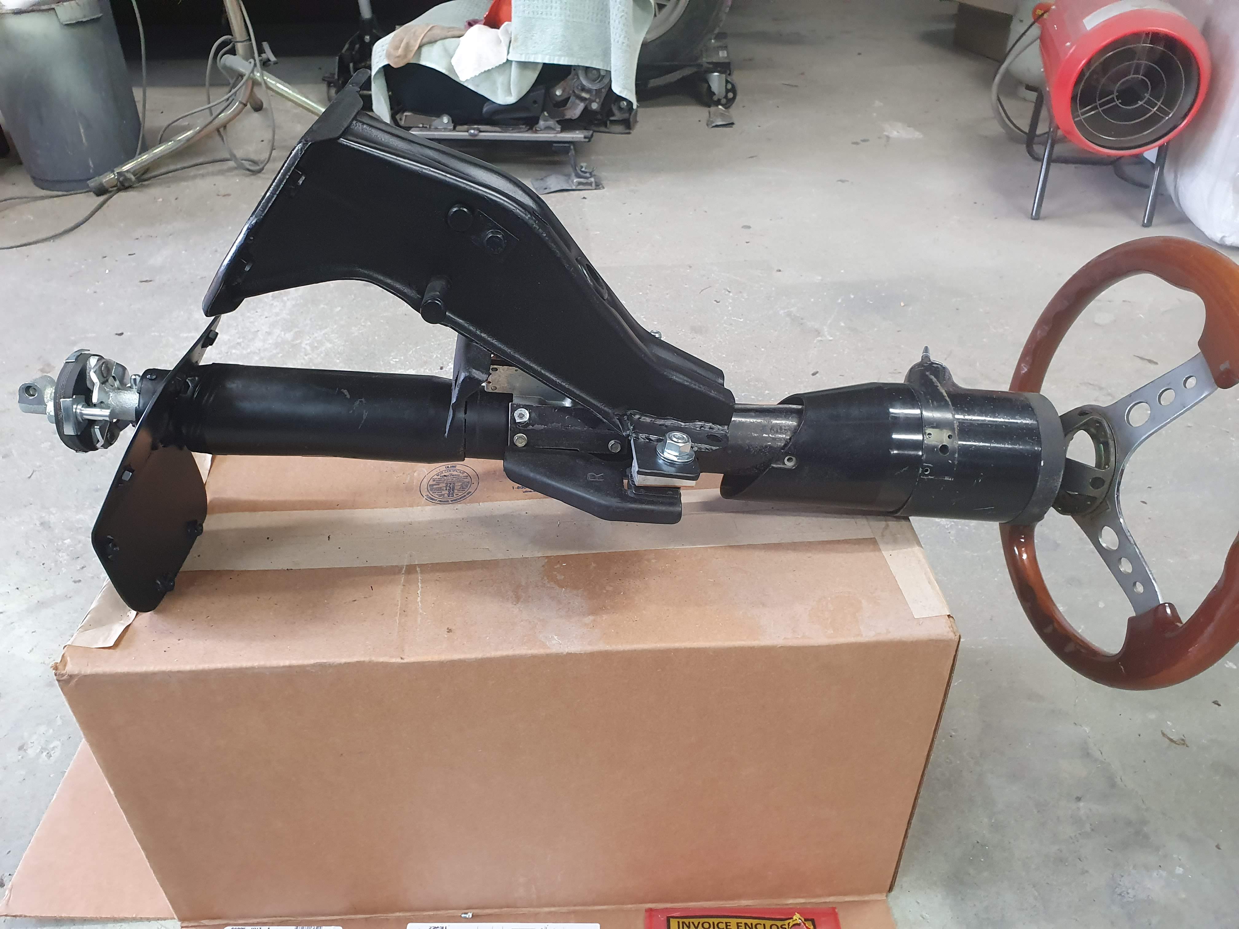

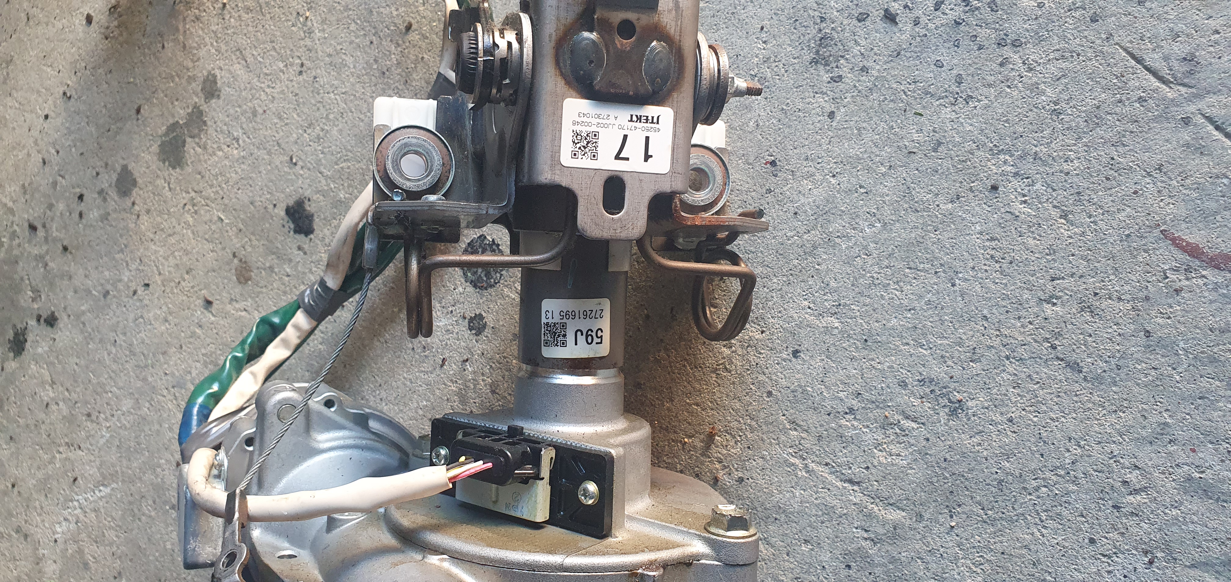

Pic of modern Yaris steering coloumn with breakaways. Also pic of my tilt column and the mounting bits so it will bolt straight in to replace current Torrie set up.
