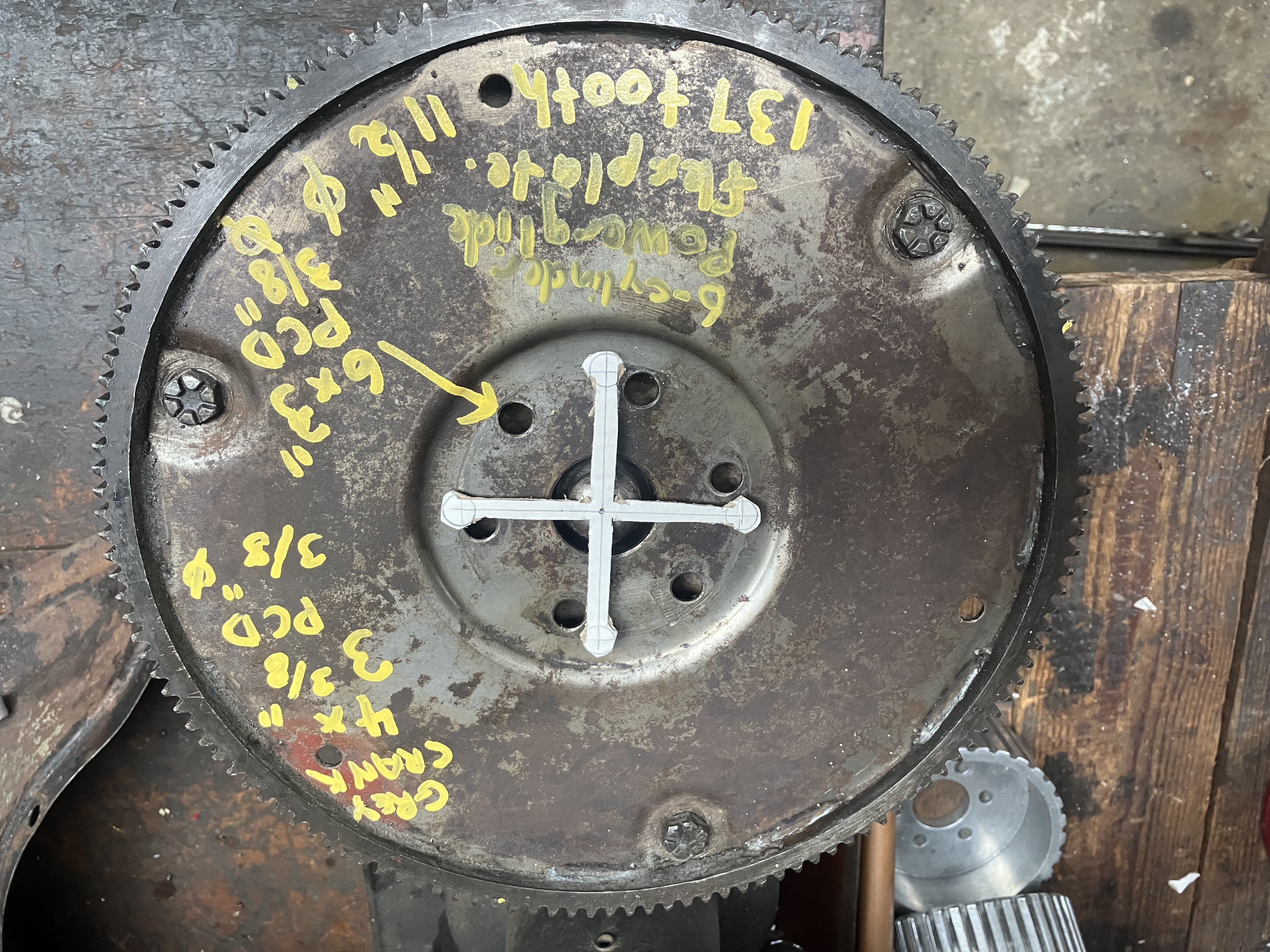

Cleaning up a little, and made me think about the flexplate. Several years ago someone told me you need one of Roger’s Trimatic conversion flexplate to mate a Powerglide to the grey. I bought one, but wondered what the issue is with reusing the old one. Some measurements show that the problem is in the grey crank flange PCD. No matter how you turn the holes, the 4-bolt grey pattern overlaps the 6-bolt red crank pattern. You could redrill the red motor flexplate, but the holes overlap… not pleasant, evening you had the assembly balanced.

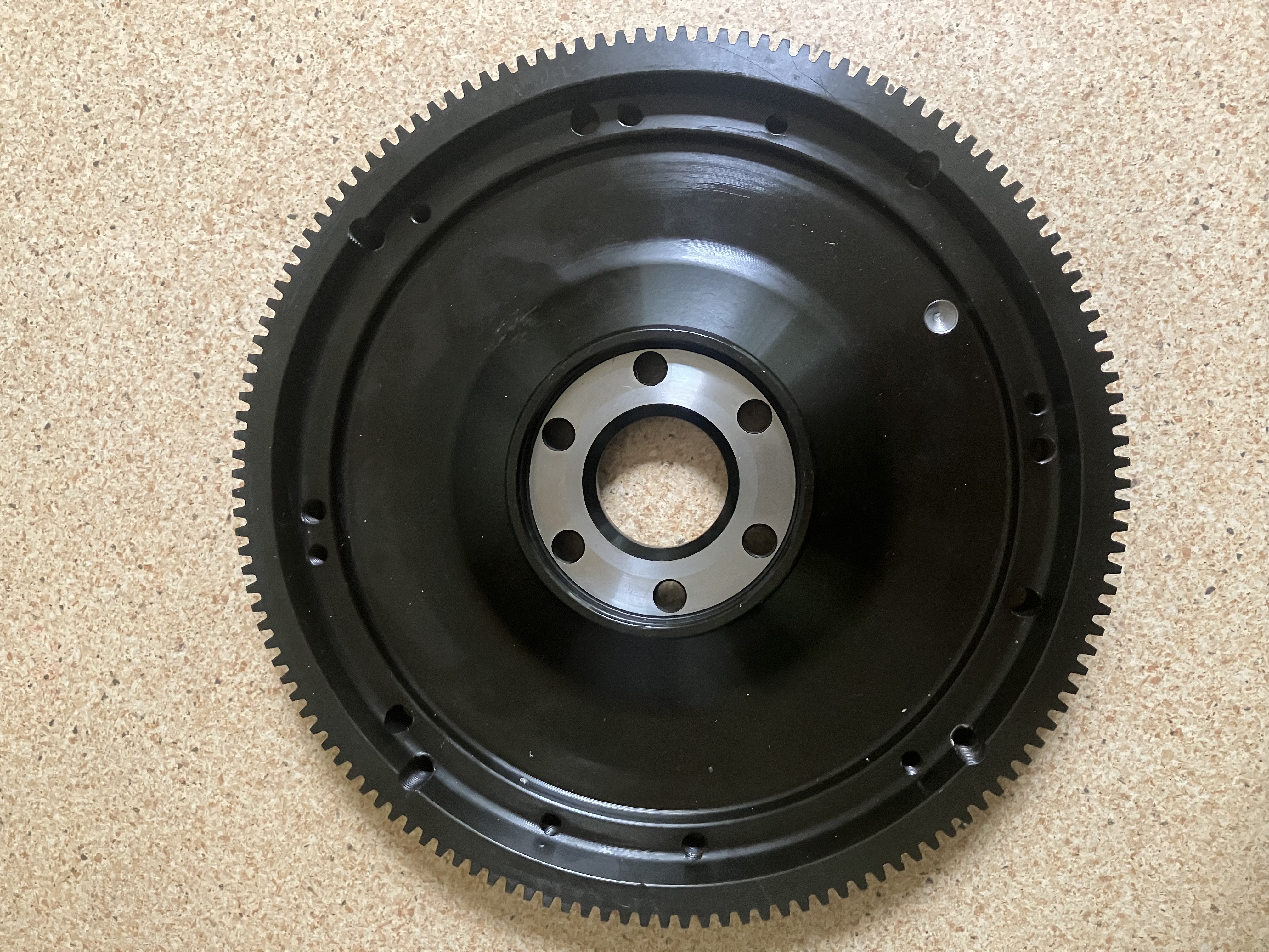

… which made me think about the forged flywheel I bought for the meth monster project. It will run a grey crashbox, and the rules say I need a forged flywheel. I bought an SFI-certified one many years ago, advertised to suit grey/red/blue/black. Pulled it out of long-term storage, wondering how the drillings would work…
… and they won’t. Will fit red and later, but not grey. Suspect there are no returns after so long, but will call and ask them next year.

poo - hopefully they can take it back and swap it for one that isn't drilled ??

In the first photo it looks like you could rotate the four holes about 30 degrees anti-clockwise and get clear metal, no?

Errol62 wrote: Sun Dec 22, 2024 10:44 am In the first photo it looks like you could rotate the four holes about 30 degrees anti-clockwise and get clear metal, no?
Maybe - but there would be farkall meat between the holes - i wouldn't trust it .................

You could elongate the east west holes and the north west would be in the middle of the pre drilled ones.
You could also weld the holes up and redrill.
Sorry just realised your new flywheel is forged, you could redrill the crank to suit the 6 bolt pattern maybe ??

Holes definitely don't line up. No matter how hard you try (or whether you drill flexplate or crank) some of the holes overlap. Called Extremeclutch, explained to them that their 2015 and 2024 catalogues both show that this thing fits a grey, but obviously wont. They are OK to take as a refund, if I can return it via whoever I bought it off. Some searching, and it must be the only receipt I haven't kept. Bugger. Asked if they could supply one undrilled, and the answer was no :( .

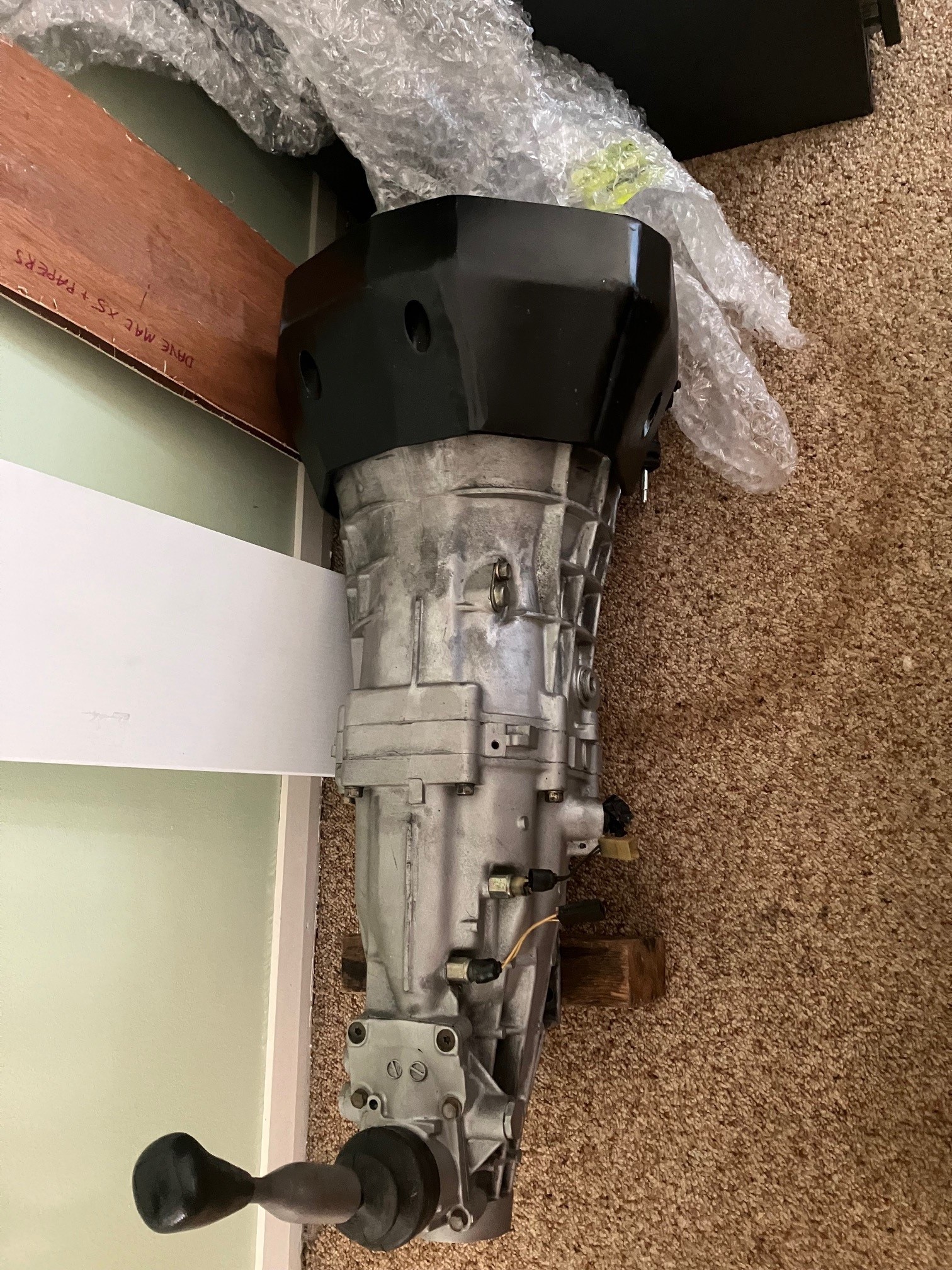

This may get interesting. The IHRA rules prohibit cast flywheels, and require the forged ones to be SFI 1.1 certified. I'm supposed to have an SFI 6.1 scattershield too. May have to talk to the tech inspector. I had a similar problem with Number One Son's VL, which runs the R33 5-speed "Skyline box". It has an SFI flywheel and clutch assembly, but could not get an SFI scattershield anywhere. Got one fabricated up in accordance to the SFI specs, but not easy. 1/4" plate, 1" forward of the flywheel and 1" aft of the clutch. Fabricator reckons it would stop a 30mm autocannon round, and looking at it I think he is not far from wrong (the SFI spec only calls for testing with .22).

Might have to get a similar one made up for the grey crashie, and see if I can get away without an SFI flywheel. Don't know anywhere else that would make one.

Scattershield………that is a nice piece of fabrication there. So you have a .22 stashed in the parts department there Harv……. for testing purposes only of course 🤔
