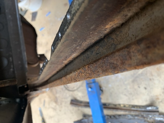

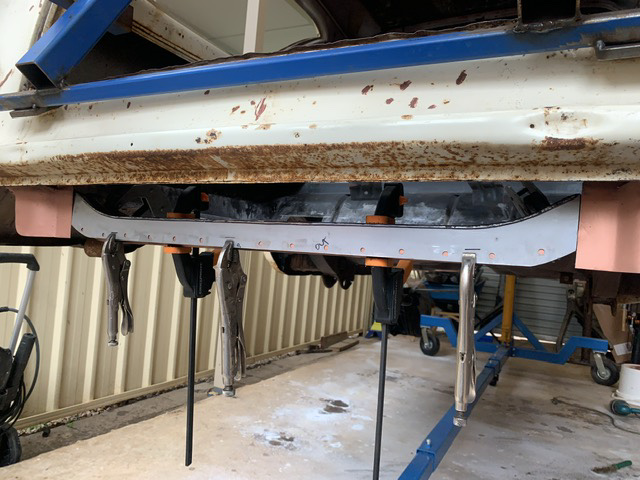

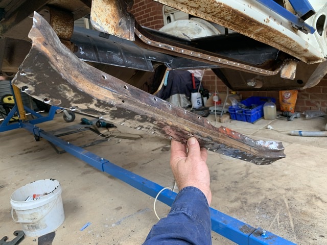

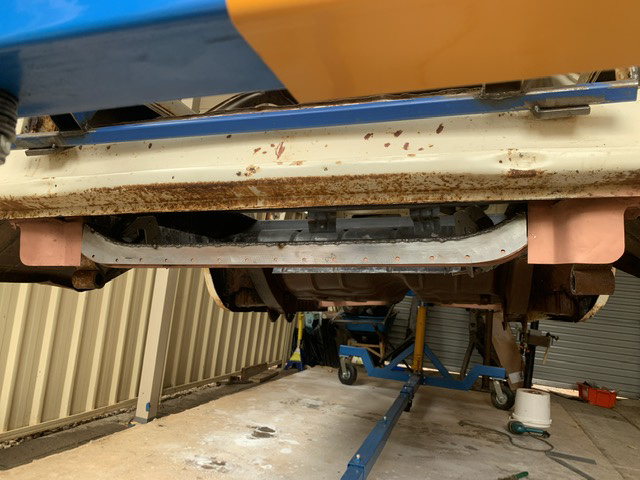

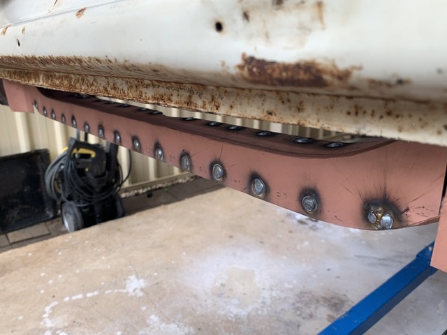

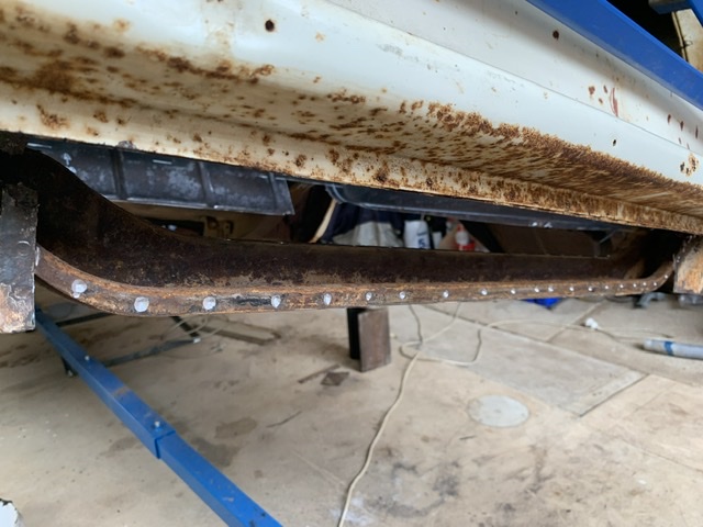

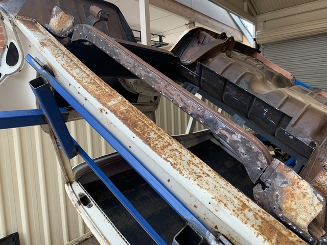

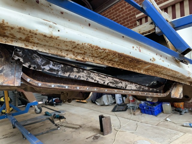

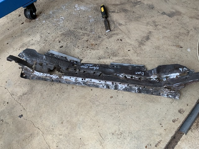

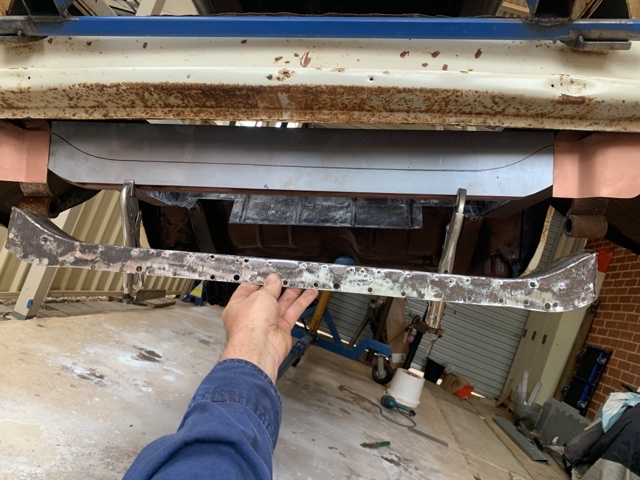

Had a fun day of unpicking seams today.
Layer upon layer upon layer
Drew
FbSTDwagon
Posts: 790
Re: FB Standard Wagon
Post by FbSTDwagon »

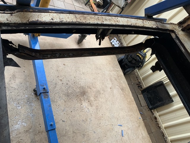

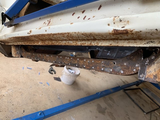

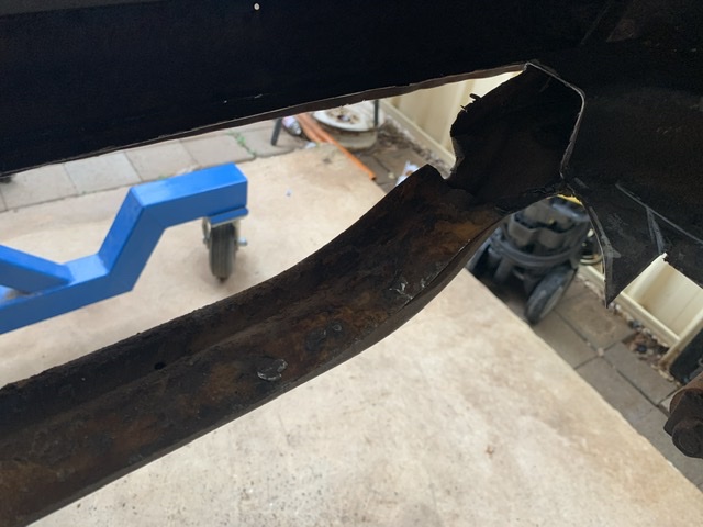

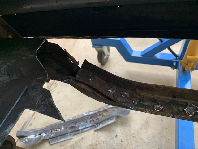

It didn’t stop there as I went a bit deeper so I could open the rear chassis support right up.
It’s a good opportunity to poke a spray hose down the chassis rails and dose it with rust converter.

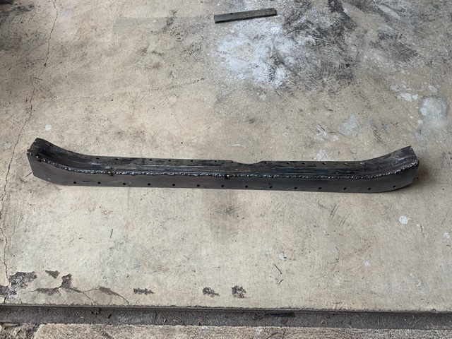

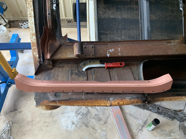

I’ll repair the rear chassis support piece and refit it, I can’t roll beads or shrink/stretch.
That’s a skill I’d love to learn ilif the opportunity arose!
Drew

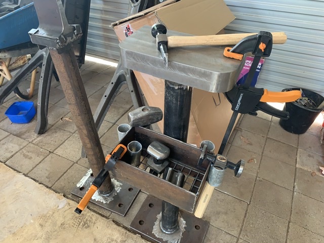

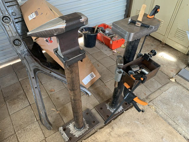

Had a week pretty much off the car and in the shed making some tools for metal shaping.
I was struggling with bending the sheet metal and having a solid plate to do some bashing on so I made a few different types of anvils.
A pipe anvil for getting me started on some radius’s.
A flat plate anvil with a sharp edge for creating clean bends.

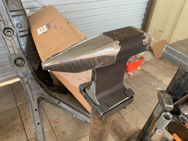

And also a traditional style anvil made out of rail way iron.
All of these tools look basic but geez was I time consuming g chasing the materials down and a next to nothing price, aka scrap metal bins etch
A good 4 days of machining and fabrication have me some great tools that I will now have for life.
Drew

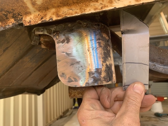

This arvo I jumped back onto a couple of small patches that were so easy to make now I had some good tools.
Curves were simple to make!
I’m looking forward to hitting the rest of it pretty hard over the next few weeks before I start my new job.
Drew
Posts: 2677
Great work !
Love the railway line anvil !
You can make anything if you have the right tools .
Posts: 11589
Admire your patience drew. Bet you made some noise turning down that big anvil.
FbSTDwagon
Posts: 790
Cheers Greg and Clay.
Yes the anvil is a ripper, it took ages to machine down on my small mill.

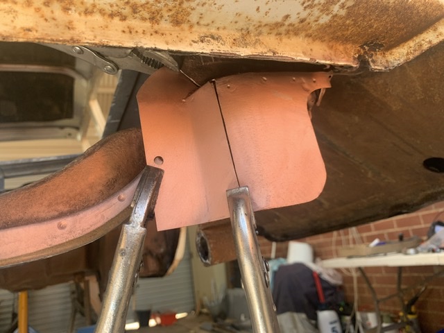

More progress today deep inside to rear beaver channel.
