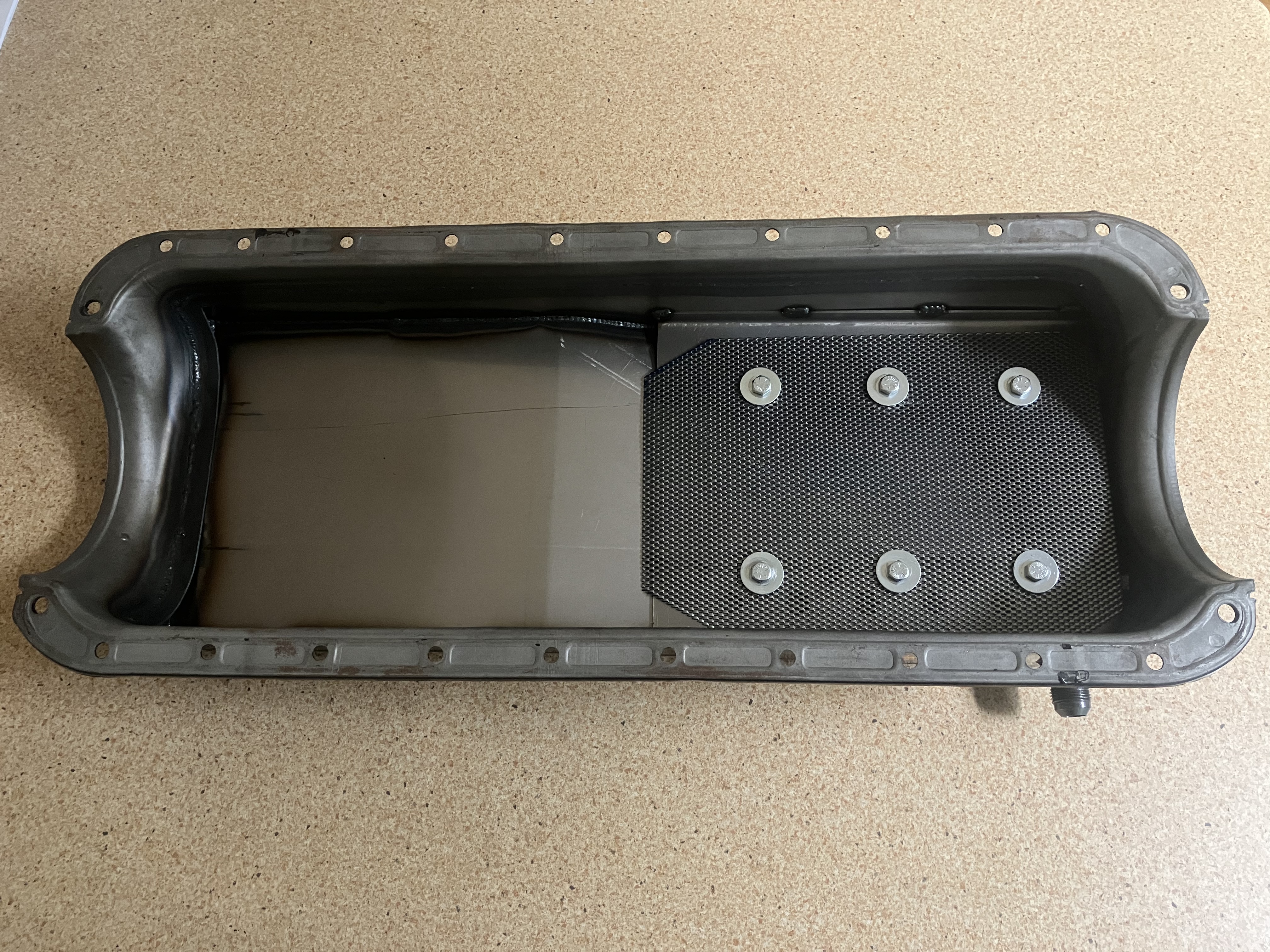

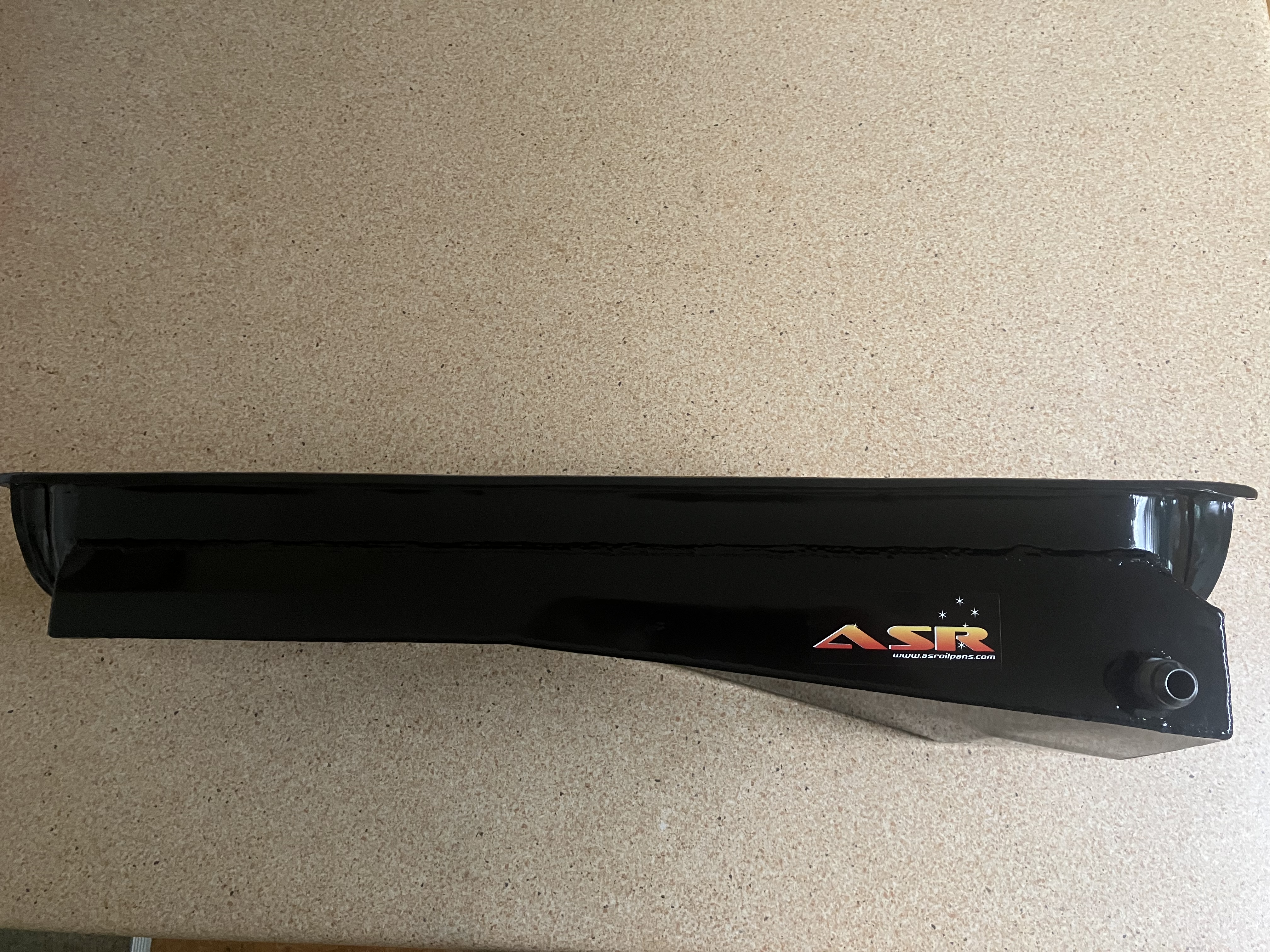

Drysump arrived.

Good looking bit of gear (or sump) there Harv

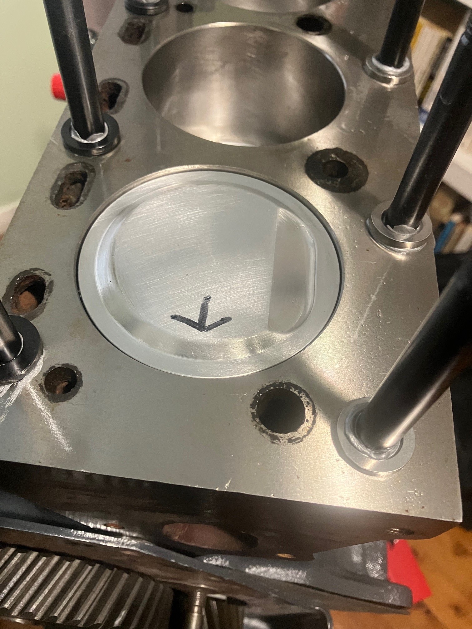

The meth monster block for the FB is home again. This one ends up with the factory crank and part-girdle, dry sump, repro Repco head, full cooling. Crank, rods and slugs now balanced and all installed, cam in place. Attached below the gratuitious lump photo. Custom forged slugs for 9.5:!, so smaller lumps than a normal Repco gets.

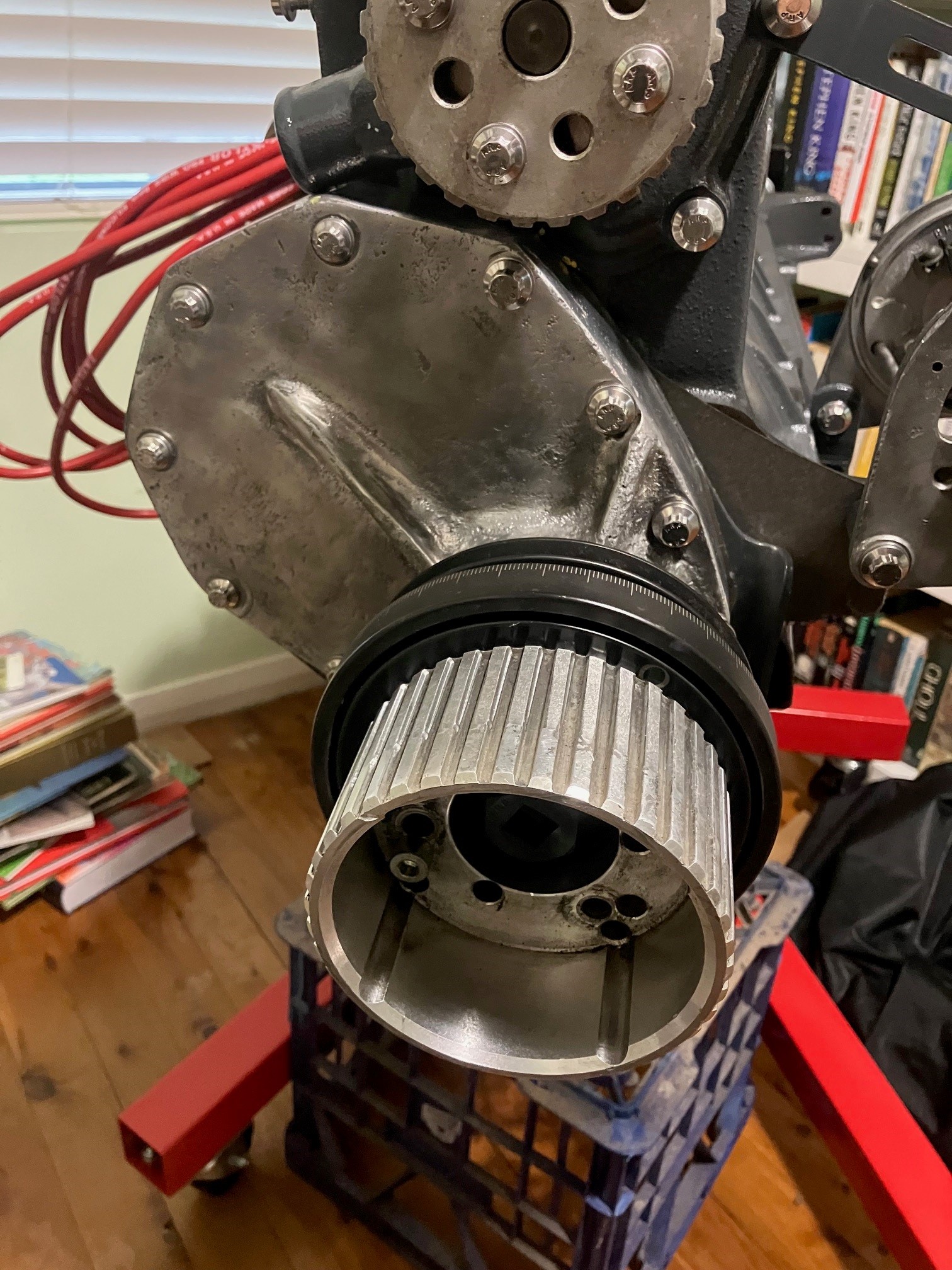

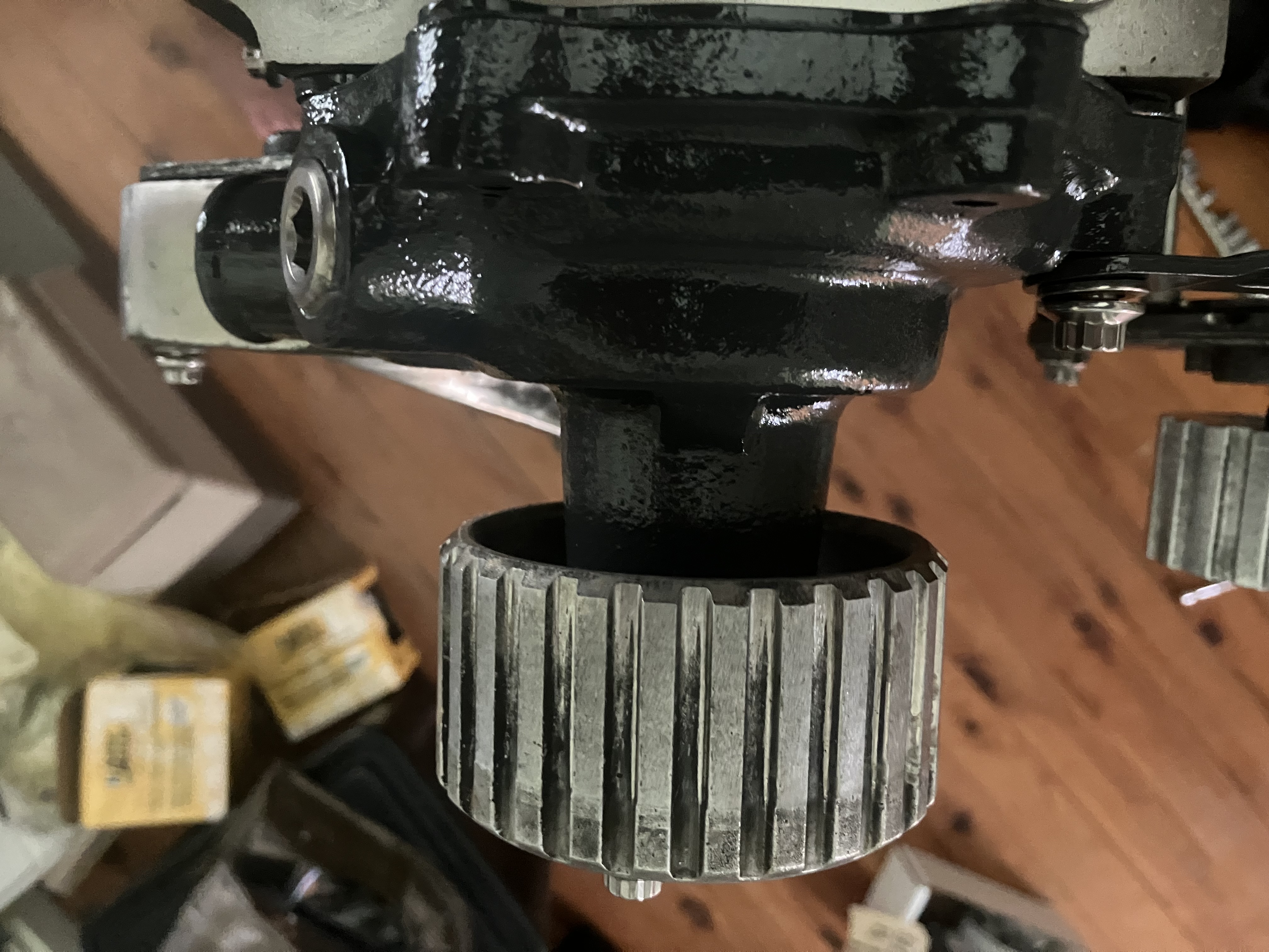

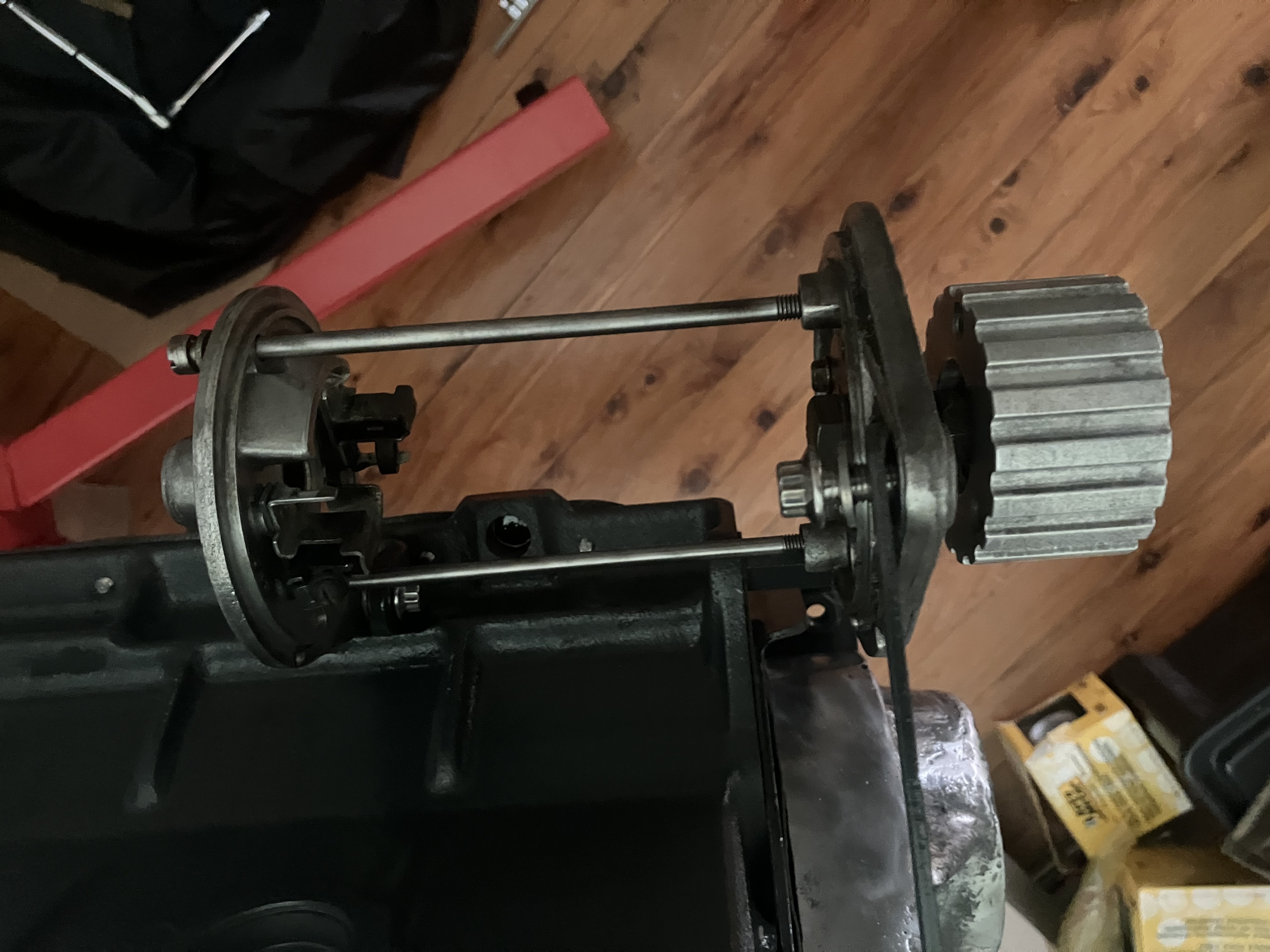

Mocking up, working out how to drive the various ancillaries (magneto, dry sump pump, generator, water pump, fuel pump, supercharger).
If you think the water pump looks frightenedโ€ฆ
โ€ฆ I scared the guts out if the generator ๐Ÿ˜€.
