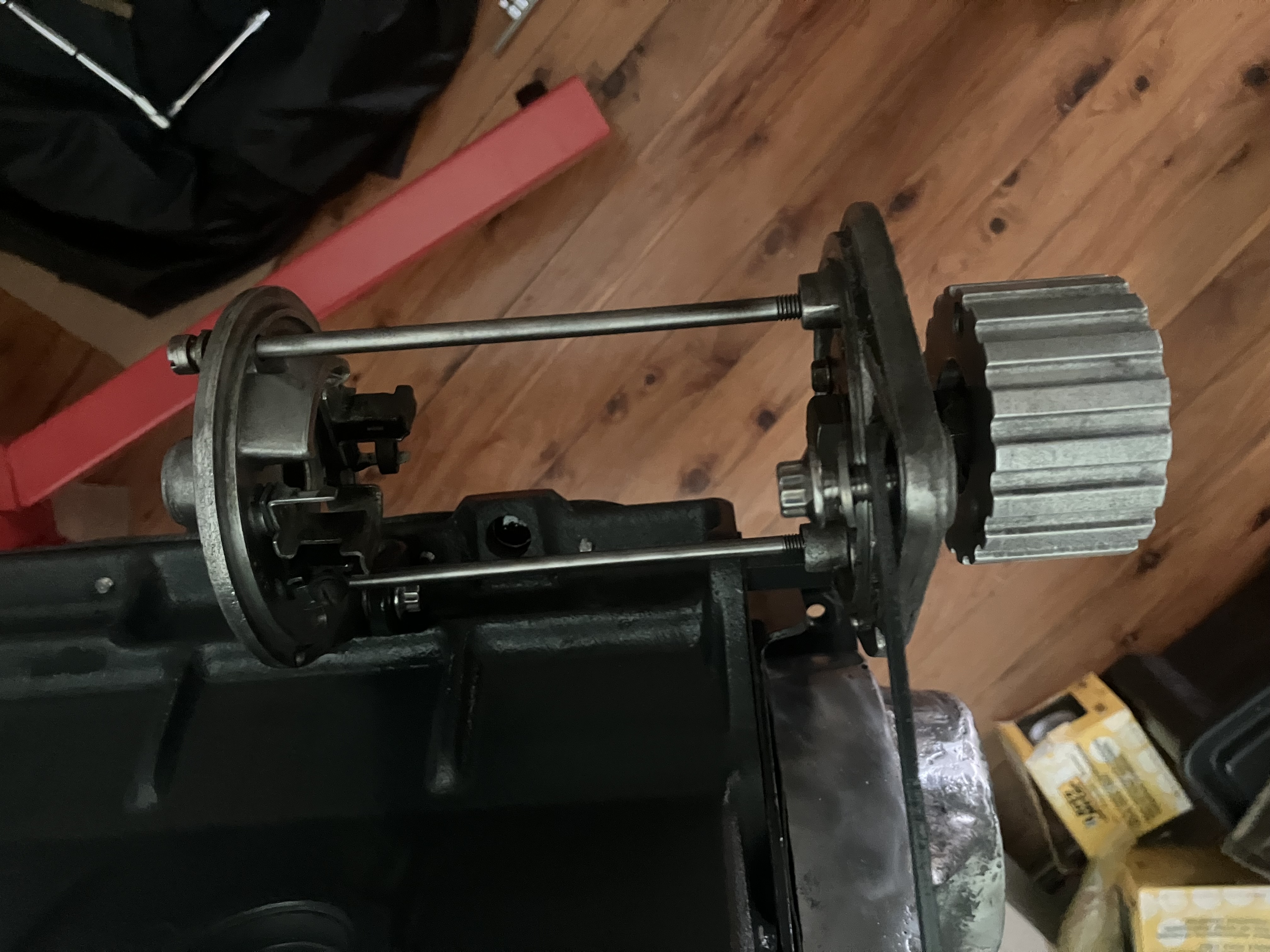

Mocking up, working out how to drive the various ancillaries (magneto, dry sump pump, generator, water pump, fuel pump, supercharger).
If you think the water pump looks frightened…
… I scared the guts out if the generator 😀.
