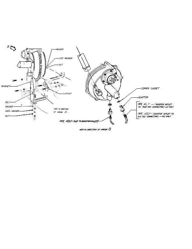

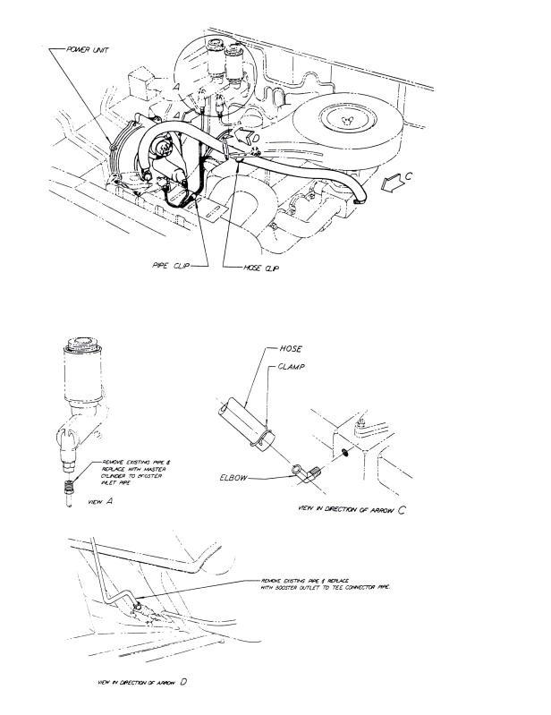

Sorry for the tardy reply... couldn't find where I had stored these - they are how my FB was done:
Mounted mine forward of the steering box - as long as you get nicely bent up lines done they look perfectly fine in there - if it was a show car or a rod I'd go under the guard but with heaps of space under the hood thats the best place for it I think.
Agreed Wally
Thanks Harv
That is entertaining reading. I hadn’t considered mounting east west. It’s done now.
