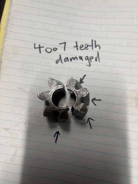

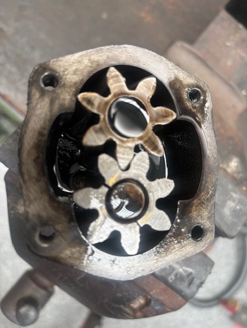

Pump was seized when installed, freed up (but tight) on the bench. On opening, the driven gear had cracked in two. Four of the seven gear teeth had damage to the lower third of the tooth, with a fair amout of missing metal and "grooves" like grinding. One tooth has a chip. Looks like all four teeth rubbed on something. No idea why only four random teeth copped all the damage, would have expected all of them to.

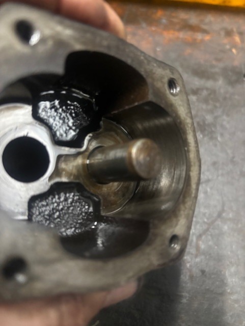

No damage at all to drive gear or casing. Some marks (like machining marks) in the casing, but exactly like the half dozen or so other pumps I have pulled down and rebuilt over time. Weird that there is teeth grinding/rubbing damage but nothing on the casing. No debris in the pump at all. Debris could have gone out the pump discharge into places I don't want to think about.
Hypothesis a): one of the driven gear teeth dropped a chip. No idea why, but pump screen suggests the debris came from inside the pump. The chip rubbed on four of the teeth, wore them and finally jammed. The shock load was enough to crack the driven gear in two, and snap the distributor drive tang.
Hypothesis b): the driven gear split in two for unknown reasons. Hard to imagine, as this vehicle doesn't get leaned on. The cracked gear remained mostly where it should (my mind struggles with this too), but moved outwards enough to rub four teeth. The misalignment was enough to finally jam, and snap the distributor drive tang.

does the fracture line on the gear indicate if it all let go at once or does it appear to have had a crack in it for some time that finally cried enough ?

The fractures on the gear are uniform all the way across, suggesting it let go all at once. Typical cast fracture surface. Sometimes if something cracks, holds out for a while then lets go you can see corrosion in the initial crack. No corrosion here, but then again it was living in a bath of oil. I could look to see if it has the “beach marks” you see in fatigue failure but don’t have a microscope to do it.
Could be worse, at least this happened at low load. Number One Son split an oil pump gear in an RB30 at ten bazillion rpm. That one didn’t end well…
