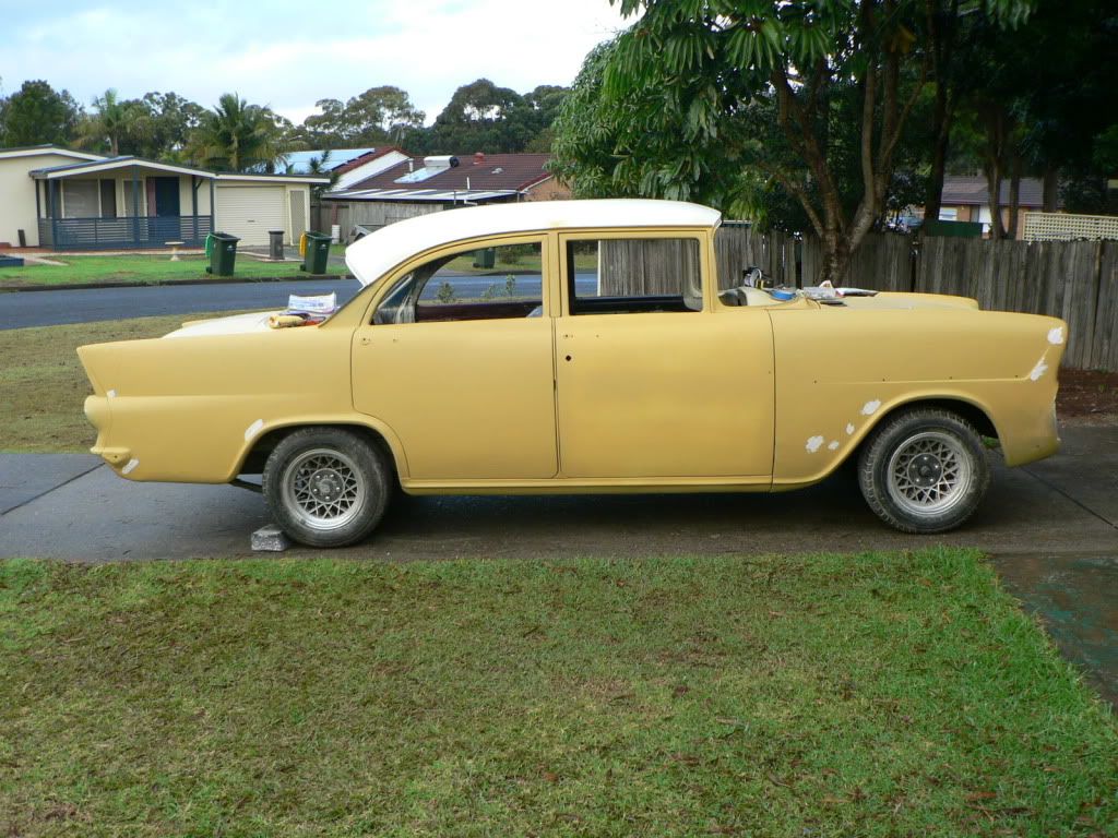

luke and kimmy's ek special - colour done, onto reassembly

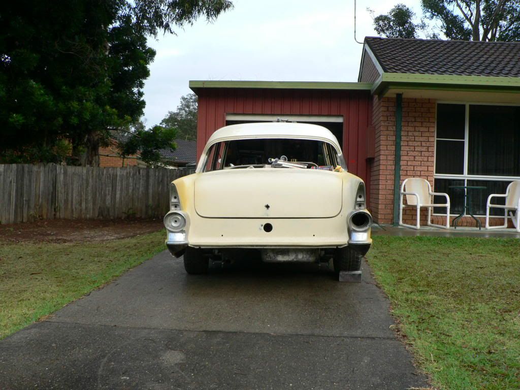

Re: "Zippo" progress- rear end out
Bump for you too Luke..... must be time for an update?

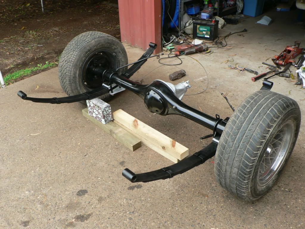

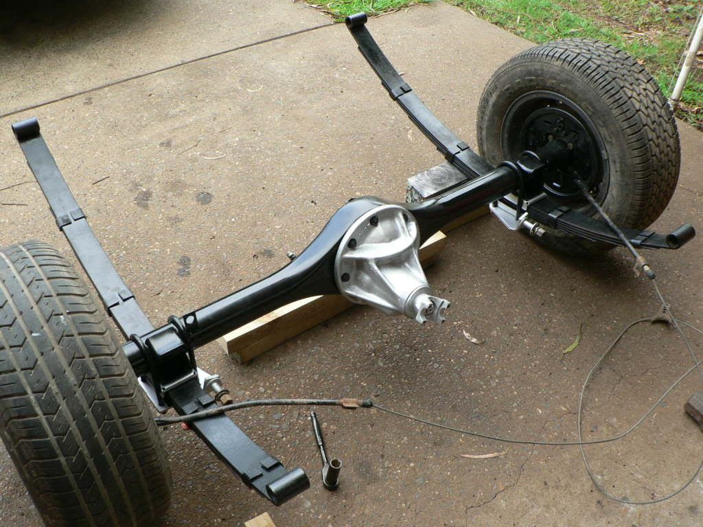

yeah sorry gaz, been sorting out my neighbors f100, lots of rust to fix then a coat of paint for him then a new big compressor for me
about the only thing i've got done is the diff is finished an back in (well kind of, the front spring bolts won't go all the way in. i think they're binding on the nolathane bushes with the crush tubes so they'll have to come back out and fix that

Re: "Zippo" progress- rear end back in
hi everyone,
i got the diff and my rebuild ute springs finished up finally, looks good (well to me it does, not that anyones ever going to see it
then installed with my 2" lowering blocks
finally got down in altitude a bit
looks higher in the front now but measurements say its level, but when i get my hq stubs and p76 rotors organised that'll sort that
i'm now halfway through fitting the b pillar seatbelt mounts so i don't have the ugly bolt showing from the outside of the car (i really hate that look

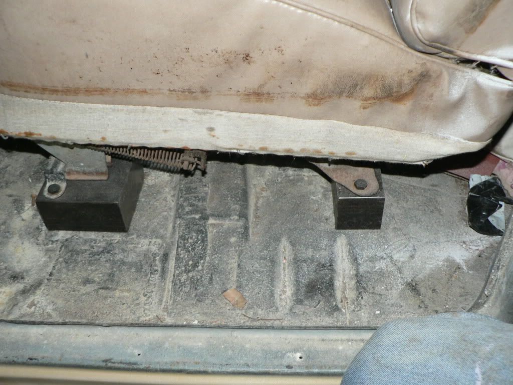

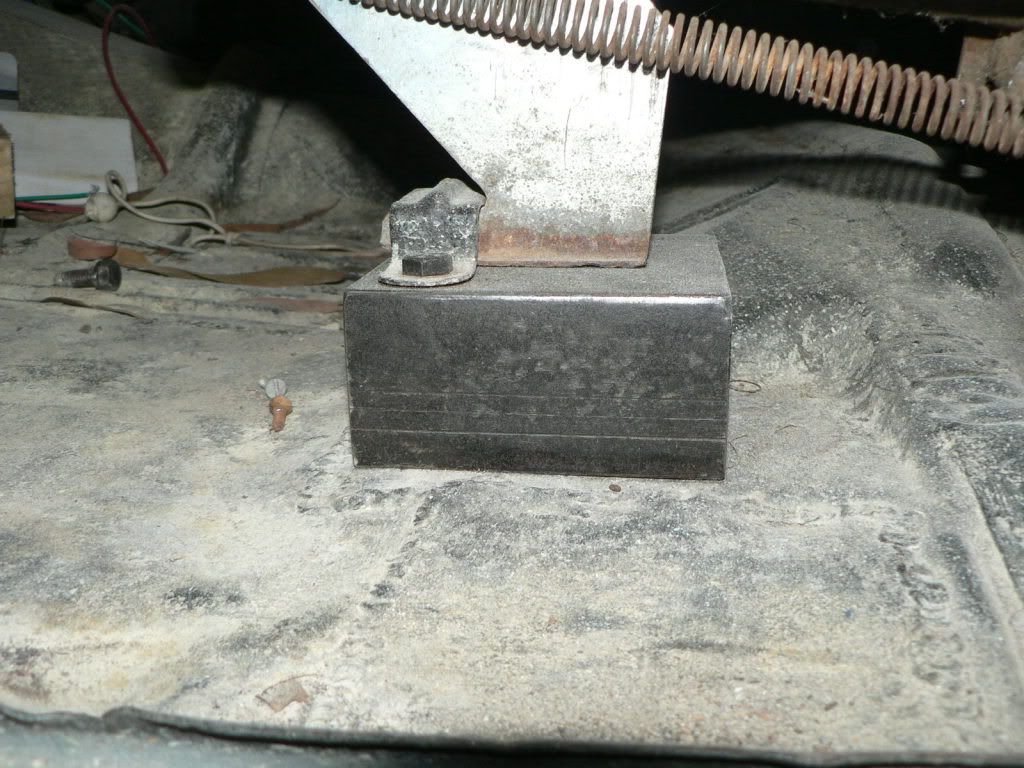

well, with rain pissing down, and not having a full size workshop to play in

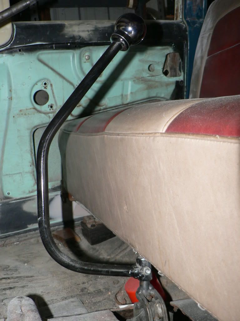

big stuff like spraying is on hold. so...... i fitted up my front seat for fittment of my gear lever! i have bent it up myself so i could clear the seat but instead of cutting out a hole in the seat i did this.
which has given JUUUST enough roof for the shifter.
and the finished product. it still leaves enough clearance to move the seat backwards and forwards the entire track length (i wouldn't like to be centre passenger with the seat all the way forward though
hopefully the rain will piss off so i can get back to bodywork (i'm about a fortnight away from colour
cheers, luke

Hey matches, you probably already know this, so forgive me, but you'll have to get an engineer to pass those seat mounts. They look solid though!

Be careful with the shifter as the weight of two people on the seat may push down on it. Have you sat in the seat now its raised? Steering wheel to leg may now be a lot less of a gap..

styg, yep the mounts are solid 100x50mm mild steel (so my engineer better not tell me he wants crush tubes

DR, thanks for the idea, i have sat in there with kimmy, but if my brother got in the front it could be another story (he's a big bugger
)lol
i'm running a 13 1/2 " banjo string wheel so i can get in under the wheel without any drama (if i had the original in it i'd be in trouble)
cheers, luke.

if seat height was an issue it looks like you could still take a little out of the base of the shift or if yor confident with yor welding or got someone that can you could weld yor bent stick directly to the base
i had simular blocks under the front brackets of the seat to lay the backrest part of the seat back a little the engineer wasn't concerned with it and mine were made of wood
i have seen some in HR's and H/KTG's and they looked to be factory as they were all the same made out of plastic or nylon
Re: luke and kimmy's ek special sedan
I agree with RB, weld the shaft onto the shifter a bit lower, I also would be looking into dropping the gearbox down a bit under the car, just needs more clearance
, Trev
