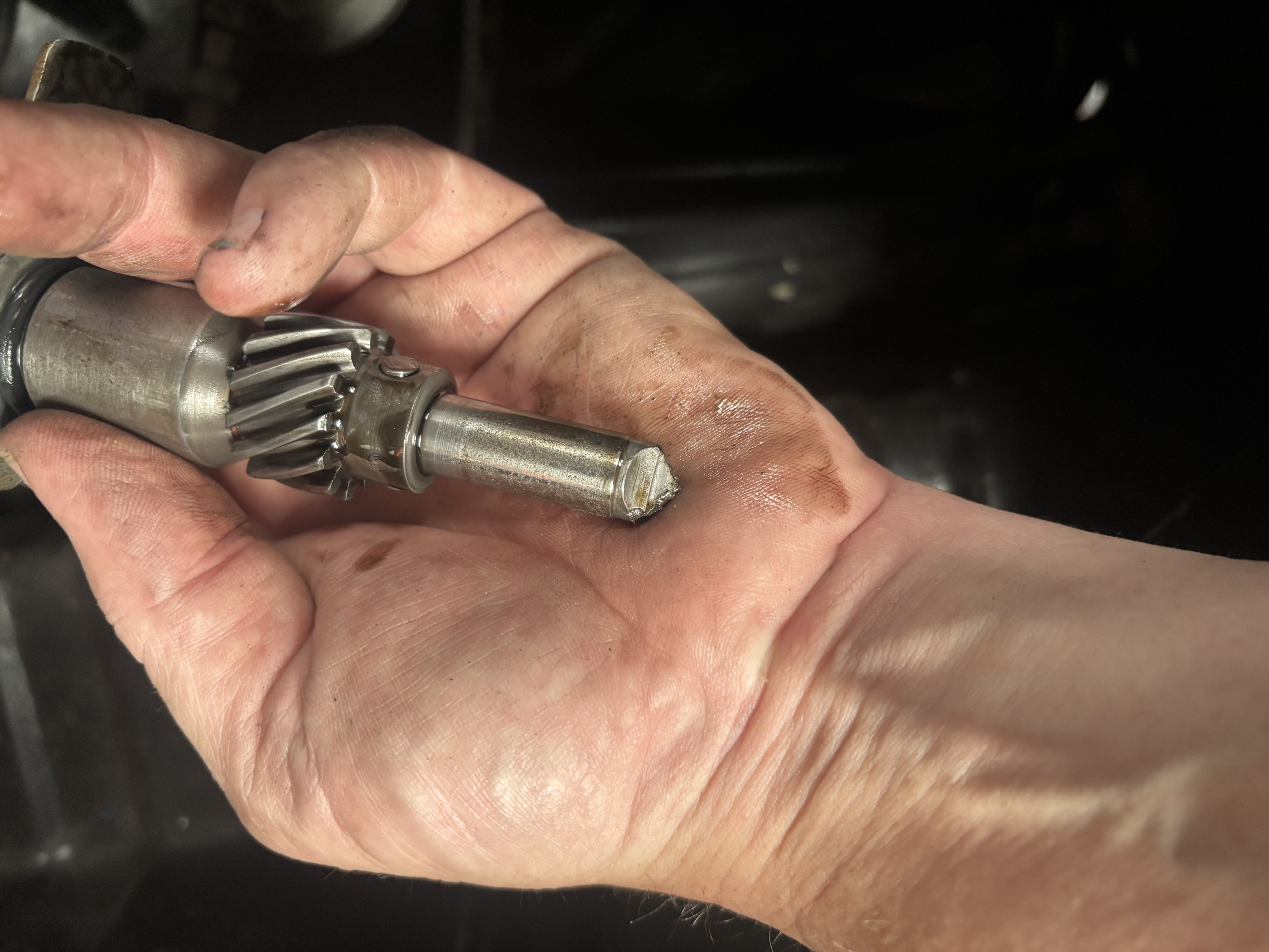

Fixed the blown head gasket in the wagon (all bar one rocker cover that does not want to seal :roll: ), trundled the wagon out and Graces ute back in.
Pulled the utes dizzy…
Said bad words. :silent: :(
Screwdriver down the dizzy hole, and oil pump is siezed. My bet is that the pump screen has let some crap through, it has jammed the oil pump, and the siezed pump took the tang off the dizzy. It has a steel timing gear, otherwise the fibre one might have let go instead of the drive tang… mebbe.
Motor now needs to come out to get at the oil pump. First I need to rig a lifting point in the new shed. One way to christen the shed I guess.

by ardiesse
Harv,
That looks fairly conclusive.
The next step depends on whether you like working under a car. Under "Minor Service Operations" in chapter 6 of the EK shop manual, the instructions for oil pump service are somewhat like this -
1. Remove front engine mount nuts, jack up engine and support with a suitable piece of wood.
2. Remove front suspension assembly.
Evidently without irony.
