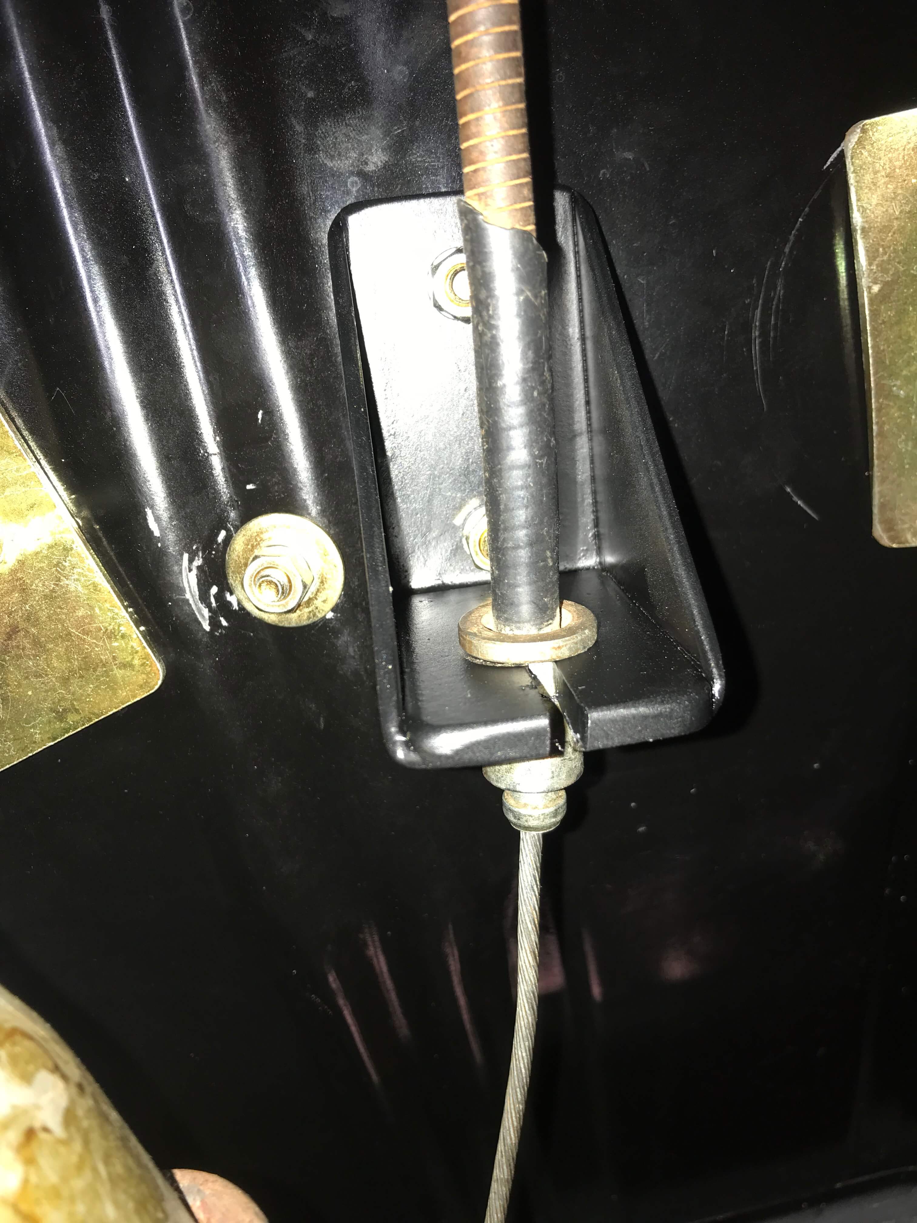

1. Whats the length of the tailshaft your using centre of uni to centre uni?
2. With the vn handbrake cable how did you mount the outer cable sleeve to the body?

I’m not sure of the driveshaft distance, but learnt the hard way that it is very driveline dependent. I had a whole new driveshaft made up by Sydney Driveline Services, and had it running on the car. Stripped everything down to get it painted, and bought a rebuilt TH350 box. Put the engine and box back into the car, only to find out the driveshaft was now too short. Learnt the hard way that TH350’s came out in three different extension lengths (6”, 9” and 12”), and my new one was shorter. Can’t easily swap the extensions (unlike a grey crashbox). Had to get another new driveshaft made.
For the VP Commodore handbrake cable I used the existing EK brackets on the rear subframe to hold the two cable ends. For the front of the cable, I made some L-brackets that keep the front of the cable off the floor, driveshaft and exhaust. The engineer was not happy with my brackets, so the brother-in-law made me some new, heavy-duty (boilermaker-rated) gusseted ones.

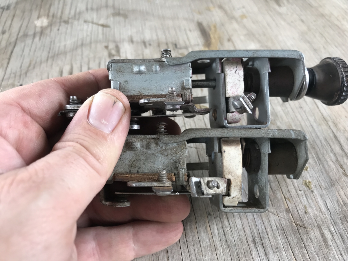

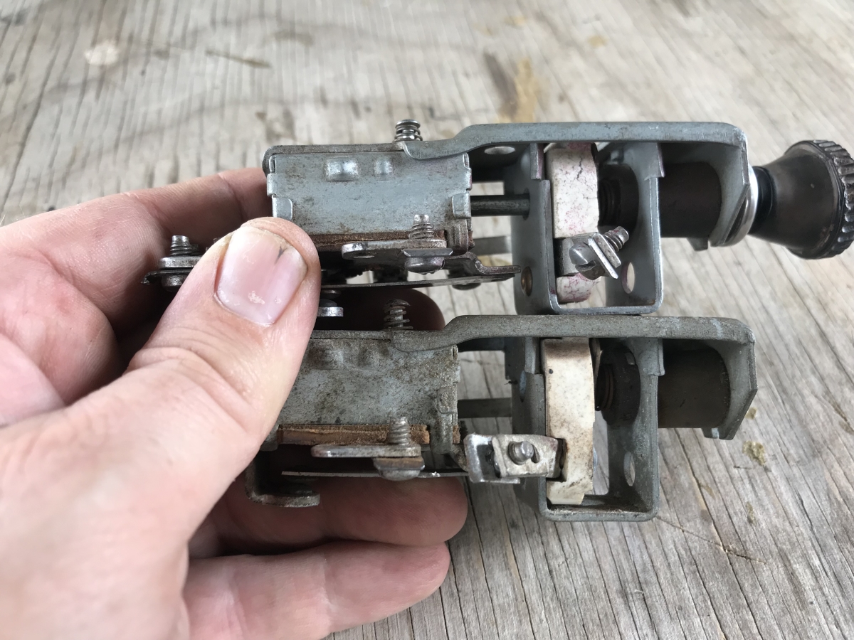

Went to fix the faulty gauge/shifter lights. Traced the wiring back, all looked ok. Pulled the dash out, pulled the lighting switch. Found the lighting switch had a bent tab where the gauge lights get power. It’s supposed to look like the top one in the photo, not the bottom. Tab had shorted out on the lighting switch body... every time I turned on the headlights, I had a fault to earth. Fire waiting to happen.

Went to straighten the tab, and managed to shatter the ceramic insulator for the gauge light dimmer. Swore. Twice. Broke out the rest of the ceramic and resistor wire. Connected gauge lights direct - no dimmer. No great loss, and I guess gets rid of the dodgy dimmer resistor.
