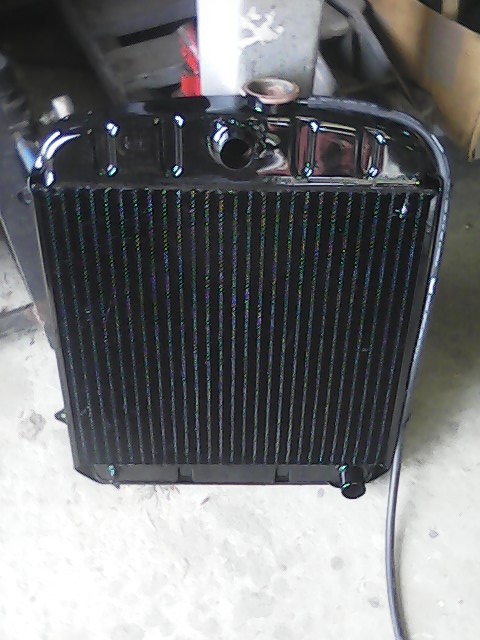

This week the radiator gets a birthday. Luck is on my side and the old honeycomb core has survived with only needing a some leak repairs and rodding through. I also ended up fitting an oxygen sensor bung in the engine pipe for some testing and mixture setting as I have some combustion roughness occurring around 2800 Rpm. Mixture is ok so I've knocked a few degrees out of the timing to see how that goes. I was concerned I was running too lean and worried about burning a valve or worse especially with towing. I'm now thinking I am bordering on detonation and too high cylinder pressure rises at that RPM. I may need to eventually recurve the dissy slightly.
Re: Seagull Grey EK 2106
Posted: Sun Apr 23, 2017 9:57 pm
by rosco
Radiator looks schmick, Craig - nice work.

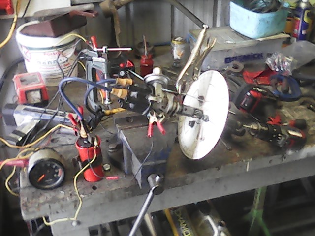

Ok so I've made a start on working out how to test the curve rate on the dissy. After some adaption of a camshaft degree plate and using a variable speed drill I think I've got it. Points to note:
Degree plate readings must be doubled to calculate crankshaft degrees
You may need an oil can so as to drip feed some oil for the dissy shaft lube if your going to run it constantly
Cordless drills do not like being overrun in the opposite direction when they are turned off - reduce speed very slowly
You can't use a battery charger as a power supply as the voltage regulation in the charger causes erratic tacho signal
You must use all leads and spark plugs as opposed to just using one due to excessive coil dwell saturation and spark scatter in the cap

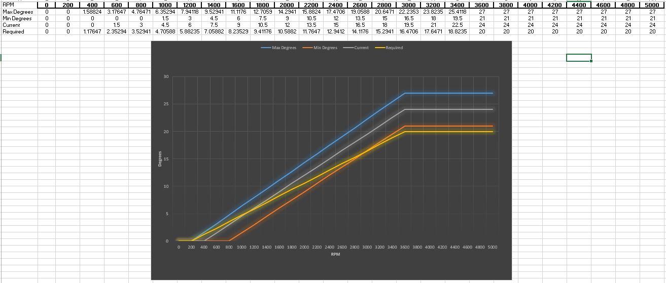

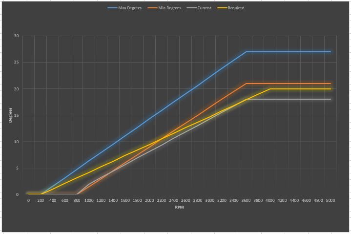

So far I have plotted the standard spec centrifugal advance rates and a spare dissy that was from a boat motor. I'm now into doing the one in the EK to see where its running at.
The blue line represents the Maximum allowable (standard spec)
Orange line is the minimum allowable (standard spec)
Grey is the curve as tested on a spare distributor
Yellow is where I think I should be with a high lift cam std duration
Initial timing and Vacuum advance isn't included as yet
A few initial checks where also done with respect to checking the timing marks relative to crank position as well as ensuring I didn't have a hydro flywheel ring gear which would put the marks at 6 degrees initial as opposed to 2 degrees for a manual.
(Every ring tooth equates to about 3 degrees on the flywheel).
I'm also looking at checking the indexing of the rotor button as I belief the Pertronix Hall effect magnet switching points are sightly different to where the points would switch. This has shown up with arcing wear on the very tip edge of the rotor button and terminal points for each lead. Basically the rotor button needs to be in the correct position next to the respective terminal point for each lead when the spark fires and must be as close as possible relative to degrees advance position (width of the rotor button).

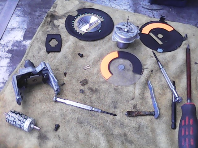

Initial testing done today and stripped down the distributor out of the EK.
Major things found were:
Excessive end float on the main shaft as the fibre washer had disintegrated. This would have caused timing to wander.
Slack weight springs with weights not returning fully.
Insufficient vacuum advance travel 0.050" short which equates to about only 5-10 degrees (should be about 10-20).
And the Biggy was the Pertronix magnet. Once I had altered the centrifugal advance rate and then added extra vacuum advance I ended up with a misfire at light throttle cruising speeds. Full throttle the miss went away so this indicated it was relative to position of the breaker plate. One thing I have always noticed was that the rotor button never aligned back to the standard mark on the distributor body after fitting the Pertronix. After making changes to the centrifugal advance, resetting the base timing, then altering the vacuum advance start position (breaker plate), this put the rotor way too far away from no 1 terminal which caused the miss fire. I now know the 6 internal magnets in the Pertronix are not positioned to switch at the same spot as the points would. Anyway I refitted the magnet over the cam opposite to what it should be (this took some force and I don't know how it didn't break). Now with the base timing set back to 2 degrees as standard the misfire is gone, and when you remove the cap and check the rotor position it is correctly aligned to the mark on the distributor body when the flywheel at 2 degrees BTDC.
The last graph done is as close as I can get but will move up 2 degrees or so and better suits the slower advance rate needed for the cam. I think its as good as it gets without going fully electronic. These things were made to be standard or close and not very accommodating to refinement when you make changes. The problem with mechanical distributors is that they are pretty much linear in operation and engine mean combustion cylinder pressures aren't linear with revs. Change the cam grind slightly, fit oversize pistons, shave the head and up the compression a bit, and its all enough to throw it all out of wack. The joys of modification.

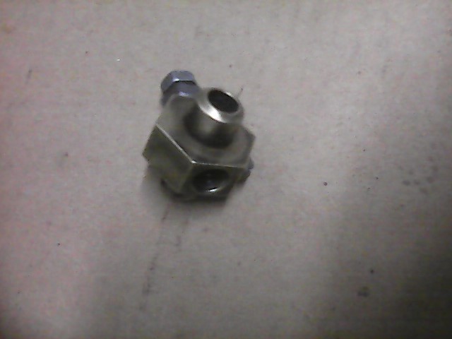

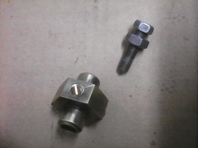

A little bit of rework on my oil feed restriction to the rockers. So far it's all good with no oil out the breather but oil is slower to the top end on first start up now the weather has got colder as would be expected. Used a 1/4" UNF bolt ground down to a tapered point. Drilled and taped a hole at the opposite side of the oil inlet. 1 flat on the bolt equates to roughly .005" adjustment. Adjustment can be done by just removing the oil filler cap and accessing through the filler hole in the rocker cover. My first adjustment will be out about .050" and I'll work back from there. Just a balance between a good oil supply initially when cold and not too much when hot and revving hard which causes so much oil out the breather. Must note that I run the bleed hole blocked.

Good work, Craig - I'm doing something similar to you at present, but the scale I'm working on is in micro-mm's... not 10th's.... building a needle valve for a small (0.74 cc) diesel engine.
I fully appreciate you wish to control the amount of oil passing over to the ventilation pipe - but, there is a reason this motor is causing more oil to flow out than would probably be the norm..... something will show up one day, and the revelation to us all will be noted.
