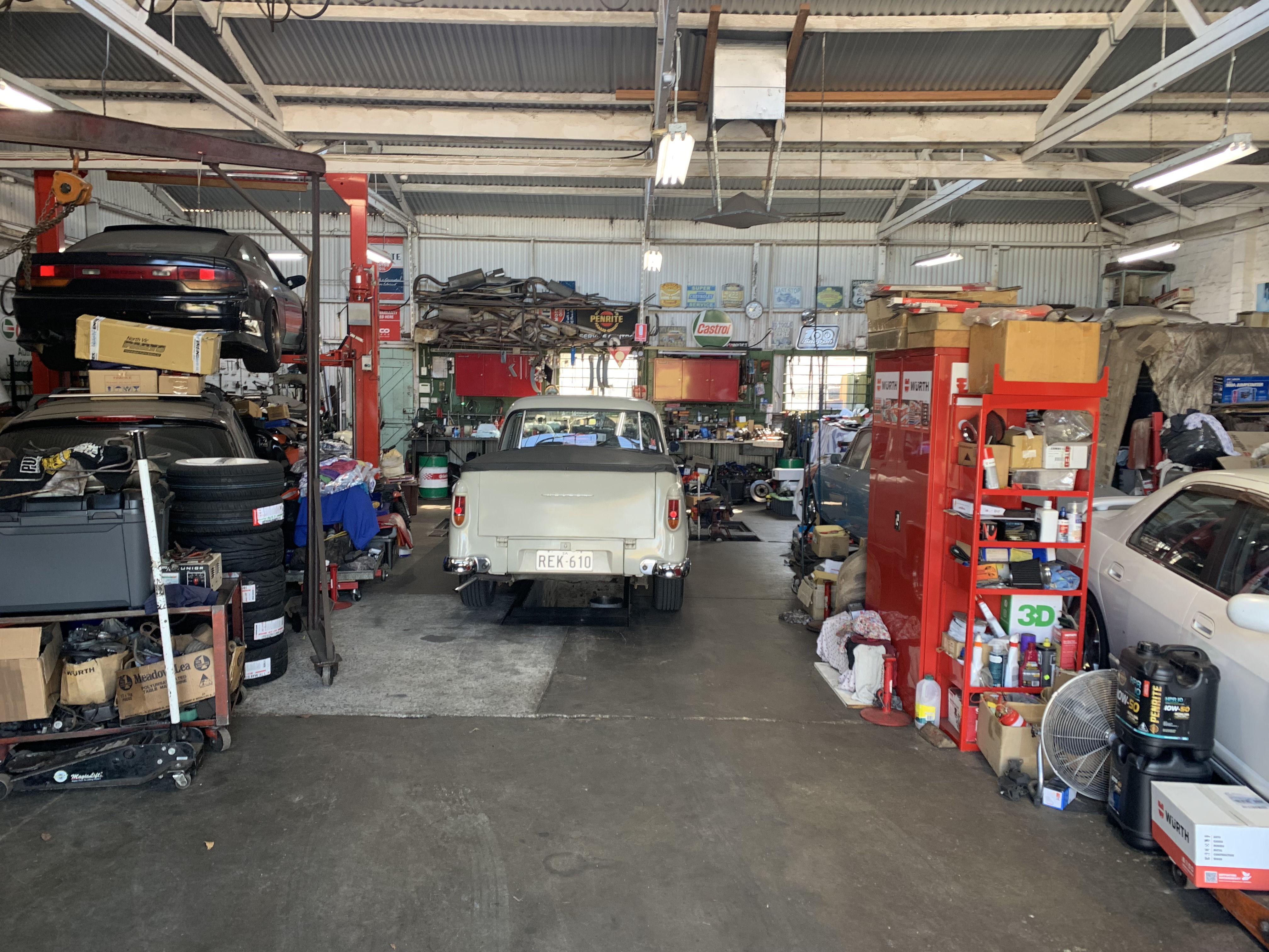

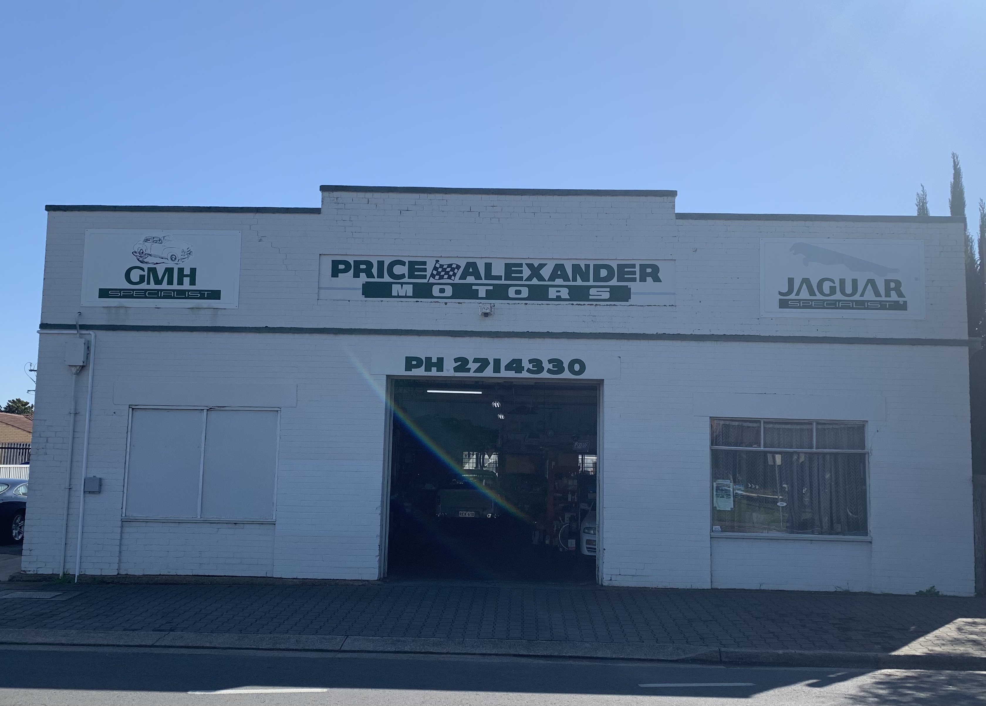

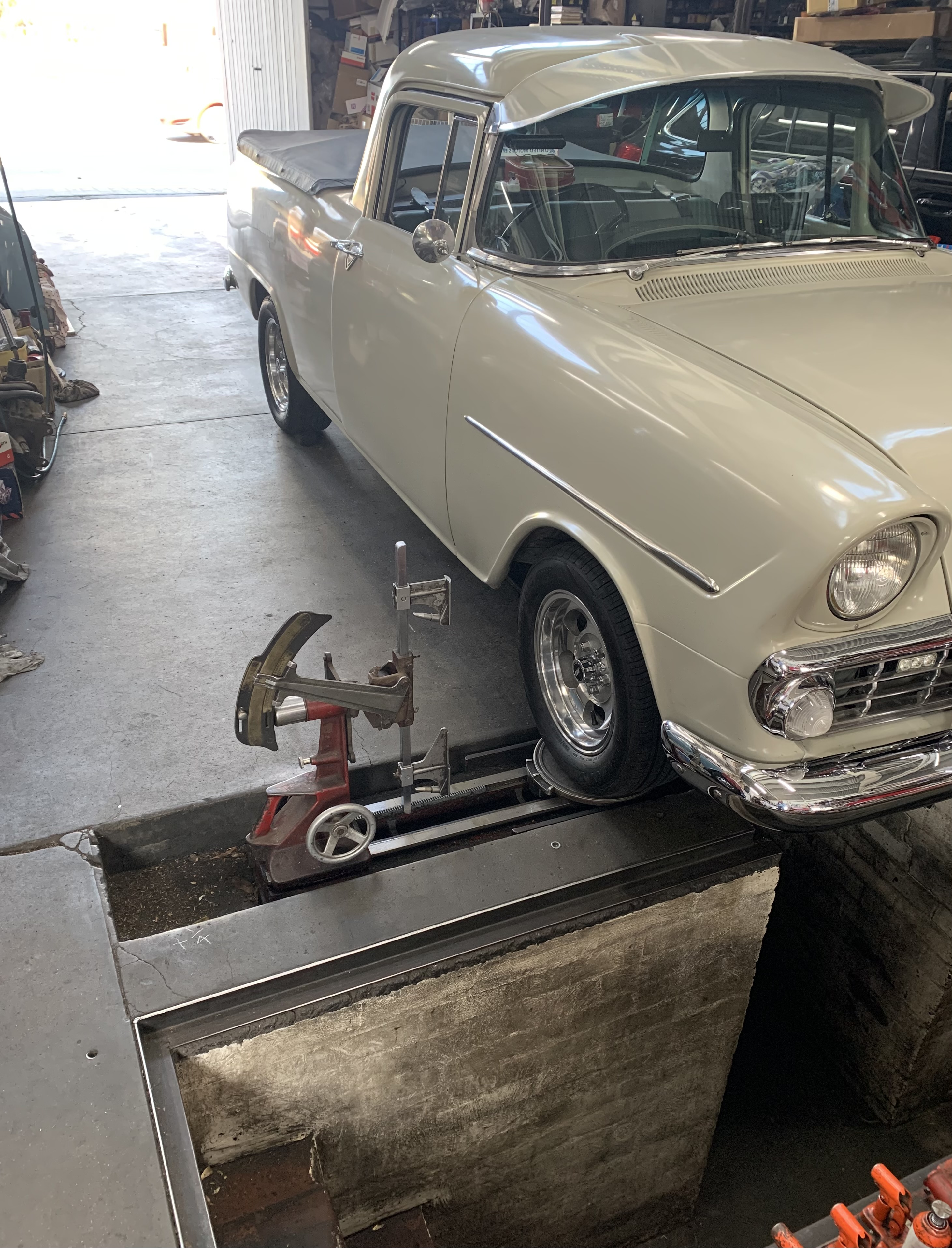

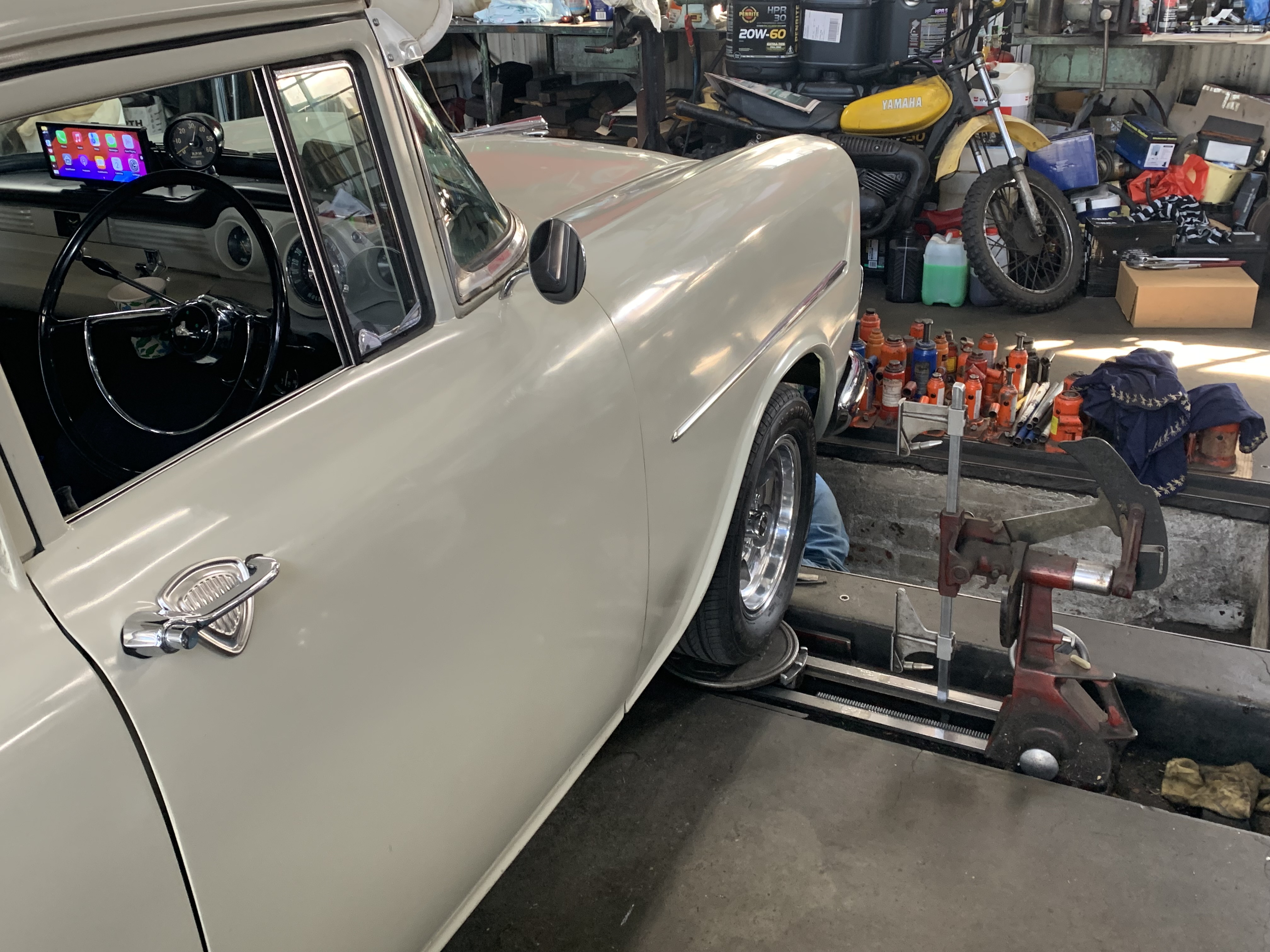

Fitted up the new tie rod ends that went smoothly. Then off to get a wheel alignment. Found an old school mechanic who was great. He works on the old school stuff and is around the same vintage as you folk on here :lol:
He has a Servex unit, which you don’t see many of. He adjusted up the drag link, reset the toe in and camber. Handles a lot better now. The garage has been around since just after WW2.
GMH Specialists
GMH Specialists
Posts: 11663
Handy to know.
Posts: 14269
He must have been there a while - still has a 7 digit phone number !!!!! :lol:

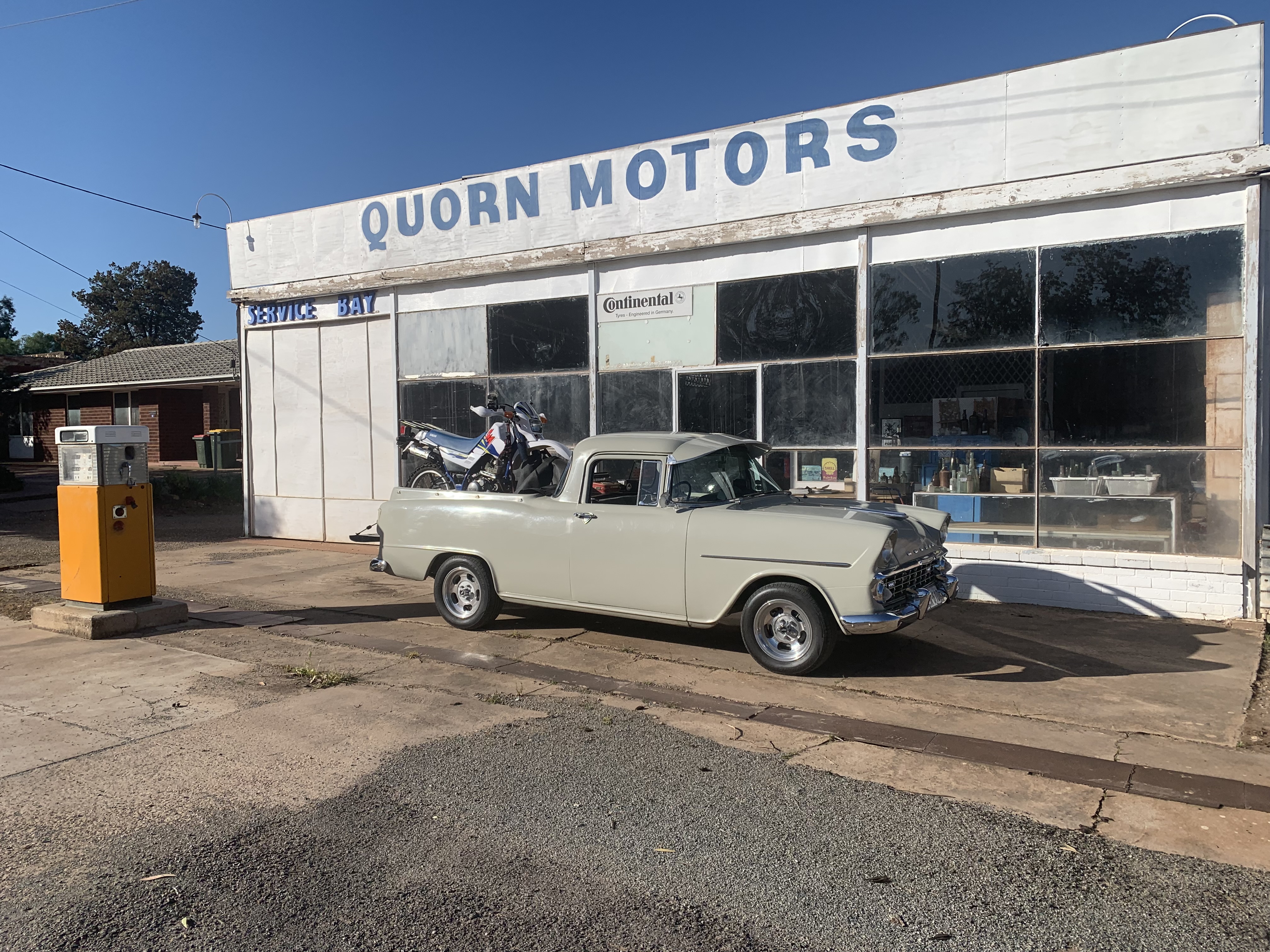

A nice cruise north 😎
Posts: 11663
Teague brothers, or is that hawker?
Posts: 2283
Teague motors at Hawker

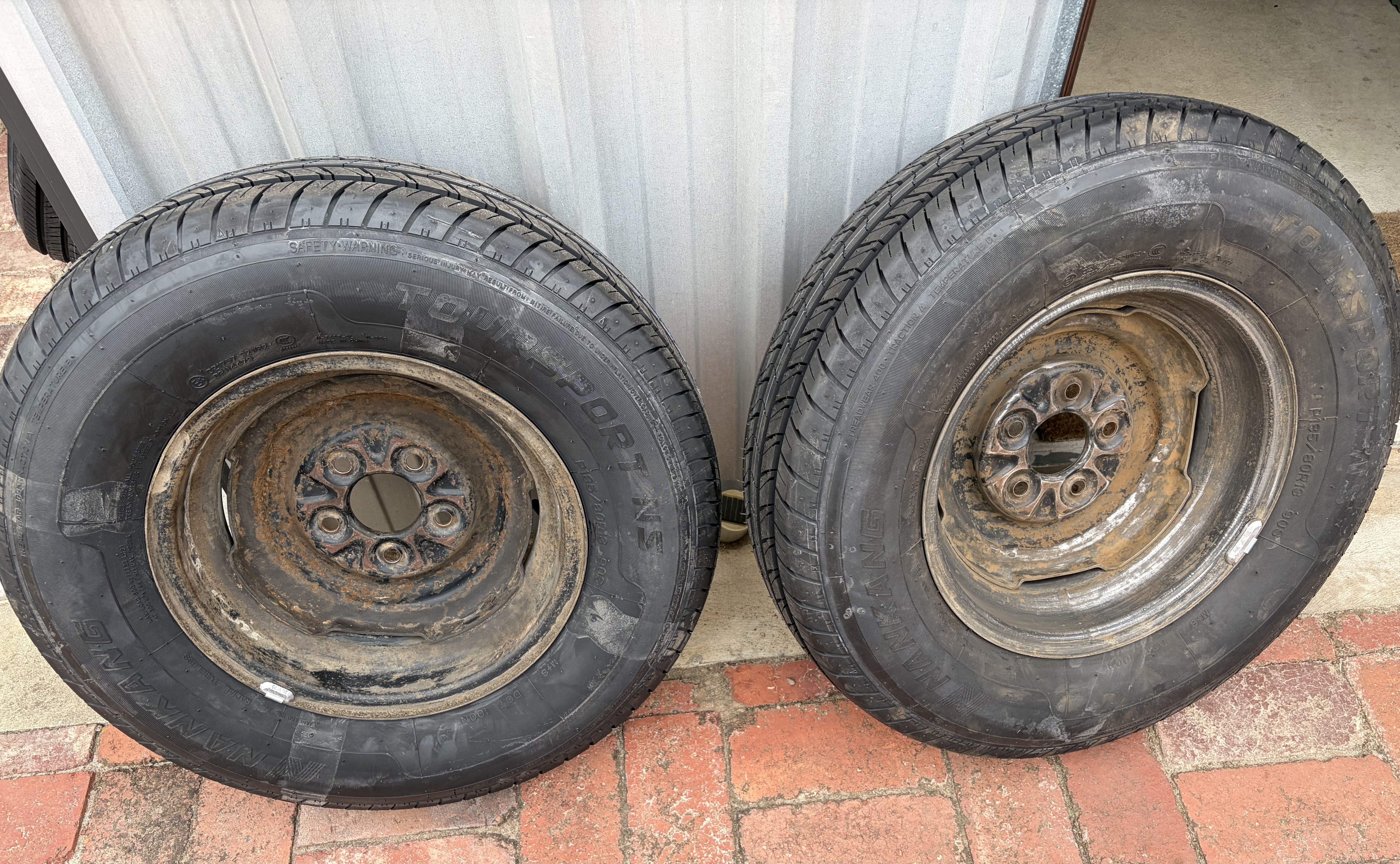

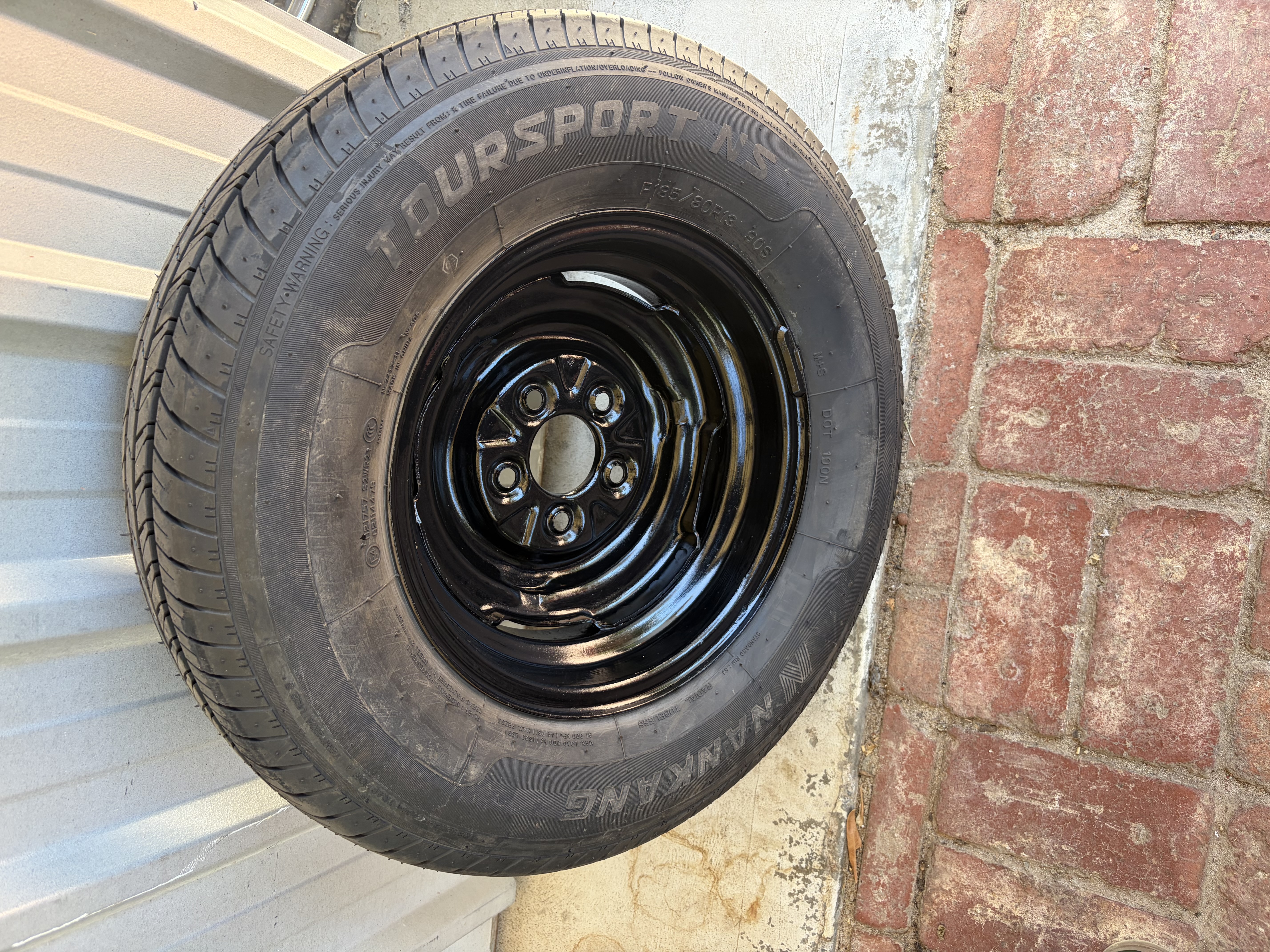

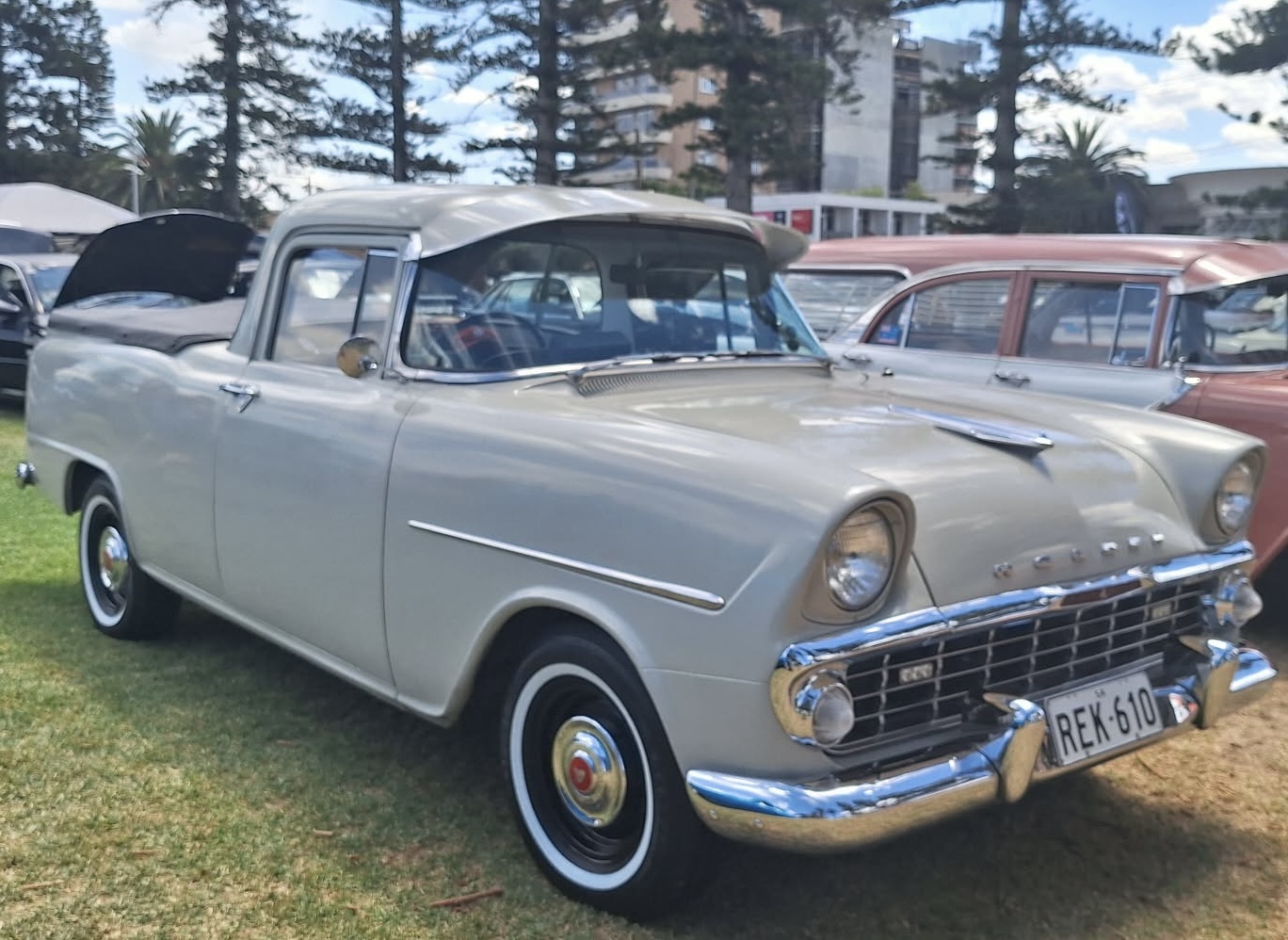

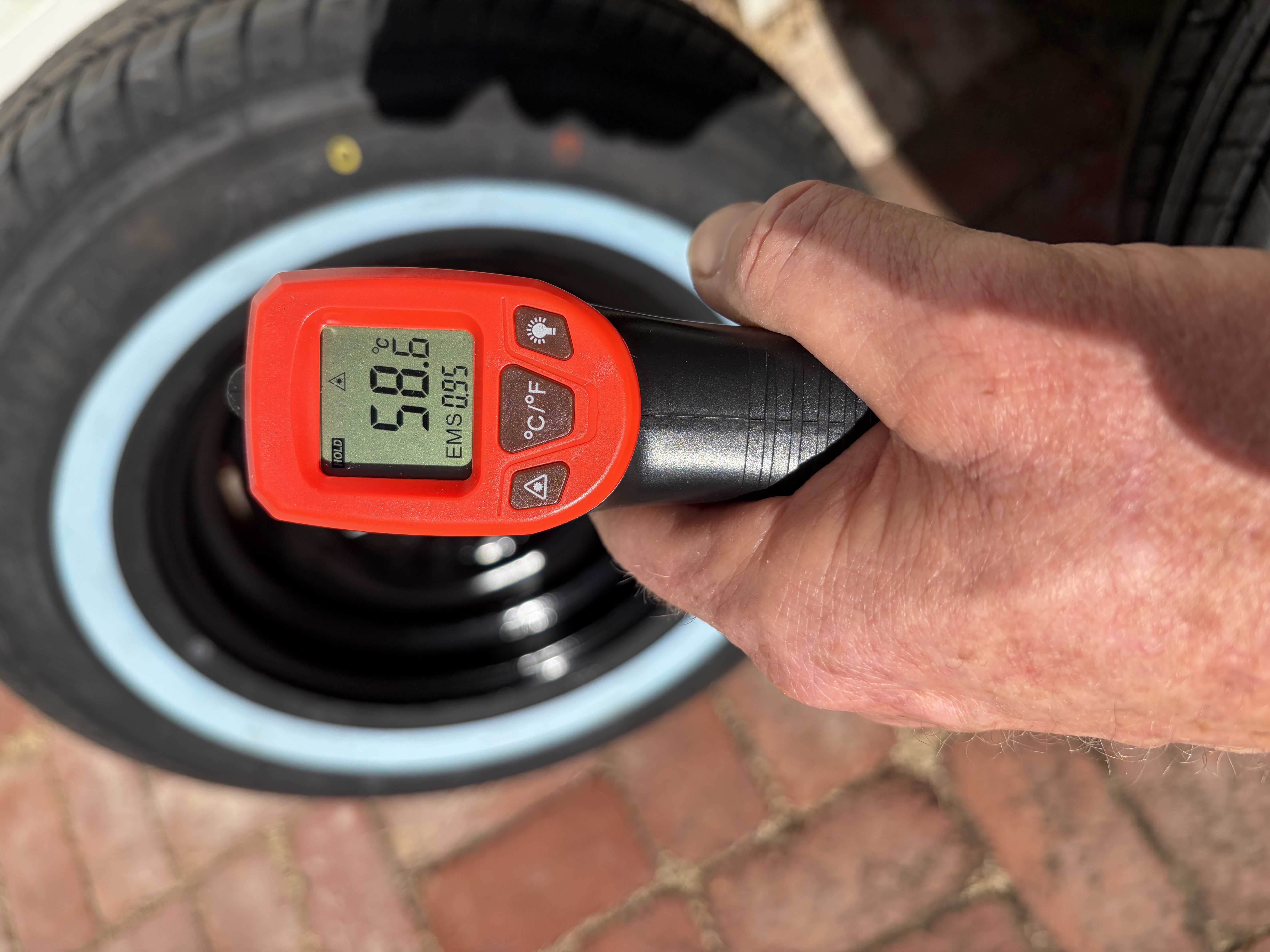

It was about time to get some new treads on the Ute so pulled the wheels off and gave the rims a hit with degreaser and pressure cleaner, then off to get 185/80 x 13” tyres fitted up (Nankang). Whilst the wheels were off prepped the rims and painted them with gloss black paint.
Put them in the sun to bake the paint and bolted them on. I normally run chrome dress rings but with the whitewalls it looks a bit too much bling so this is how it looks for now. Did a speedo check (with a gps app) and it is reading spot on. :thumbsup:

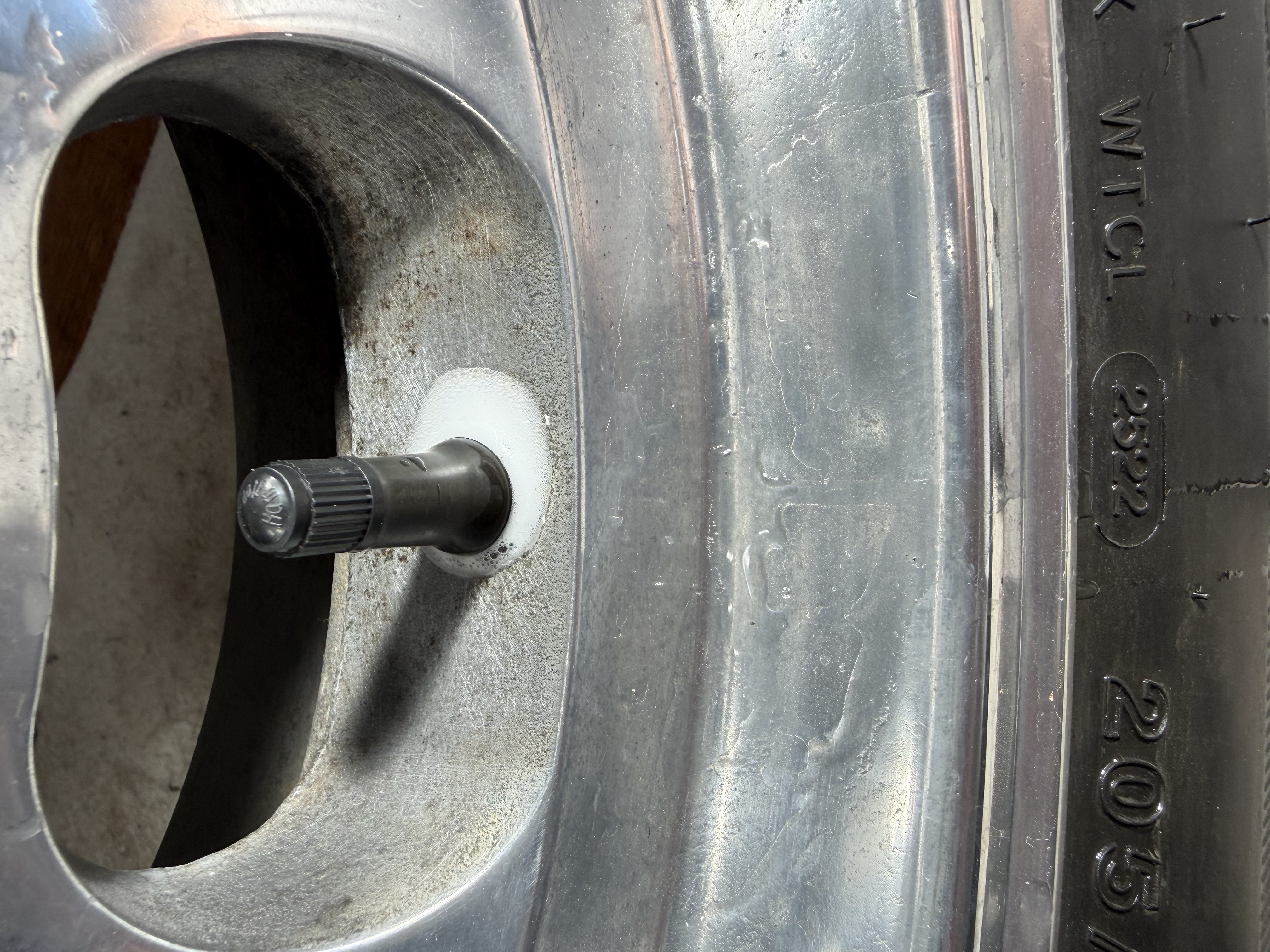

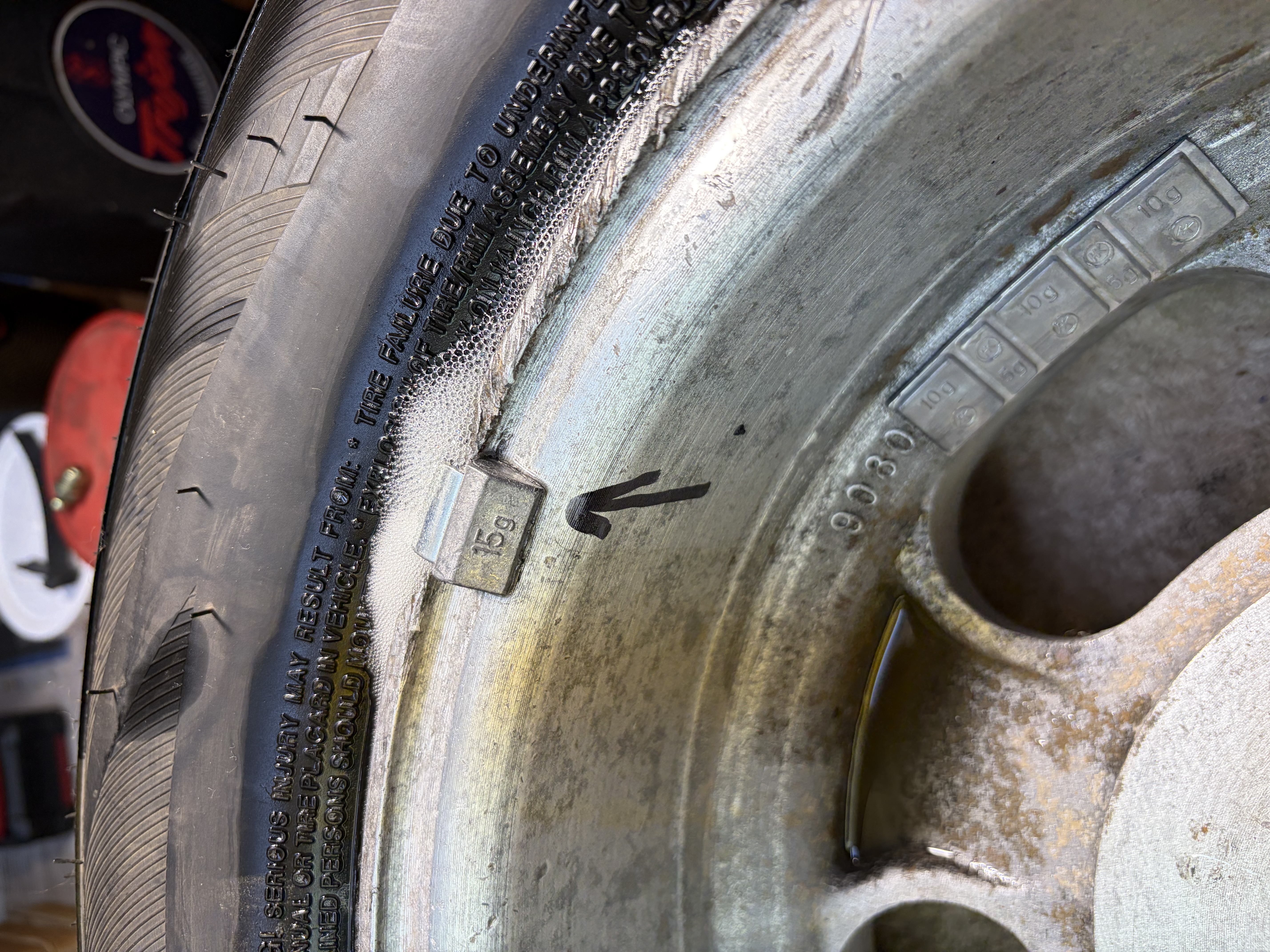

With the 14” jelly bean mags, I got jack of having to pump two wheels up as they would lose air after a week. I assumed the rims were porous as others have suggested but thought I’d get a soap mix on all the wheels and see what was going on. Found the problem…….. No wonder they were going flat :shock:
Took the wheels to my local tyre place who have been brilliant and they fixed the issue. The faults were not their doing it was the clown (shark) I bought the wheels from. All fixed with the wheels holding air after 5+ weeks……..yah!
