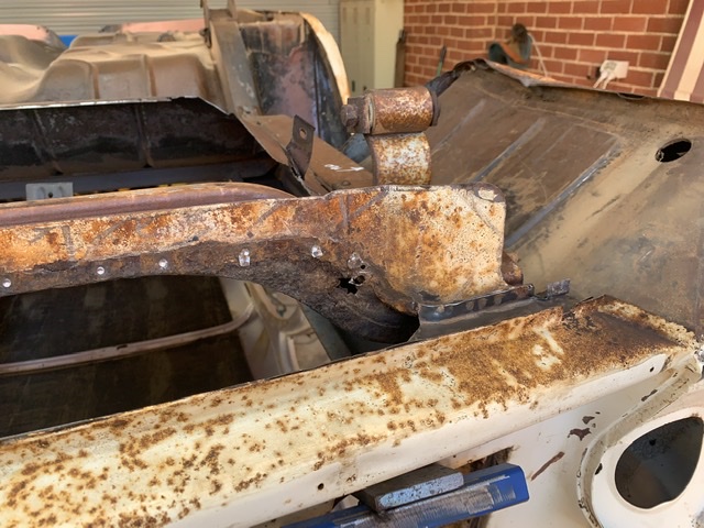

I must say I’m not too happy with the visual aspect of that repair.
Dogs breakfast to be honest but it won’t be seen.
Was also in a difficult area to access so cutting and welding was pretty awkward.
I can see the value in a good panel beater who makes repairs look like that are not there.

FbSTDwagon wrote: Tue Jan 19, 2021 8:31 am I must say I’m not too happy with the visual aspect of that repair.
Its hidden , its strong , its been treated behind to prevent a re occurrence, I would call that a good repair - save the invisible stuff for where it really matters. :thumbsup:

It’s all subterfuge drew, and that is what most repairers are good at.

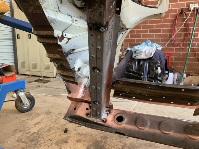

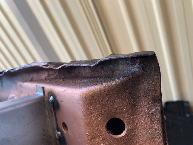

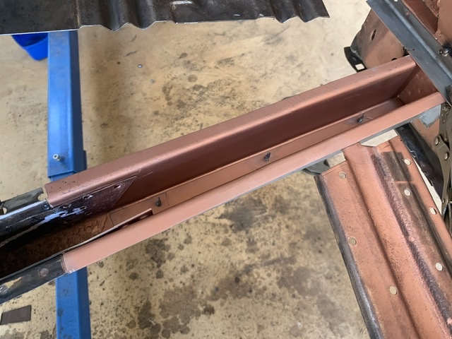

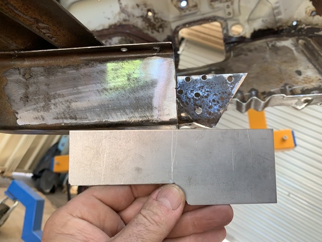

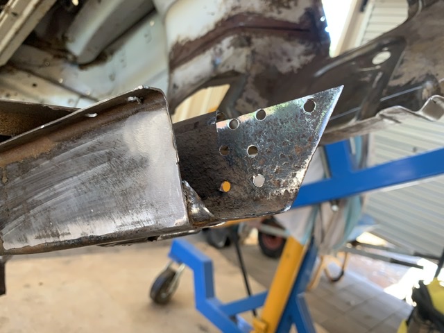

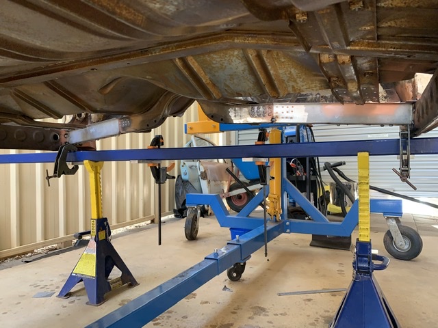

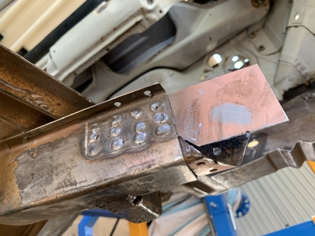

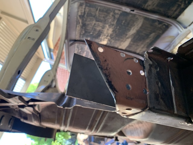

So I spent the last couple of days working on the chassis sections.
Pins holes proved thin metal over larger areas so the repairs became substantial.
I got sections bent up at my my mates workshop out of 1.6mm cold rolled sheet and I’m heads down bum up into it.

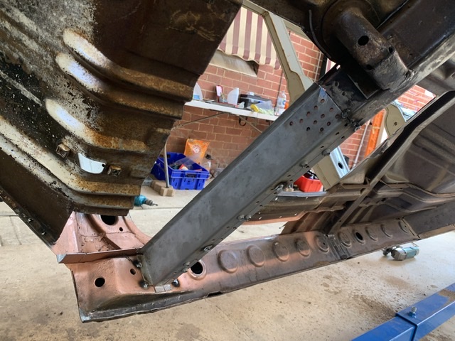

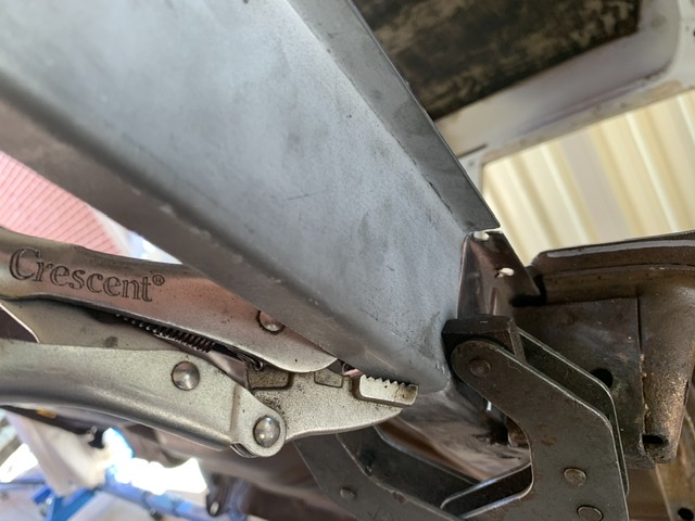

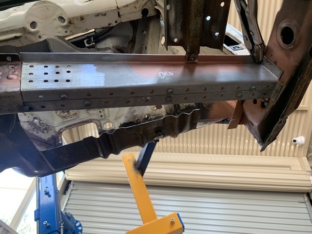

Setting the sections in place
Drew

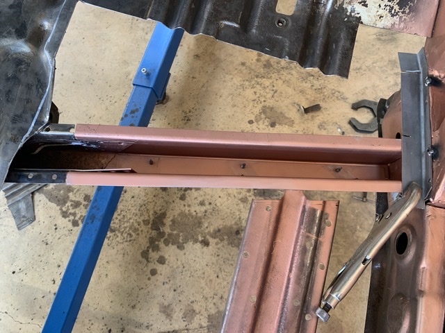

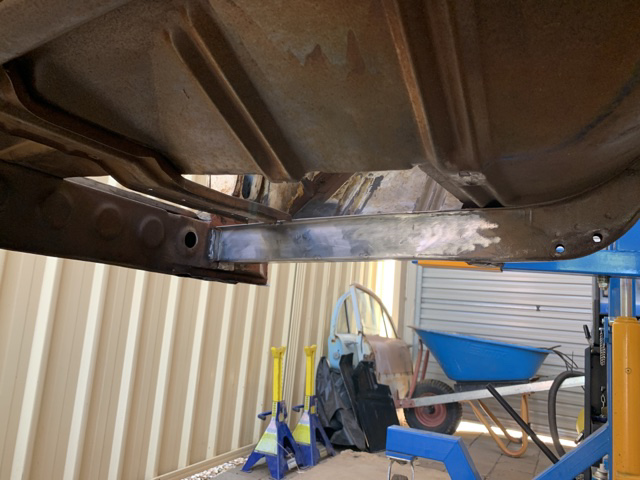

All tacked in place with everything lined up well

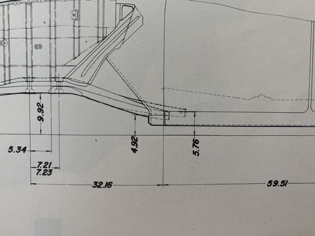

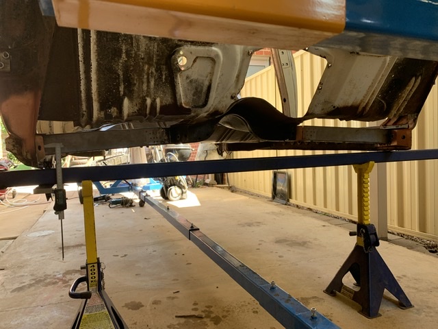

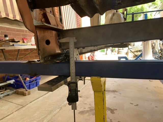

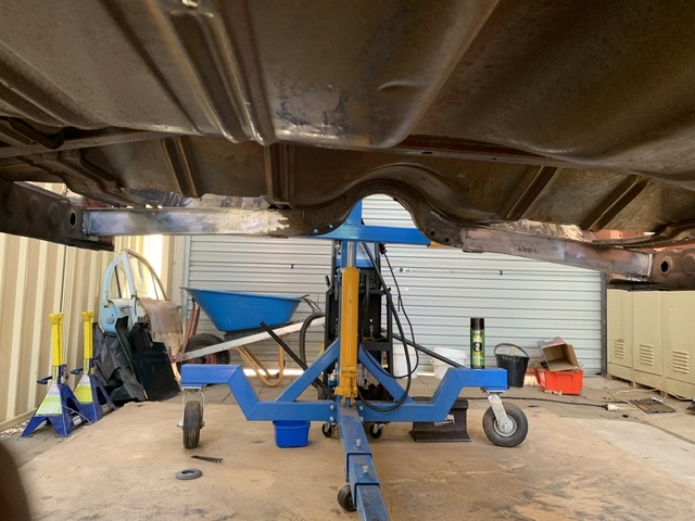

When I cut the foot sections out and then also the chassis sections , I felt the floor ‘pop’
It was on my mind that the floor shape may have moved to a point where I may have had problems fitting the y frames back on.
I staudied the good old FB workshop manual and found some dimensions and then jigged up the body as best as I could to take some measurements.
The off set from design is 820 thou / 21mms.
After an hour of measuring the off set was 780 thou / 20 mms equally each side.
Knowing that 1mm could be gained in the flex of the Y frame legs I was happy to keep stiching it all together

Jeez thought you had folded up inner sills for a minute. Very tidy. Its a familiar story, once you start poking at things what looks ok is often revealed to be held together by scale. When you take some heat to it, it disappears.
Posts: 13819
Re: FB Standard Wagon

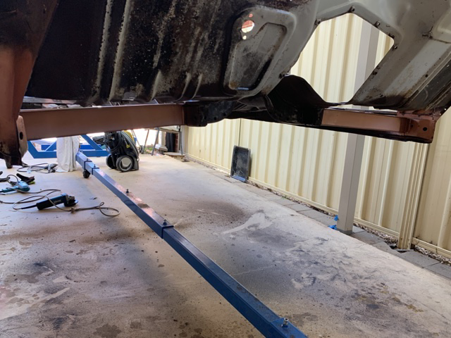

nice work , that will be good for another 60 years easy 8)
arent rotisseries the best thing ever ????

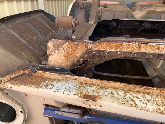

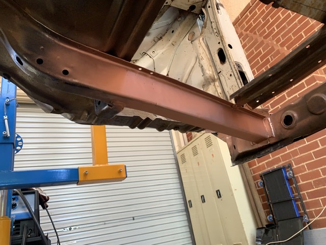

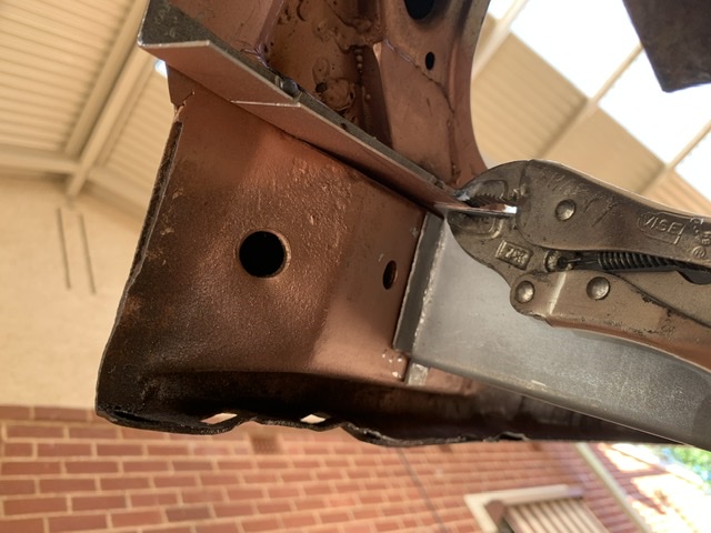

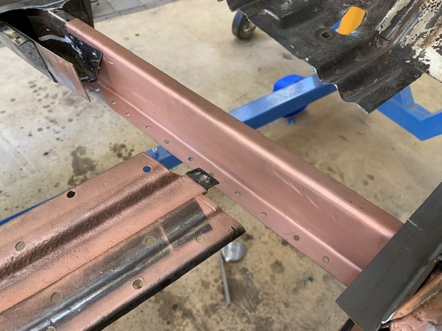

Finished her off this morning.
Fully welded, cleaned up and a coat of primer.
Couple of pin holes in my weld that I tried chasing with more weld but I think it didn’t change the result.
An extra blow over of black paint in that area and nothing will be seen!
What is that old saying? A coat of paint hinds a thousand sins?

Errol62 wrote: Thu Jan 21, 2021 9:38 am Jeez thought you had folded up inner sills for a minute. Very tidy. Its a familiar story, once you start poking at things what looks ok is often revealed to be held together by scale. When you take some heat to it, it disappears.
Most definitely true Clay, every where I look I’m finding pin holes but I’m choosing my battles and just doing what is absolutely necessary.
Rust converter, Penetrol, cavity wax etc etc etc will ensure the rust doesn’t keep developing.
I’ll be happy with that!

Blacky wrote: Thu Jan 21, 2021 10:29 am nice work , that will be good for another 60 years easy 8)
Cheers Geoff!
Yeah mate if it lasts 20/30 years I’ll be happy!
Mate rotisserie’s are the bomb, I have never used one before but the only reason i am making so must progress is because I can flip the car on its head.
Totally saving my back, no dirt in my eyes and no bumping my head!

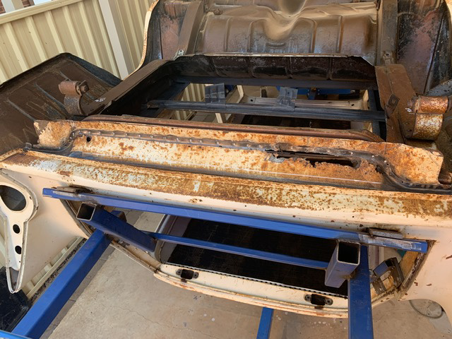

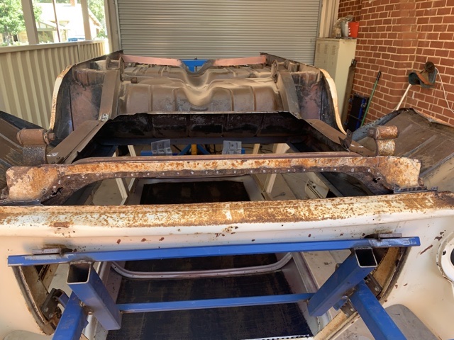

The rust in the rear beaver panel was obvious but as usual when you remove the outer skin there are always a few more sins hiding beneath!
