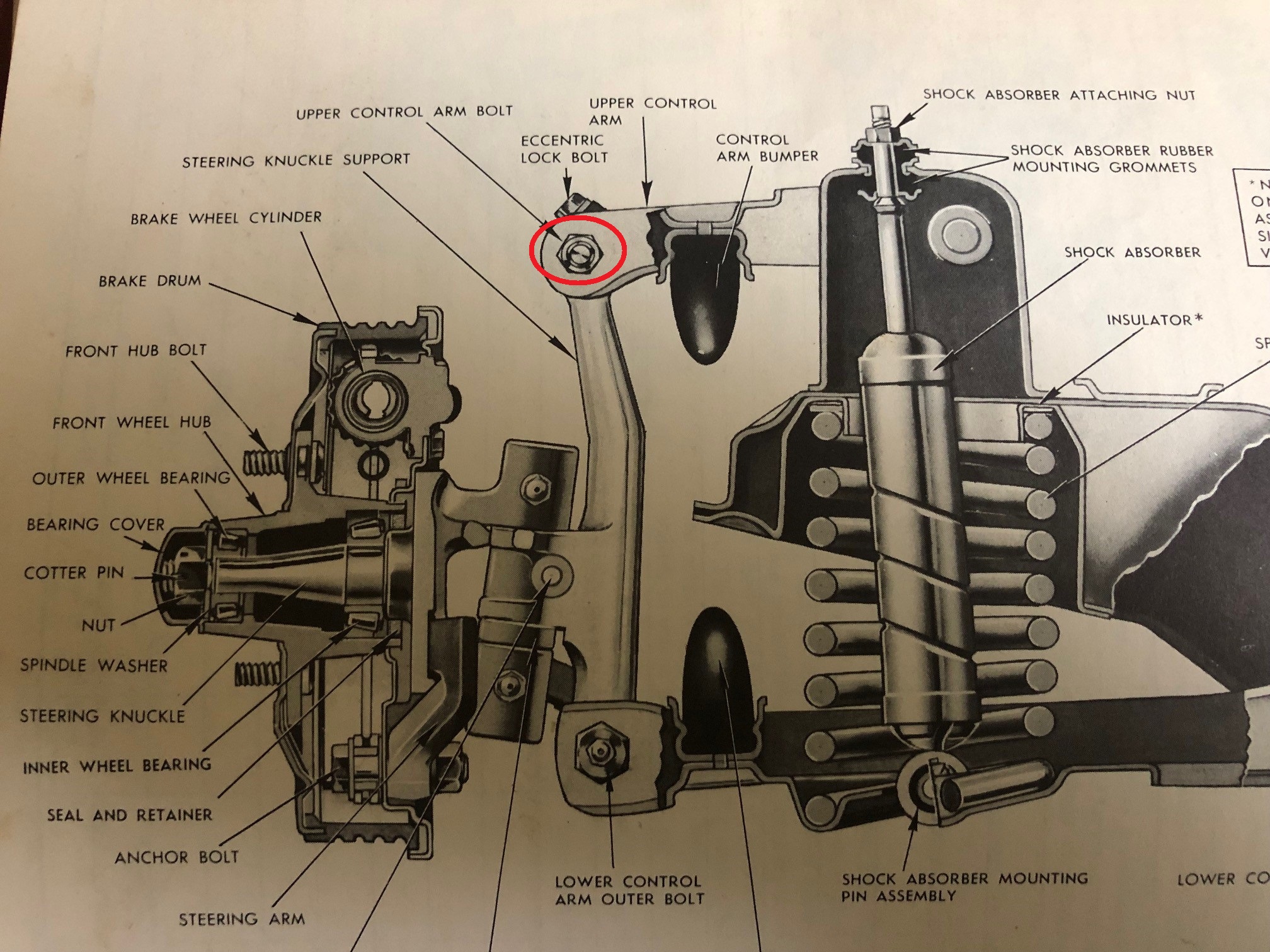

From the test run, the car was rubbing on full right lock (full left lock was fine). Not a small rub either... enough to lock the car up and stop it moving if you were at a standstill. Took a look-see underneath, and the rub is from the passenger's side upper control arm outer grease nipple rubbing on the periphery of the Sampson rim. This nipple is on the front of the control arm.

As Greg says, if the box is not centred you may not be getting full lock on one side, hence not fouling that side. The wheels I sent up also fouled on the front outer end of my kingpin UCA, near the nipple.

Your LH upper outer pivot bolt is in backwards. The grease nipple is supposed to be at the rear.
(I haven't read any further in the thread, but reversing the upper outer pivot bolts my be a start.)
There was such a thing as an HD-king-pin-only upper outer pivot bolt. It will probably take someone like Dr Terry to explain why there's a sui generis HD upper outer pivot bolt and what the differences are, but I'm guessing it'll be to do with wheels fouling at full lock.

Interesting. The EK Workshop Manual has a warning:
Caution: The upper control arm outer bolt must be screwed in from the rear, otherwise the head of the bolt will foul wheel balance weights when steering is on full lock.
That's pretty much what is happening here.
Tomorrow: turn around the upper outer bolts, see how it goes. Remembered too that my pitman arm puller is out on loan... must chase that one now that things are getting more serious in the steering department.
Thanks gentlemen.

Bolt out, turned around, bolt back in. Road test.
