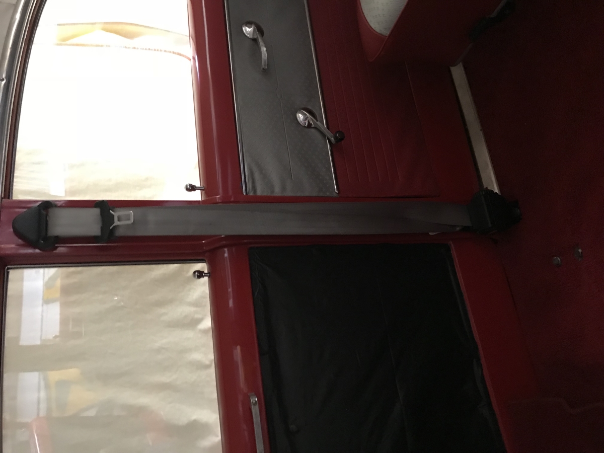

Optimized-Front belt.JPG (487.02 KiB) Viewed 571 times
Optimized-Rear seat.JPG (517.5 KiB) Viewed 571 times

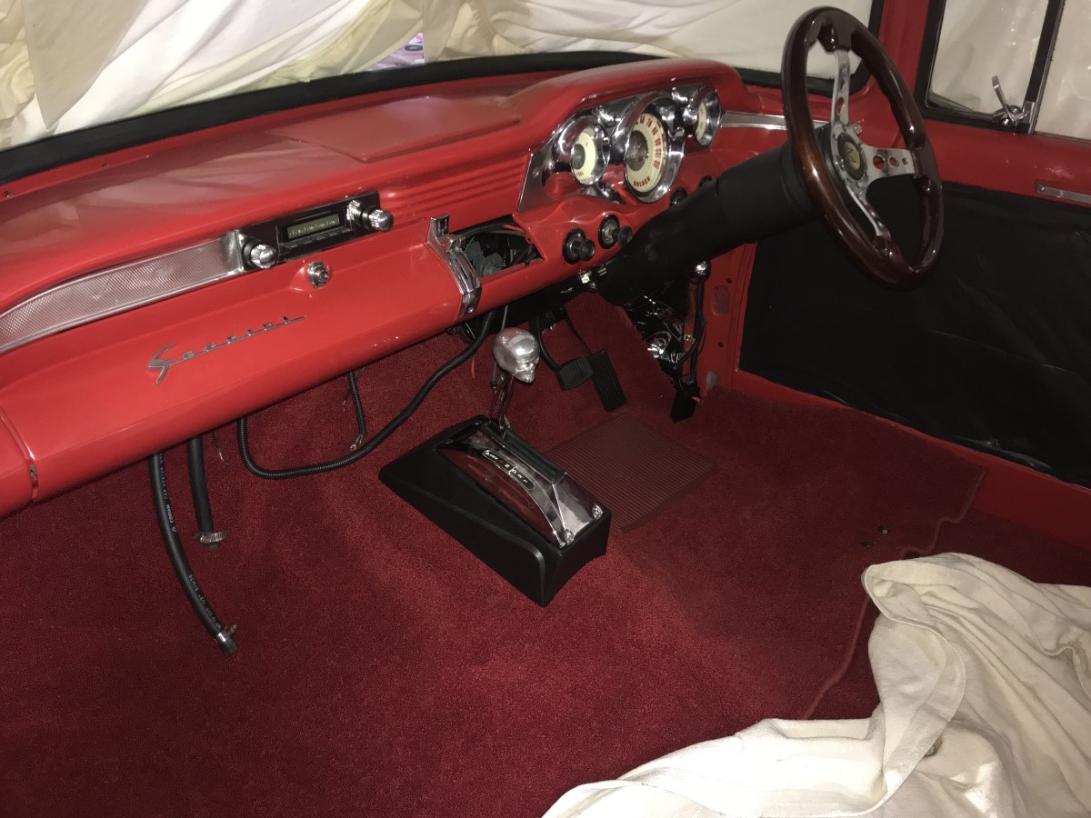

Optimized-Front carpet.JPG (243.93 KiB) Viewed 571 times

What carpet did you use mate, I haven't looked back but assume you used a larger floor hump for the gearbox.
Re: harvs ek 327 wagon
Posted: Wed Oct 03, 2018 10:22 am
The wagon was originally manual, but someone had fitted a huge trans tunnel to it at some stage. I was going to use a CRS trans tunnel for the TH350, but the CRS steel was no larger than the one already there. I reckon I could get an Allison box in it :lol: . I used a Knox carpet for an automatic, and it fit really well - plenty of spare carpet to trim back at the scuffplates. Used a Knox carpet for Grace's ute too - very happy with the quality, fit and service.
Posted: Wed Oct 03, 2018 10:28 am
by FireKraka
Thanks for the reply Harv; so am I right you used a standard ek auto carpet???
Posted: Wed Oct 03, 2018 10:30 am
Yep - standard Knox EK automatic carpet.
