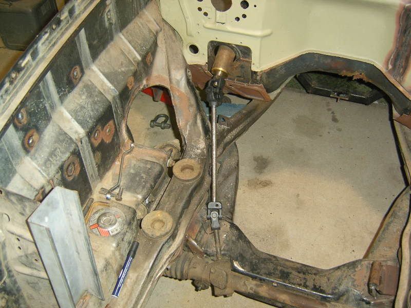

Pulled the motor out again and started the steering. I will finish all the front now before the motor goes back in. I still need to finish the extractors. Will keep the photos coming.

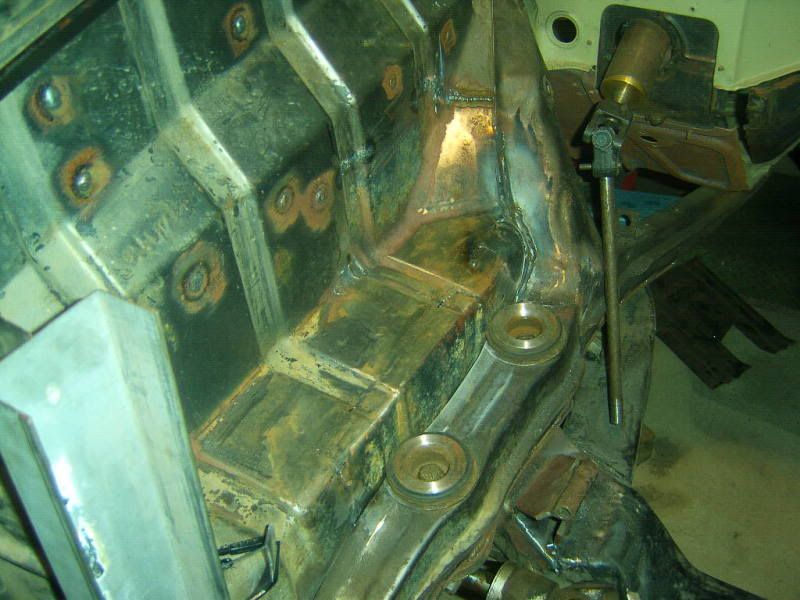

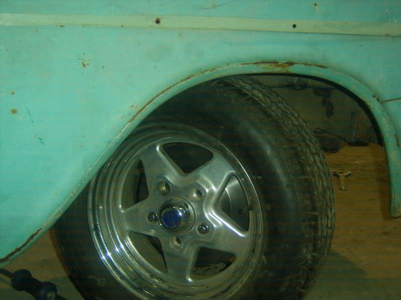

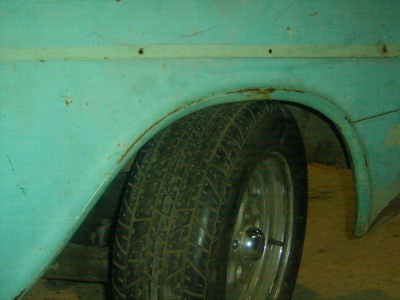

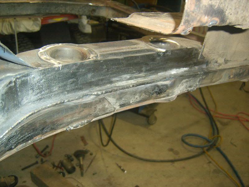

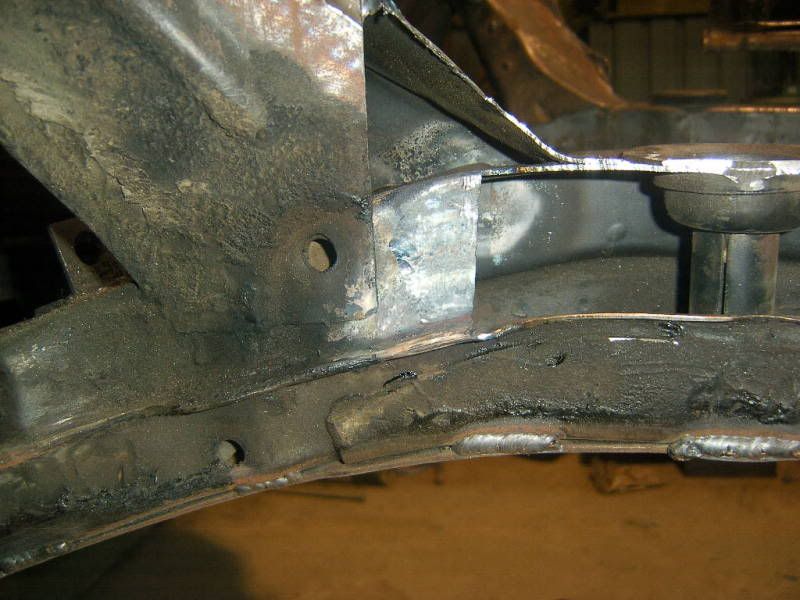

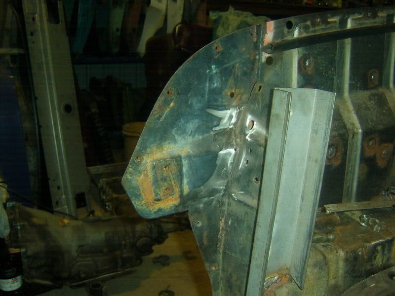

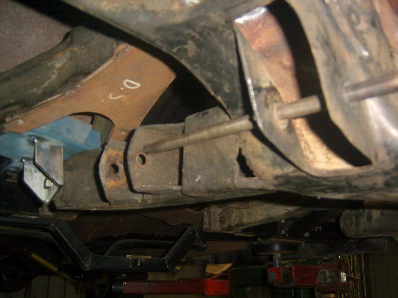

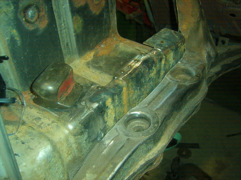

I have decided to keep the Rust repairs as original as possible :evil: :evil: :evil: so that includes where the Torana front end sits. The camber adjustment will take place at the lower wishbones with eccentric bushes, but I have still allowed for the upper wishbone shims just incase I need to race this thing on a circuit, now that would be interesting :shock: :shock:

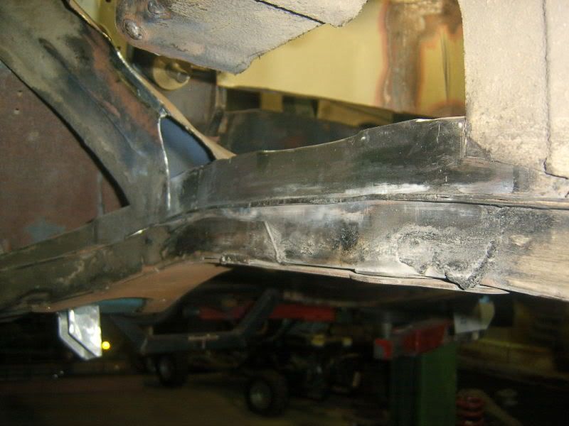

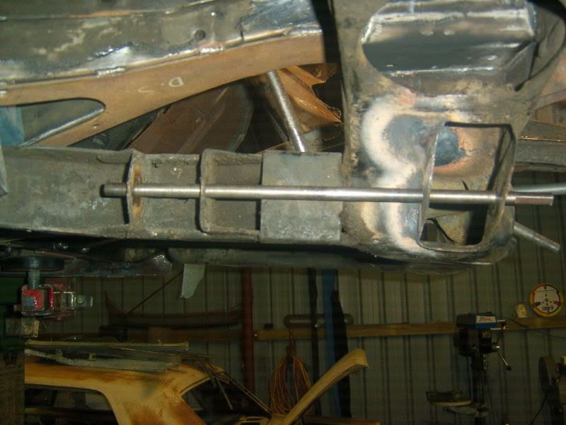

I have cut the rail so the new piece is in one plane and not just notched.
I reworked the inner hidden rail so it sits approx 20mm inward to the original position
New 2mm thick angle shaped and welded in.
Gain is very noticable.
Welding in the missing bits.
This has taken me ages and is quite a lot of work but like I said should look the goods and will not interfere with the original look, well hope so anyway.

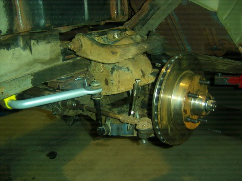

Update lads

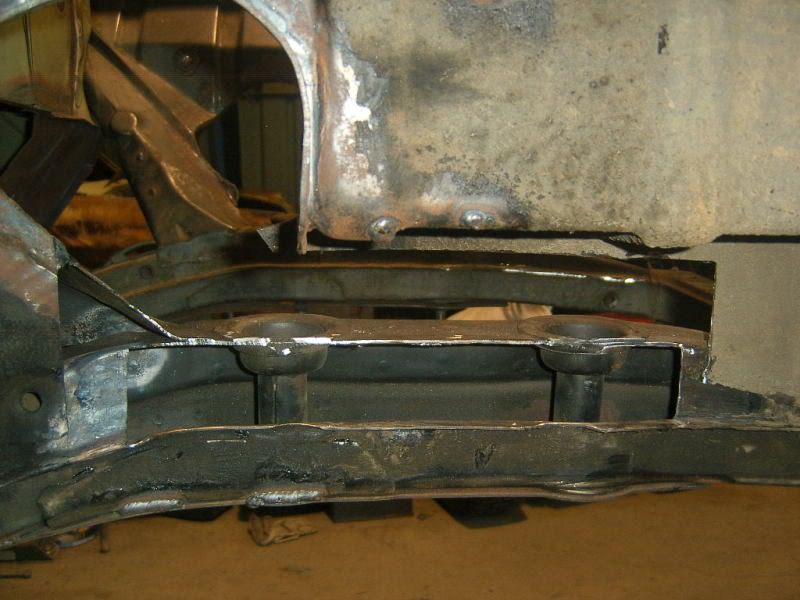

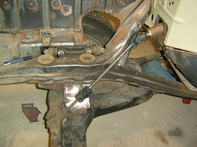

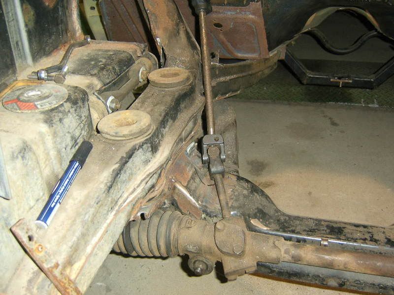

Finished one side of the inner guard replacement,
Front end fits in snug

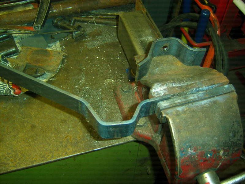

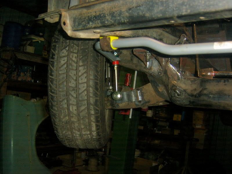

Made up some sway bar brackets because the bar is on the front in the original EK position. The Torana location is just to hard with the extractors i am still yet to complete.
Will get some more done this weekend I hope.

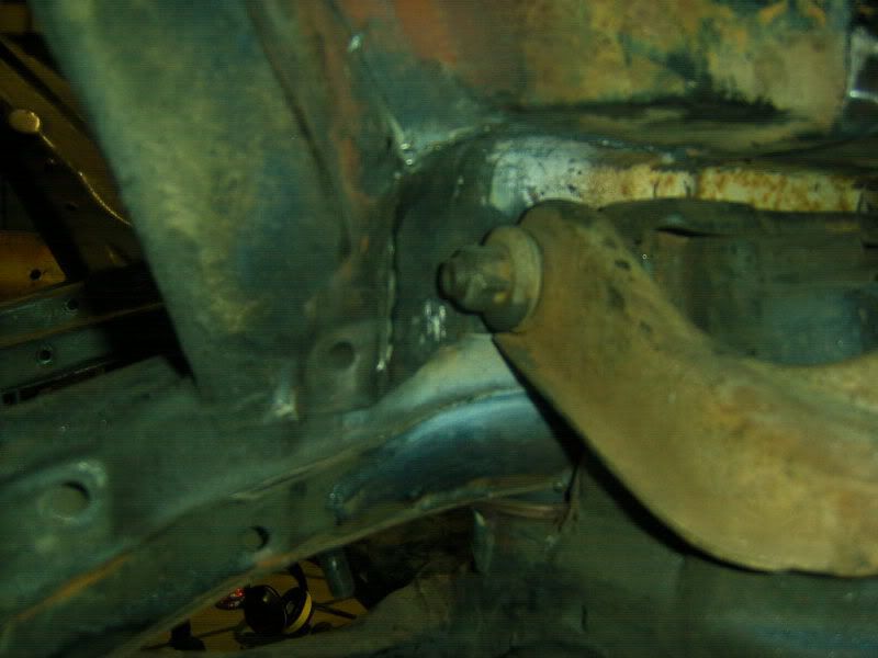

Posts: 2710
Re: Chev EK

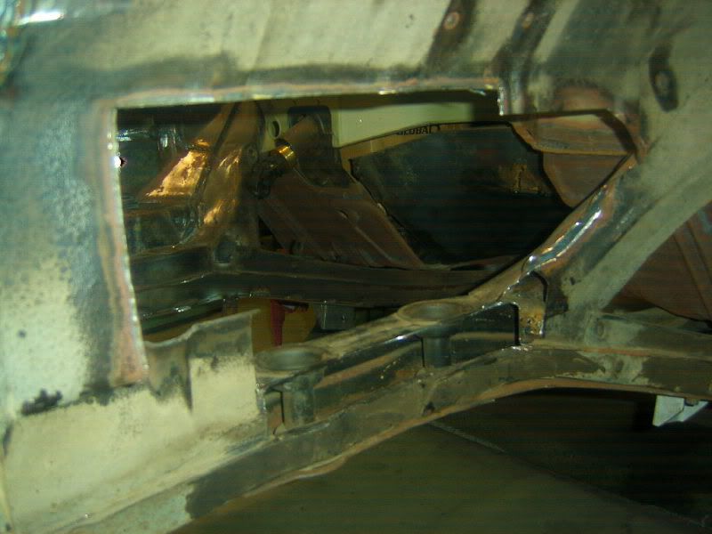

Done some today, repaired the geometry of the front end, looks like I ended up with a flogged Torrie but all is good again. :evil: :evil: :evil:
Spent a few hours heating cooling and heating again eventually got the front control arm supports back to where god intended.
Not much room left with the guards so a lip removal and pump will be required.

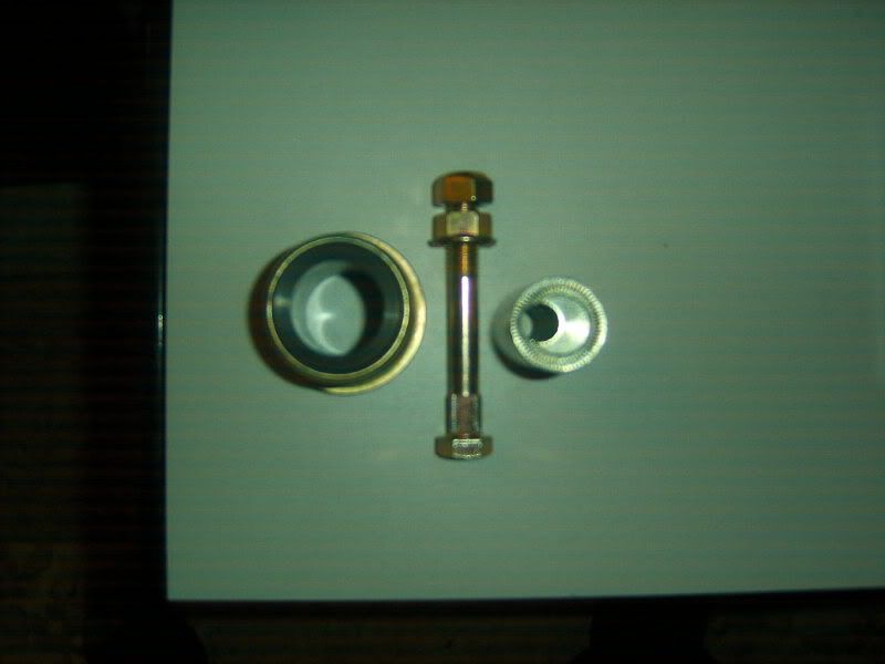

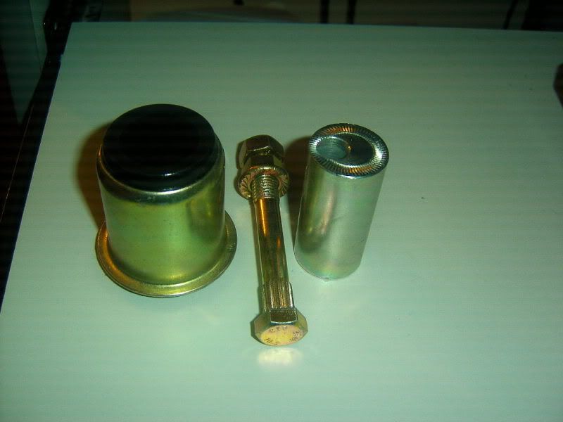

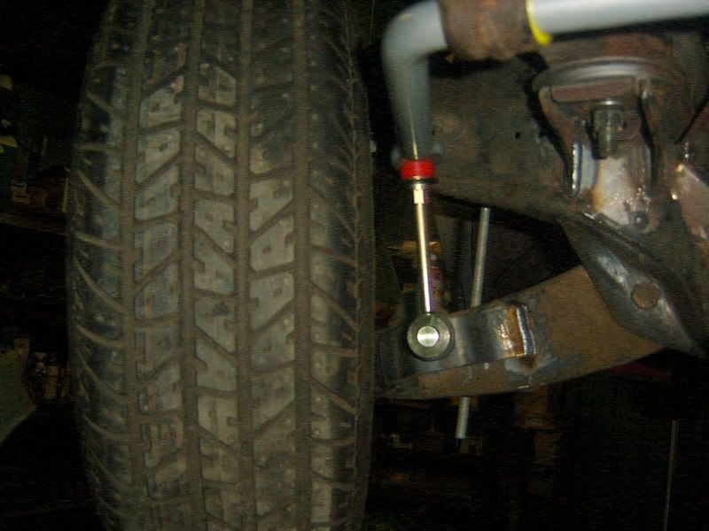

Not much done today,
Finished off the swaybar.

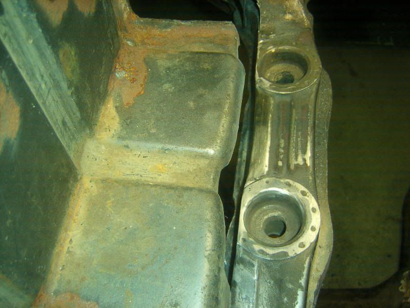

These are the bushes Im going to use on the lower control arms for the camber/caster adjustment.

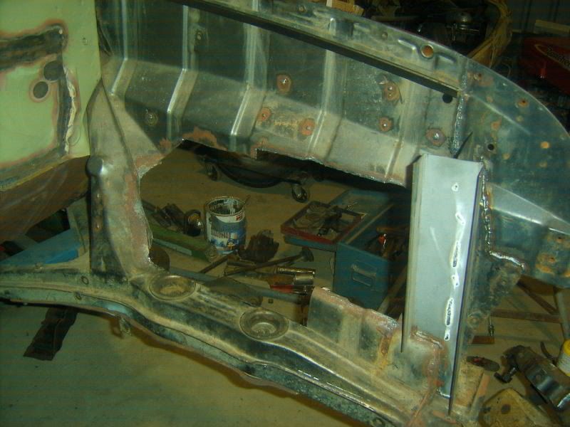

Posts: 2710
Re: Chev EK
Geeze Im at the point of no return with this subframe, probably would have been quicker to find a better one !!!!!!
Cut out the front end pieces and replaced them, they were bent and the threads stripped out.
Also cut out the bodged battery repair that I done years ago, I can weld better these days.
Passenger side now ready for the Torana treatment.
