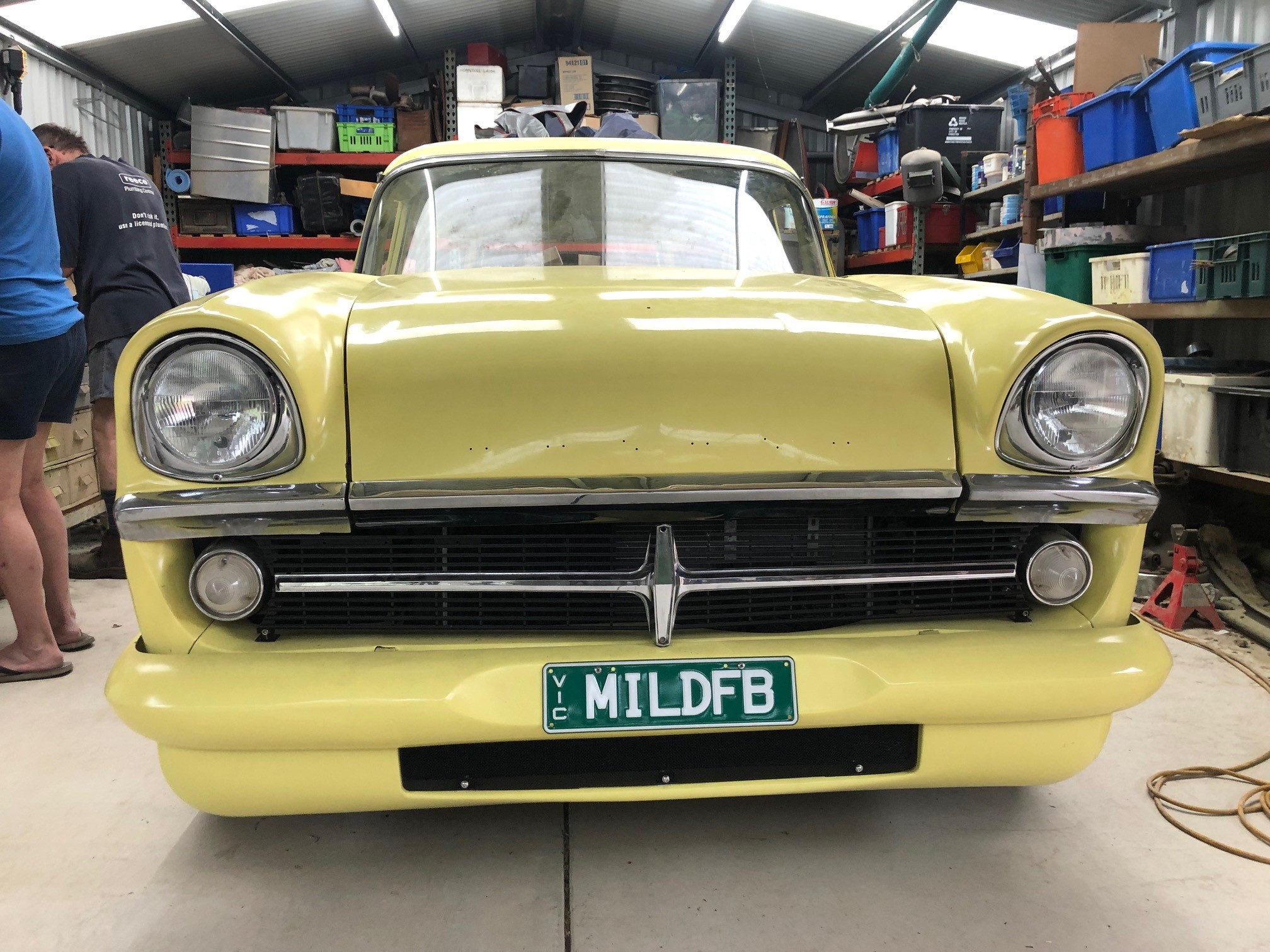

mildfb front
mildfb front
dec 21 b.jpg (626.08 KiB) Viewed 6404 times
mildfb rear
mildfb rear
dec 21 a.jpg (578.82 KiB) Viewed 6404 times

Hello all. It has been a long time between reports, we are ready for the visit to the engineer early next year. We have a pre inspection list to work through, we think it's OK but depends on the engineer how we progress from here. Chrysler 360 runs sweetly and the torqueflite gearbox has been overhauled. We had a bit of fun with badges, bringing a bit of Chrysler bling. The chassis is so stiff, that when we jacked up the front corner we cracked the windscreen. Needs replacing, the upside is that it is still a standard windscreen. 8)

I was only thinking about this build a week or 2 ago wondering if it ever got finished- looks great mate well done 👍👍

Thanks for the update. I love the approach you’ve taken to this thing. Not having to get a custom front screen particularly, not to mention the mopar theme.
Re: MildFB, customised FB wagon
Posted: Thu Nov 30, 2023 3:54 pm
The wedge is definitely different. Love it 8)
